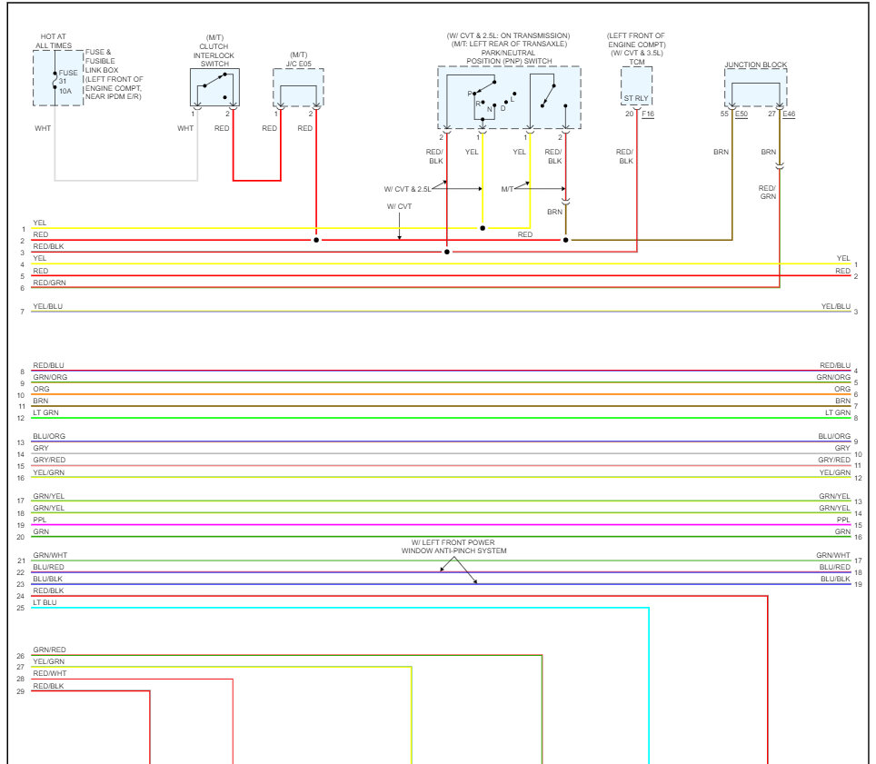

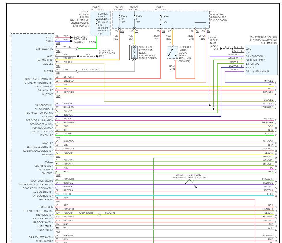

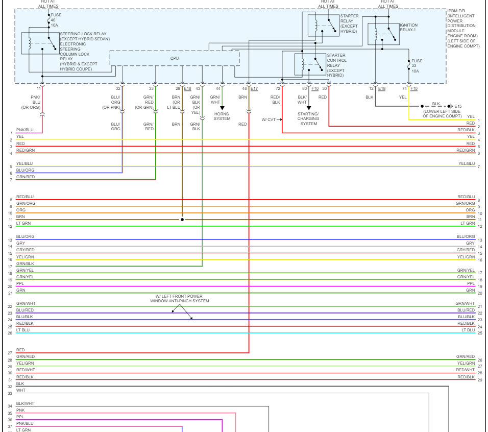

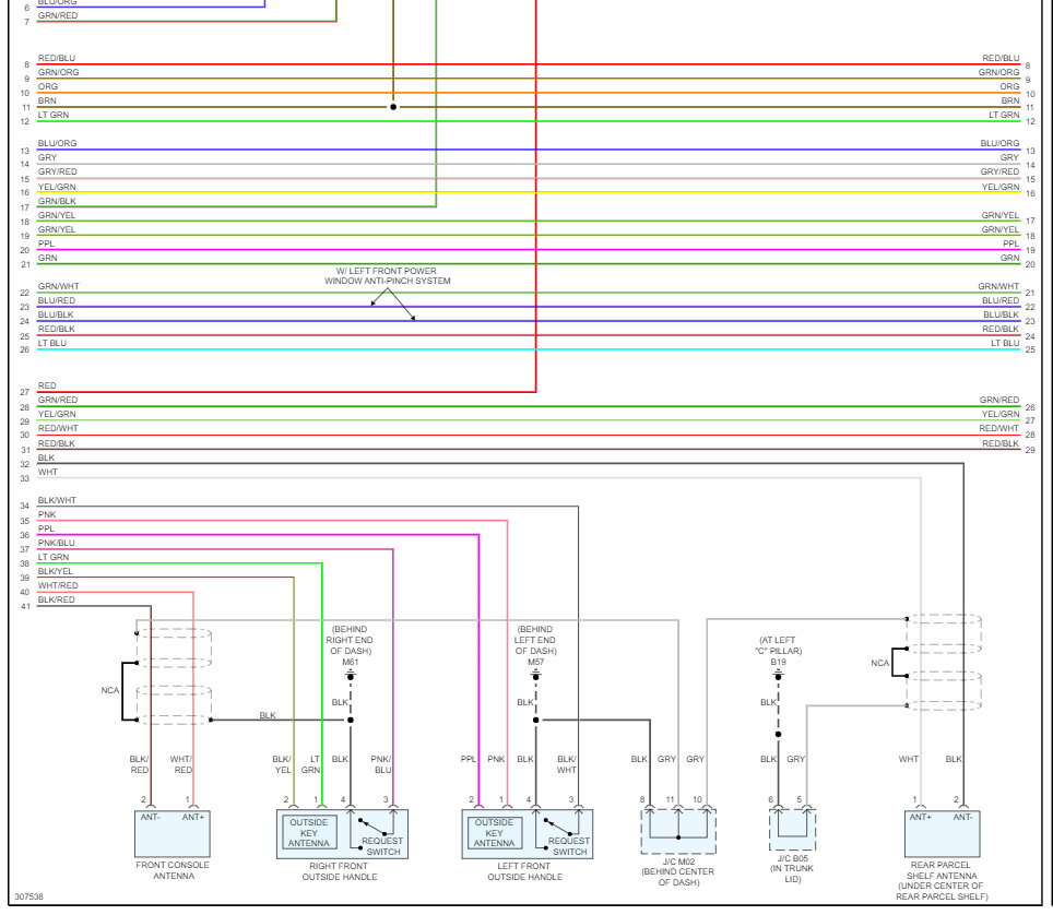

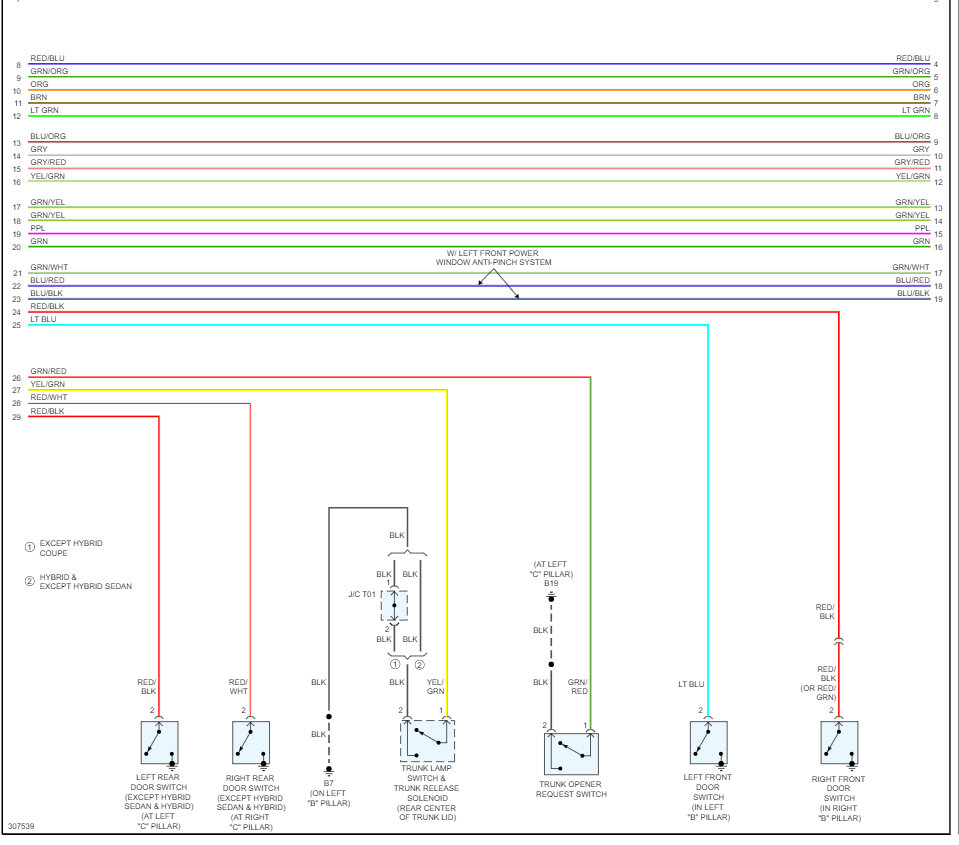

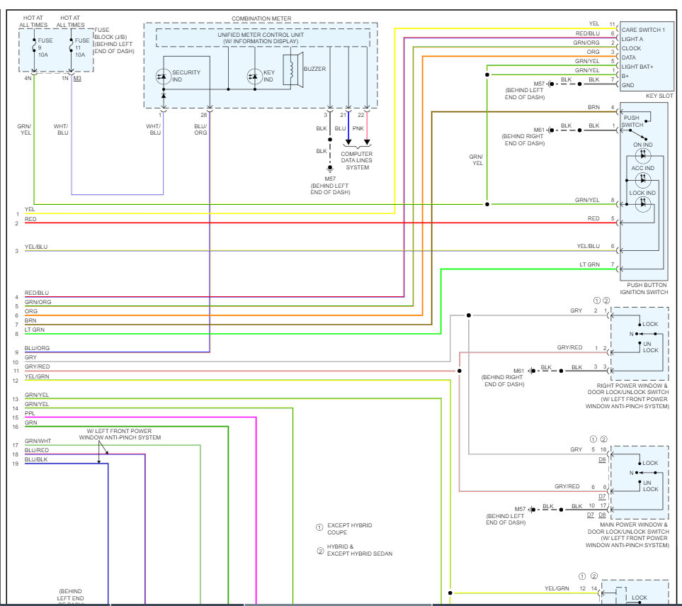

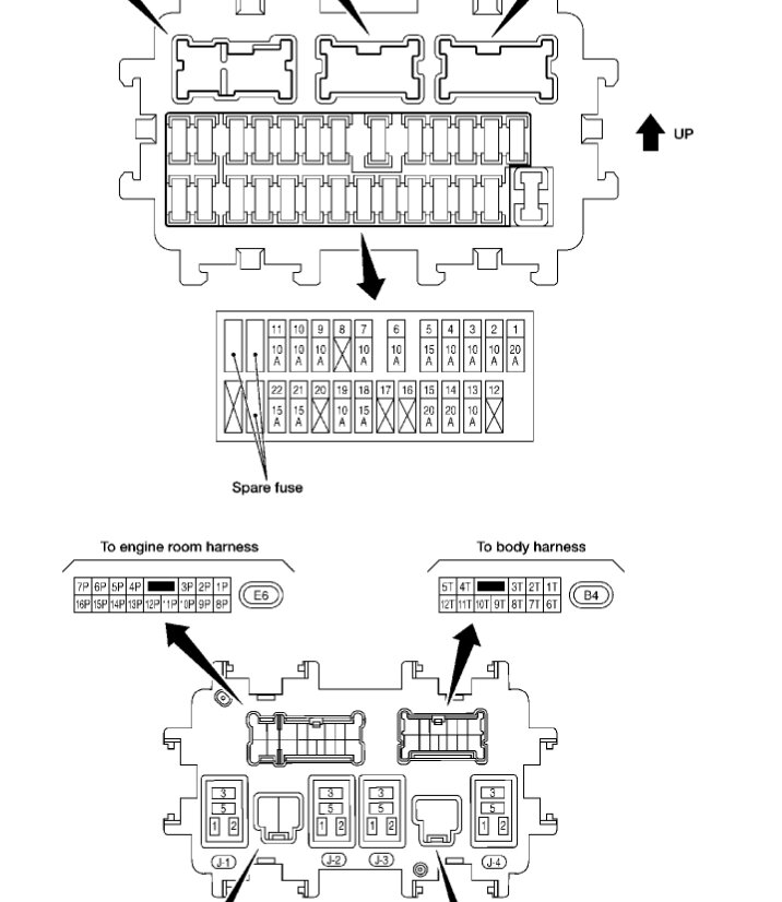

Only driver rear door unlocks with intelligent key And door lock Button.
May 20, 2023 at 7:09 AM
  • 55,423 POSTS

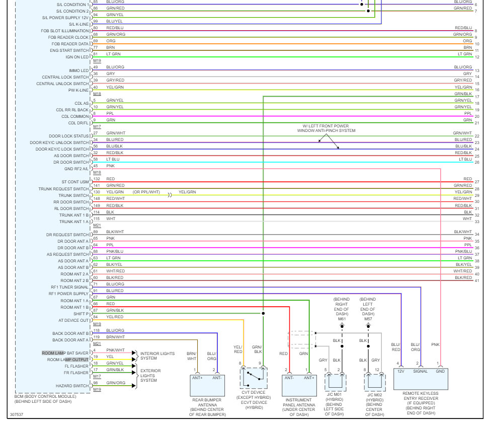

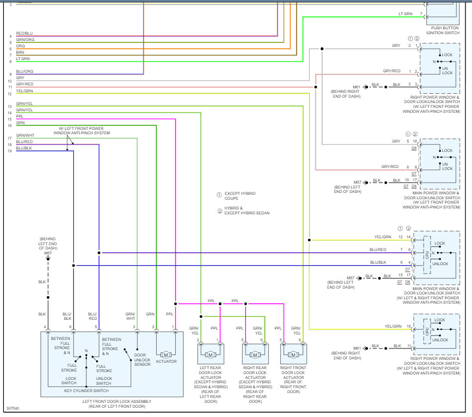

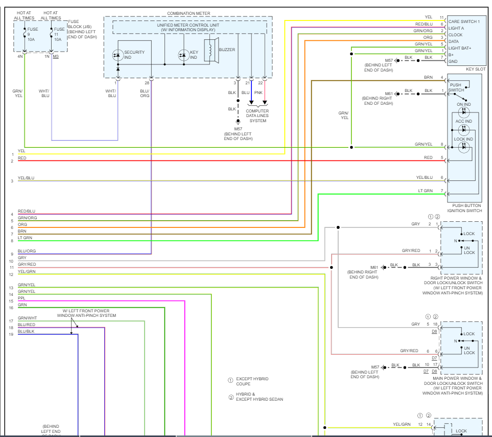

The fuses for the door locks are #10, 6 and 7 in the fuse panel at the left side of the dash. Here is a guide and the location of the fuses along with the door lock wiring diagrams so you can see how the system works:
Check out the images (below). Please let us know what happens. You may have a IPDM going out.
