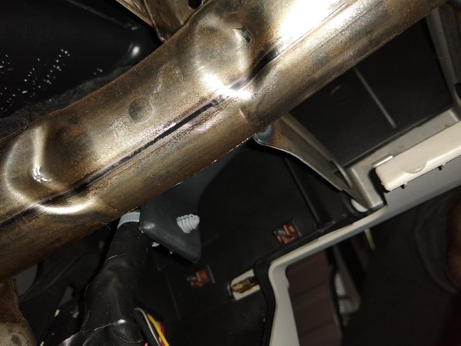

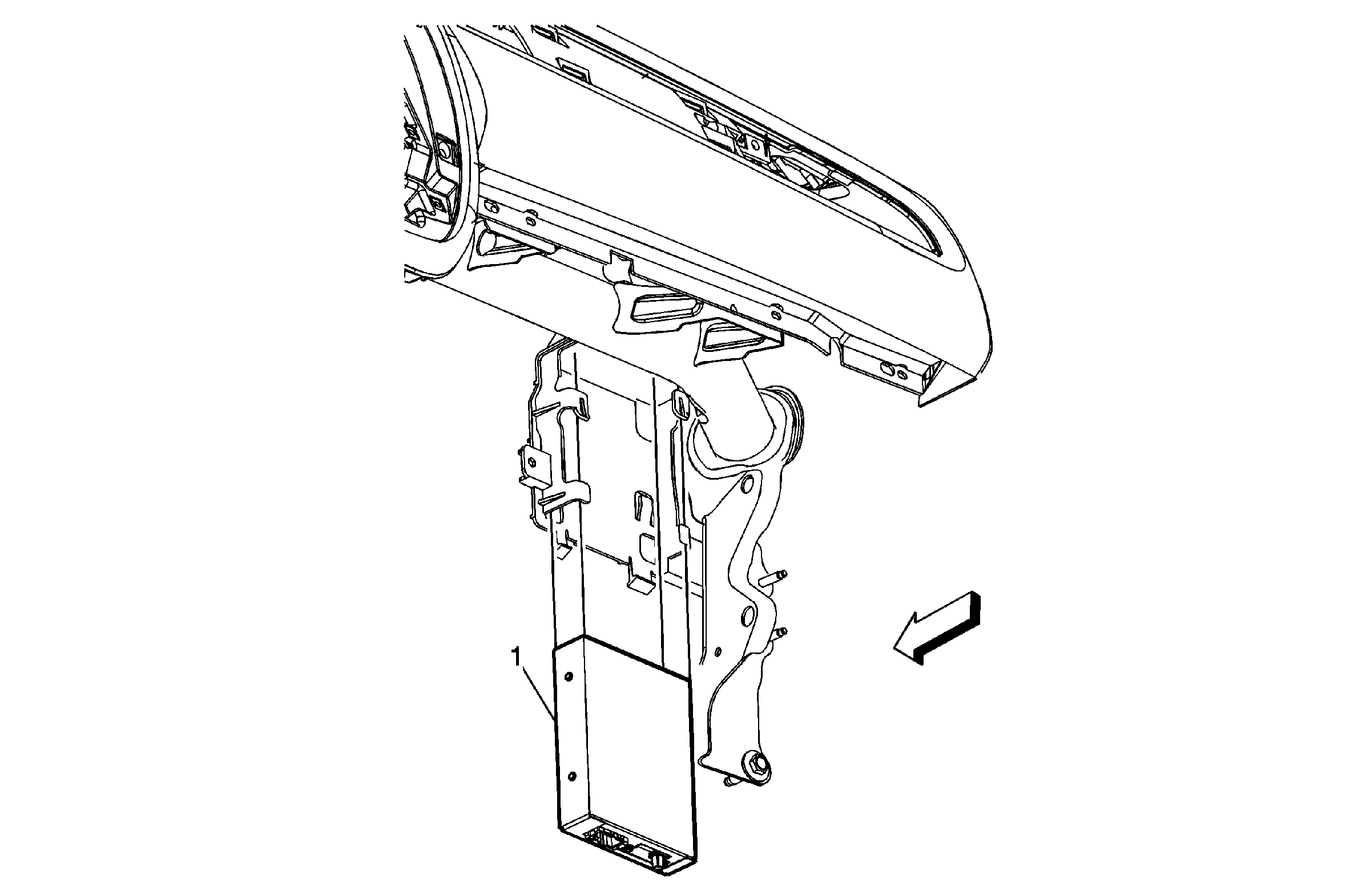

I'm adding a BTS-GM1X Bluetooth Streaming Interface to my vehicle XLT model. To do so, I need to hook it into the Digital Radio Receiver. The instructions I received from Crutchfield and the images I was able to find from the Chevrolet service manual both indicate that the receiver should be directly behind the glove box. Unfortunately, it is not. I've fished around all inside the cavity behind the glove box without any luck. Does anyone with more experience than me know where I can find this?

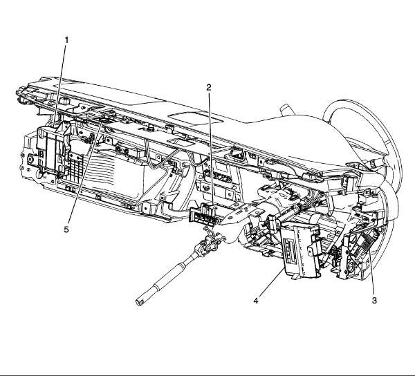

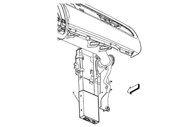

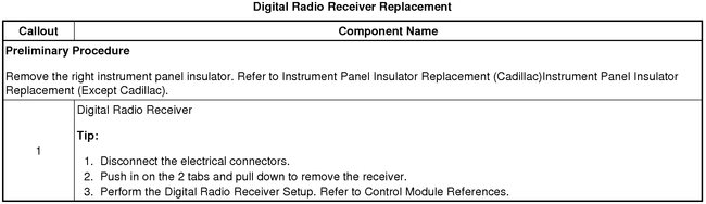

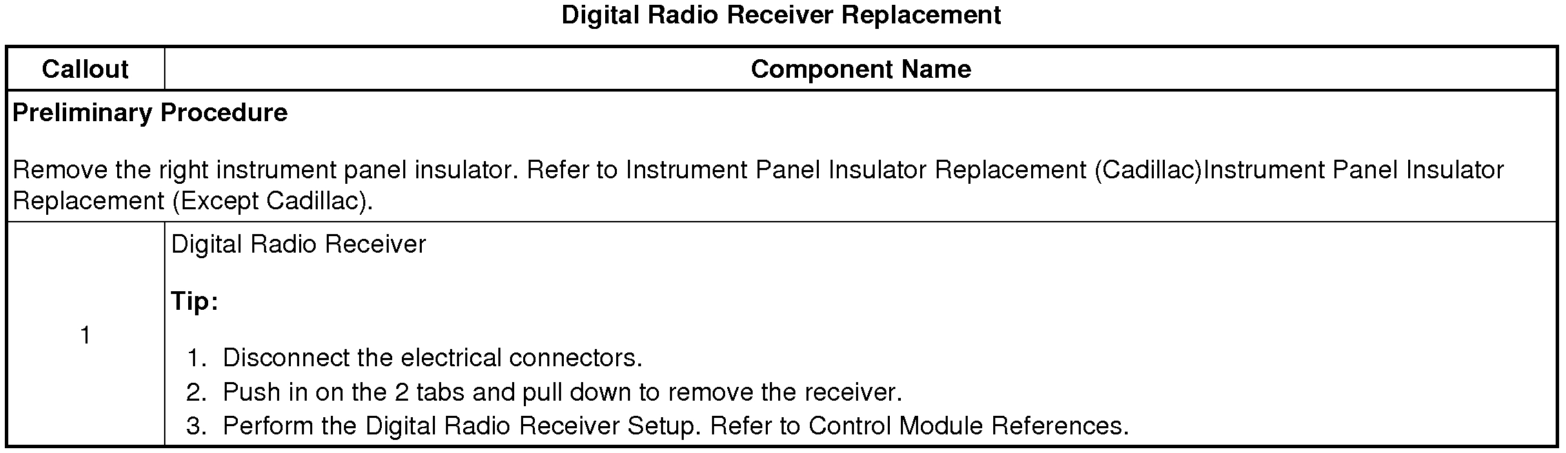

I checked my manual and it indicates it is behind the right side of the dash. It will pull down. It may be behind what I see in your picture.
I attached what I have, let me know if it helps.

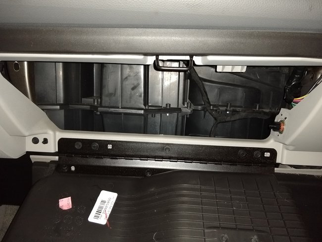

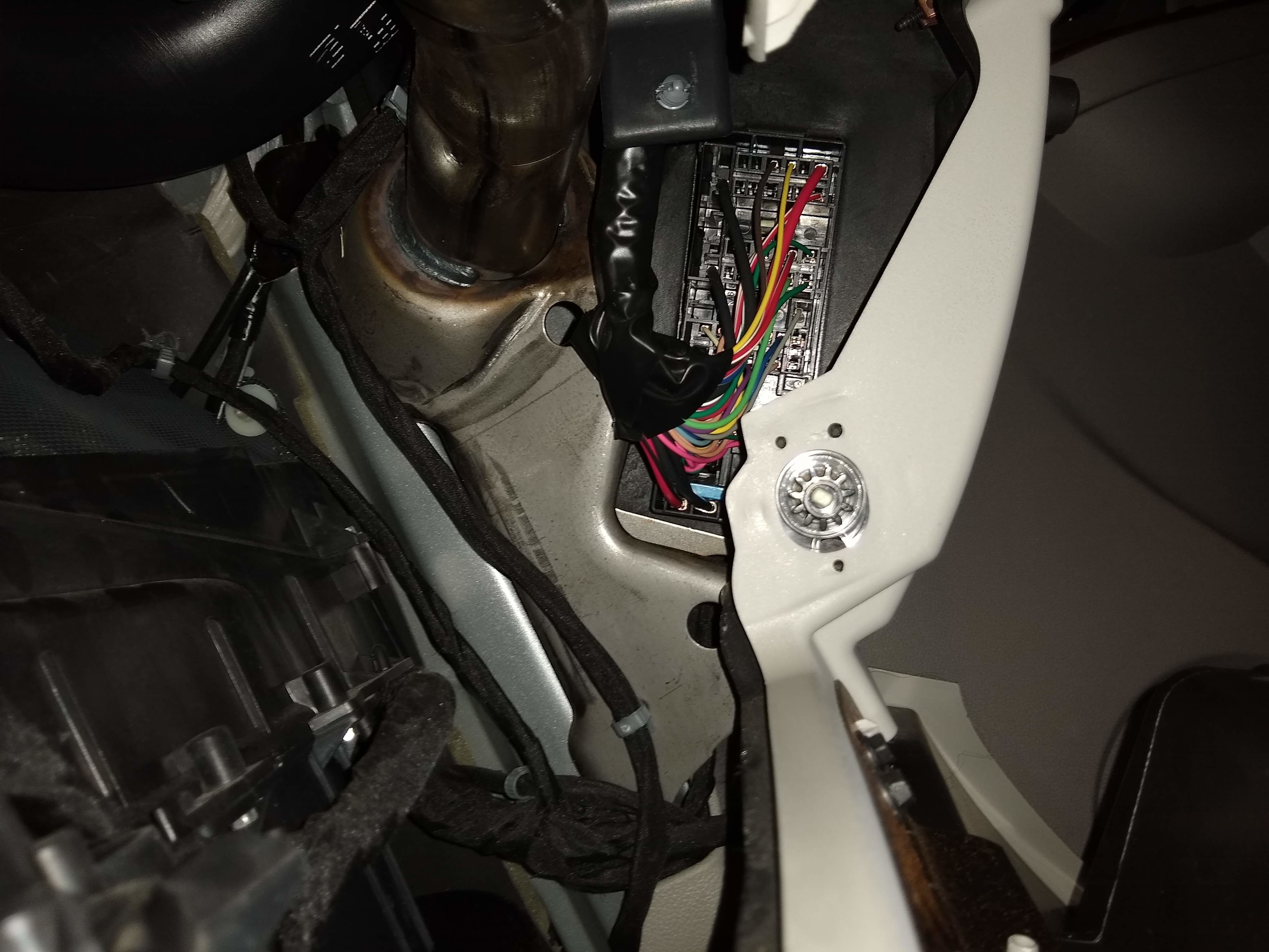

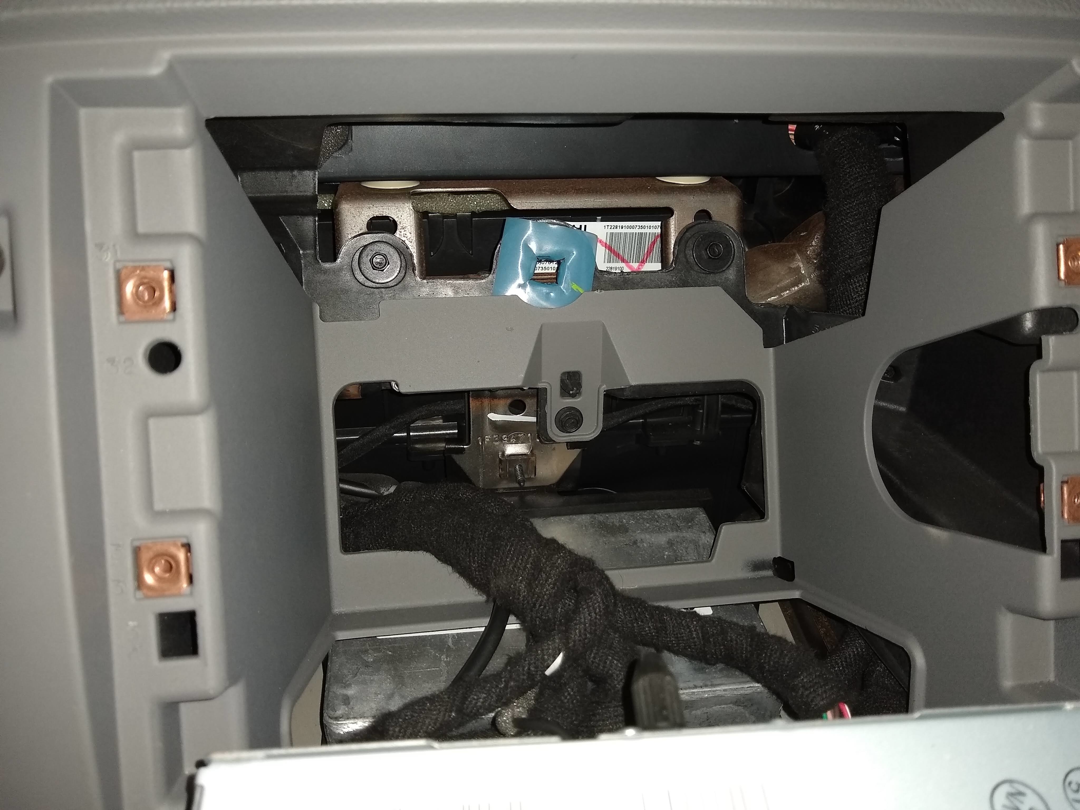

I've dug around inside the glove box compartment without any luck. I pulled off the head unit and some other trim pieces and can't find anything like what is described in the instructions.

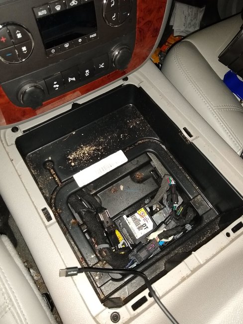

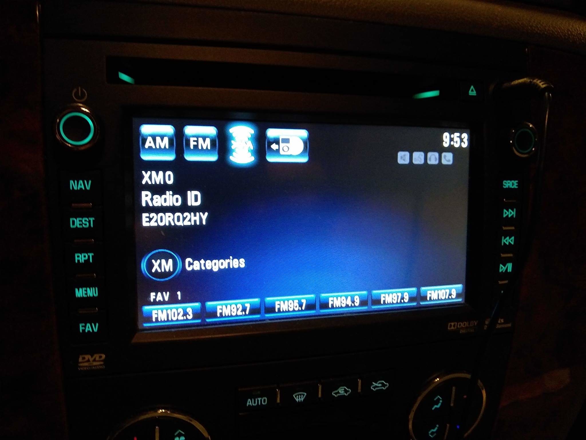

I'd never really used the XM radio before, but I was pretty sure I had it and a buddy of mine had the same thought, so he had me check that too. Snapped a photo of the XM tuner on channel 0 and it spits back a Tuner ID. So it is there in the truck. But the whereabouts remains a mystery.

Hi. Chris, did you ever locate your XM radio? I have the same vehicle and trim as you, and am facing the same problem. Even though I have current, working XM service, when I look behind my glove box I don't see the radio unit at all. There are a few wiring bundles but none look like what's pictured in the BTS-GM1X instructions. Any help would be greatly appreciated!
