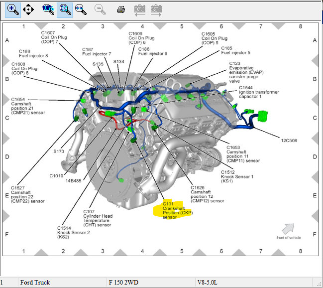

code P2107, location of crank sensor needed

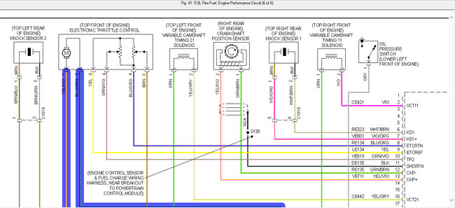

Truck started cranking longer to start, then just cranked. Fuses are good, put in new fuel pump, fuel drive module, new throttle body and throttle positioning sensor, giving 2 codes P2107, and the other was a thermostat replacement, which it was doing before it quit running. I'm looking at the crank sensor cause I don't know what else to try.

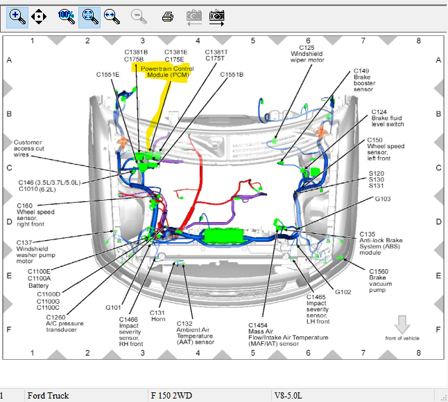

Crank sensor location is at the rear of the engine passenger side check fig(8).but you don't have fault code related to crank sensor.

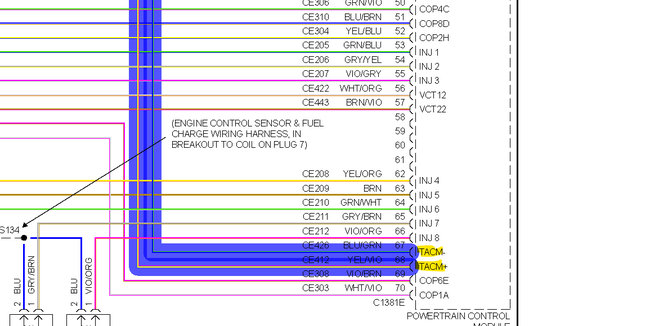

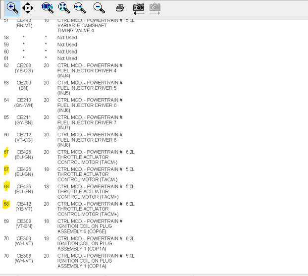

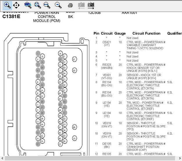

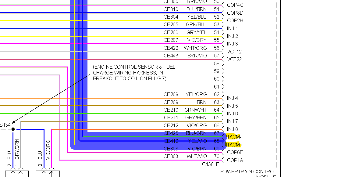

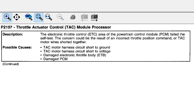

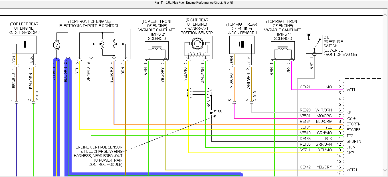

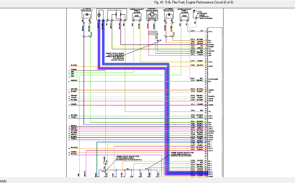

Refer to fault code p2107 check fig (1)as a first step wiring between throttle body and engine control unit must be checked for short to B+ and B-. throttle body is already replaced as you mentioned. visually check throttle valve connector if wires overheated or sticked to each other, check for any sign of corrosion. check fig2,3,4 for wiring between throttle and engine control unit.

As the wiring diagram check for resistance and short circuit, check the wire between throttle valve connector pin 1 to engine control unit pin 68.and pin2 of throttle valve and engine control unit pin 67.

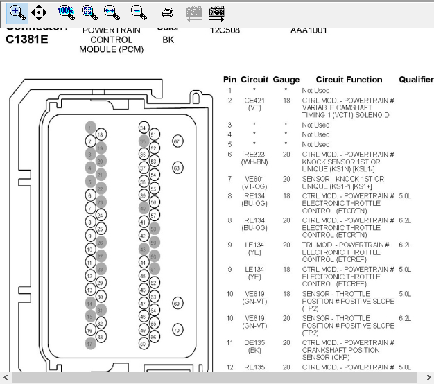

Fig 5 and fig 6 is the engine control unit connector and how it looks like, fig 7 is the location of the engine control unit.

To be at the safe i need you to check the voltage at throttle valve connector between pin 5 and pin 4 you must get about 5 volts ignition on.
also check the resistance of the other wires between throttle valve and engine control unit.
throttle pin5 to cupin9.
throttle pin 6 to cu pin 10.
throttle pin 4 to cu pin 8.
throttle pin 3 to cu pin 34.
if all the wires are good, throttle valve was already replaced then it seems engine control unit defected.
