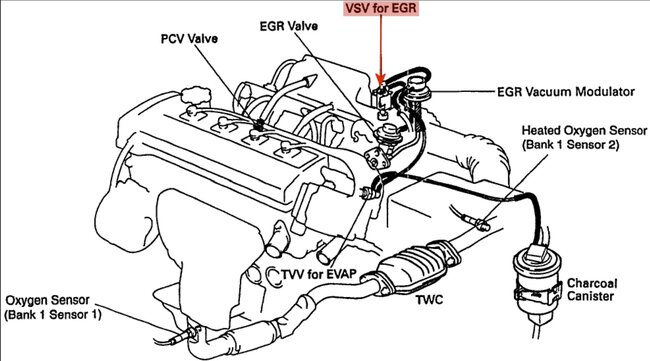

Hi everyone, need help locating Exhaust Gas Recirculation Vacuum Delay Valve.
Part Number: 9091012220 on a 2001 Toyota Celica GT-S 2ZZ-GE 6sp MT T23. Thank you!
Feb 12, 2023 at 1:24 PM
BRENDON S
  • 653 POSTS

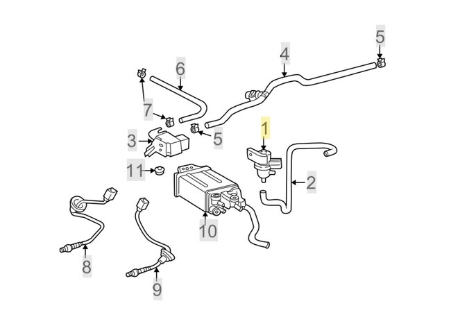

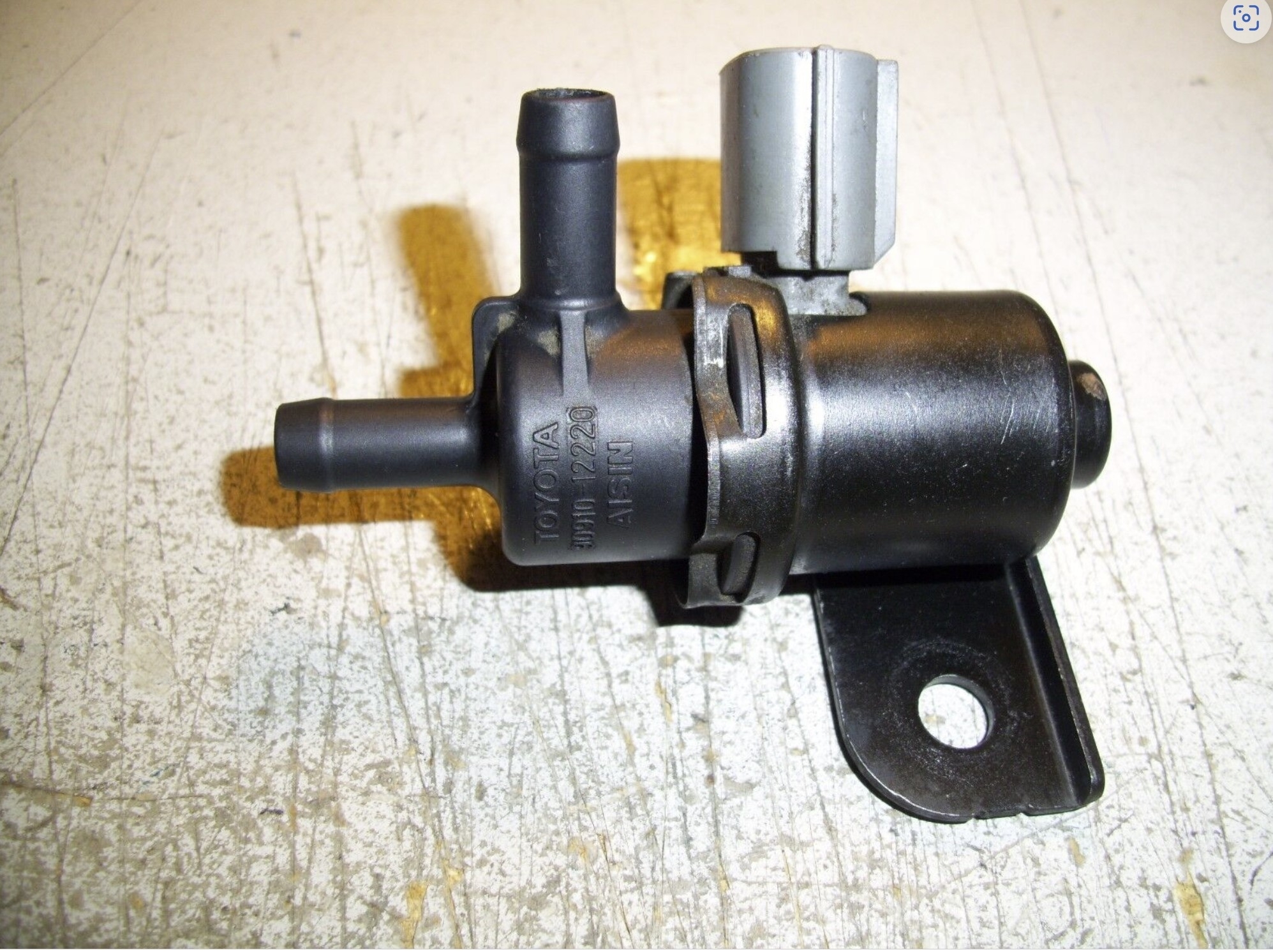

I found you some information:
The Toyota part number is: 9091012220 Exhaust Gas Recirculation (EGR) Vacuum Delay Valve
I have added some pictures below to help you locate it.
Looks like it is behind the EGR on the top of the motor. It should have the part number stamped on it if the original is still there.
