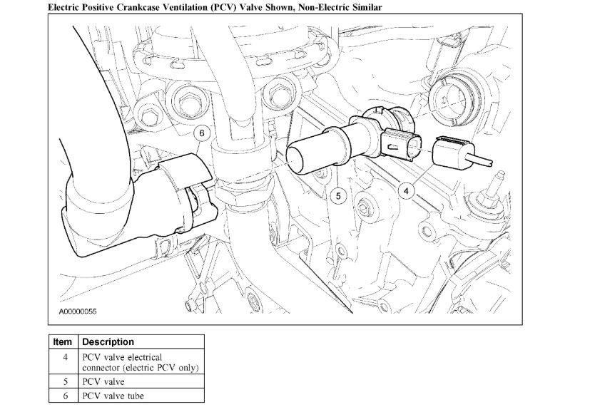

Engine started missing out finally quit running. I got it to start after it cooled off. i noticed the oil fill cap seemed loose. i started to loosen it and the cap blew off in my hand. seems to be a lot of pressure in crankcase. mechanic suggested PCV valve bad.

I doubt it is the PCV. To have that much pressure suggests something else in the motor. It could be a bad piston.
Does the engine run bad?
Is the check engine light on?
The procedure is below with some pictures for you to view.
Removal and Installation

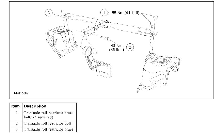

1. Remove the 4 transaxle roll restrictor brace bolts.
- To install, clean the bolts using a wire brush, apply new threadlocker to the threads and tighten to 55 Nm (41 lb-ft).
2. Remove the bolt and the transaxle roll restrictor brace.
- To install, clean the bolts using a wire brush, apply new threadlocker to the threads and tighten to 48 Nm (35 lb-ft).
3. Disconnect the positive crankcase ventilation (PCV) valve tube from the PCV valve.
4. If equipped, disconnect the PCV valve electrical connector.
5. CAUTION: A new PCV valve must be installed if removed from the cam cover. Damage will occur to the locking mechanism on the PCV valve.
Rotate the PCV valve counterclockwise to remove from the valve cover.
6. To install, reverse the removal procedure.
