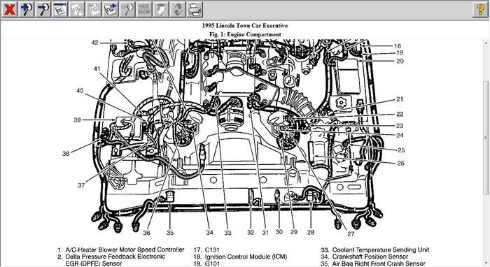

Inspect and test the crankshaft position sensor. On right front of engine, near right ignition coil.
+1
