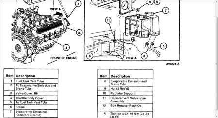

when vehicle is moving there is a strong gas odor
more so when 1 window is put down or ac is placed on max fan high
i have checked the fuel lines and tank - short of pulling them out all looks ok with no indication of leaking
a friend suggested the vapor recovery may have some sort of canister with with pellets/???
that may not be venting/filtering properly?
does my vehicle have something like this?
if so where might it be - physical location

Hi southwick, Welcome to 2carpros and TY for the donation It has a charcoal canister see no.7 below
https://images.2carpros.com/forum/automotive_pictures/12900_charcoal_canister_1.jpg

where is the canister physically located???? in the trunk???
Jun 12, 2010 at 11:10 PM
  • 75,992 POSTS
Its on front of the engine compartment on the frame
REMOVAL
Raise vehicle on hoist. Use proper vehicle lifting procedures.
Remove bolts retaining evaporative emission canister.
Partially lower evaporative emissions canister and disconnect evaporative emission and brake tube from cannister.
INSTALLATION
Follow removal procedure in reverse order.
Tighten nuts to 34-46 Nm (25-33 lb ft).
Perform system leak check as follows:
Disconnect and plug fuel tank filler pipe shield leading to the evaporative emissions canister at the evaporative emission canister purge valve.
Plug vent at the evaporative emissions canister.
Using Rotunda Leak Tester 134-00003 or equivalent, pressurize the fuel system through the test fuel tank filler cap.
Verify that the pressure within the system does not decay.
If pressure does decay, determine the cause of the leak and repair.
Remove plugs and reconnect fuel tank filler pipe shield to the evaporative emission canister purge valve.
