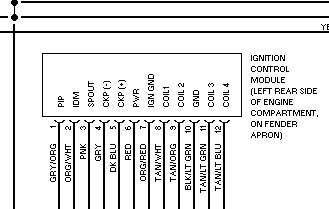

At the coils you should have power at the tan/white, tan/orange, tan/lt green, tan/lt blue. All of those are powers come out of the ignition conntrol module. Be sure the red wire at the ICM has power. If not see if the PCM power relay is clicking on when key is cycled on

The red wire has power at the ICM and the PCM relay clicks when you turn the ignition on. According to the test procedure the center terminal at the coil connector should have power with the key on but it does not nor does any of the wires to the coil.

Acording to mitchell itis the wires I mentioned before.Here is a pic of the ICM so you can be sure it is grounding as well (Ign Gnd).

Finally got her to run today.
Since I did not disassemble the left bank V/C and undo the big 42 pin connector under the brake booster. I did not know that it was held tight by the bolt in the center. I had just plugged it back in as I would any connector.
As soon as I bolted it in I checked for power to the coil. It was present and then it started. :-)
So it was a combination of things to actually get her running again. Either their was corrosion on the CSS or the sensor was bad causing it to die initially. Since I replaced it as it was the most common issue with shut off and not start I don't know if it was just the connector or other. The OHM resistance on both the old and new are similar so there is no way to know unless I put the old one in. Not something I am going to do since you have to unbolt the A/C compressor to remove it.
