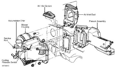

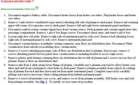

What do I have to go through to remove and replace my heater core. It looks like I have to go at it from under the dash, and or remove parts of the dash? Can you help me in the best or only way to tackle this?
Thanks, Craig
Wednesday, March 26th, 2008 AT 5:37 PM
SERVICE WRITER
  • 9,123 POSTS
ITs about a 6-8 job for a pro to do, by book time...which is usually underestimated.
https://www.2carpros.com/forum/automotive_pictures/30961_xcoretc_1.jpg
https://www.2carpros.com/forum/automotive_pictures/30961_xcoretcd_1.jpg
It comes off from the inside.

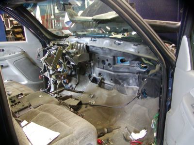

No to be discouraging, but this was a chevy truck we did a few weeks back'
