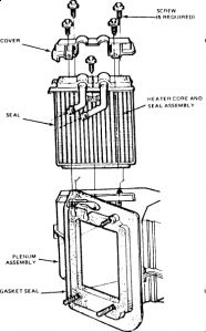

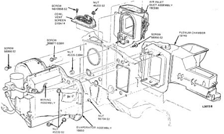

I would like to know how to get to the heater core on a 1985 Lincoln Town Car

REMOVAL Evaporator Case/Plenum Removal

1. Remove the plenum assembly. See: Heater Core Case\Service and Repair Fig. 5 Typical heater core removal. 1982---88
https://images.2carpros.com/forum/automotive_pictures/12900_hc2_2.jpg
2. Remove the four retaining screws from the heater core cover and remove the cover from the plenum assembly. 3. Remove the retaining screw from the heater core inlet and outlet tube bracket. 4. Pull the heater core and seal assembly from the plenum assembly. INSTALLATION Fig. 5 Typical heater core removal. 1982---88
1. Carefully install the heater core and seal assembly into the plenum assembly. Visually check to make certain that core seal is properly positioned. 2. Install the inlet and outlet tube bracket retaining screw. 3. Position the heater core cover and install the four retaining screws and tighten. Evaporator Case/Plenum Removal
https://images.2carpros.com/forum/automotive_pictures/12900_hc1_2.jpg
4. Install the plenum assembly.
