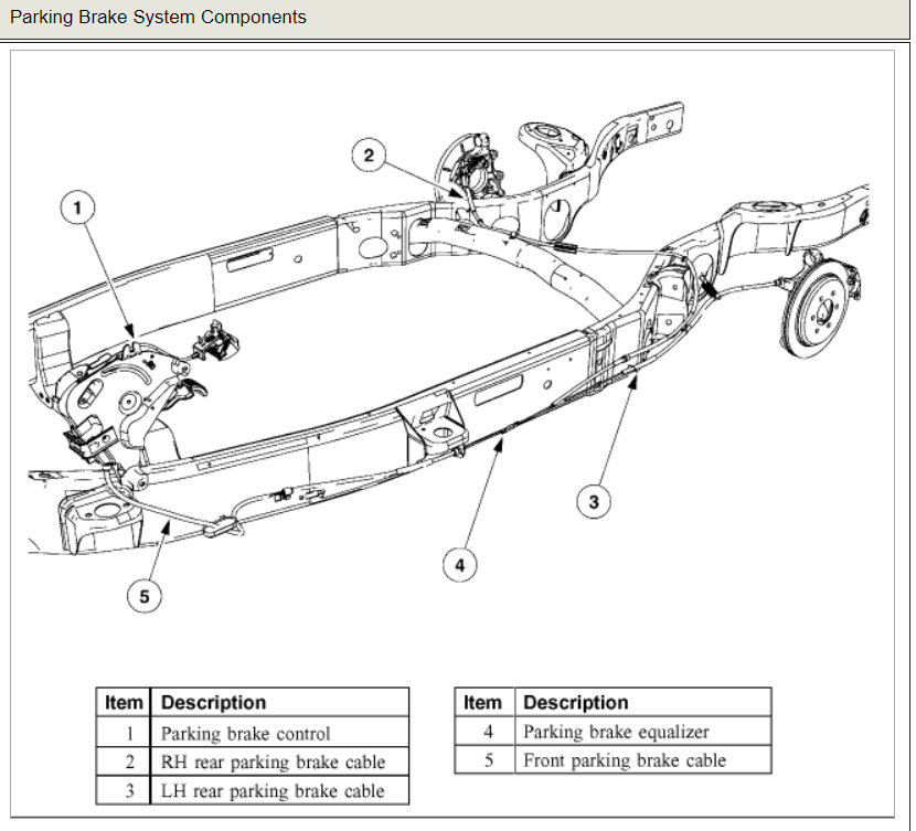

How do I adjust the parking brake on a 2005 Lincoln Navigator? I found the cable underneath, but I could not locate any adjustment along its entire length. The parking brake pedal goes to the floor when I push it. Thanks.

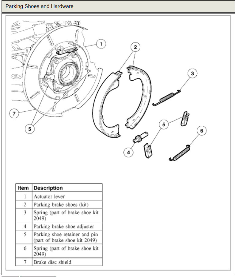

There are two adjustments for this system one is back where the cable split off to each side and the others are at the parking brake shoes themselves.
Here are diagrams of the parking brake system so you can see how it works you probably need to replace the shoes which this guide will help you with.
https://www.2carpros.com/articles/parking-brake-shoe-replacement

You were right the parking brake shoes are shot so I replaced them using the guide you gave and the emergency brake has never worked better cost me 45.00 for shoes :) this site is great.

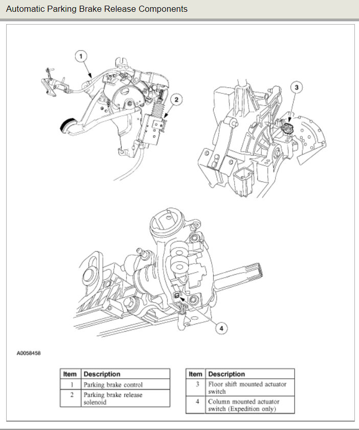

There's two possibilities if the parking brake pedal goes to the floor but the regular brakes are fine. Most likely one of the cables is broken or is disconnected from the lever on one of the shoes. You'll have to watch the cables move underneath while a helper works the pedal. A less likely problem can occur on some vehicles that use an automatic-adjusting parking brake. They use a row of teeth on top of the pedal, and the cable is attached to a toothed lever that drops down to mesh with the pedal as soon as you push the pedal about an inch. If that lever doesn't drop down, the pedal won't pull the cable. That typically happens in real cold weather when the grease gets hard. One way you can identify that problem is to push the pedal just a couple of inches, then wait about five seconds to give that gummed-up spring-loaded lever time to drop down, then push the pedal the rest of the way down. If that works, you'll need to wash out the old grease and relube the lever.
