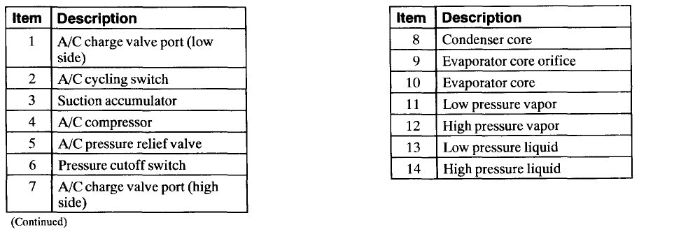

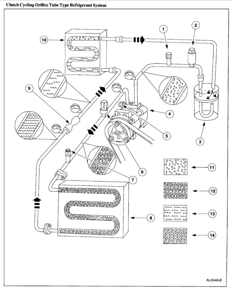

I need to know where the low side of the air conditioner system is to add R134 refrigerant. I know it is the line that feels cold as the air conditioner is running. I can only see the high side (high pressure port) which is hot to the touch.
Jun 28, 2010 at 9:27 AM
  • 54,849 POSTS

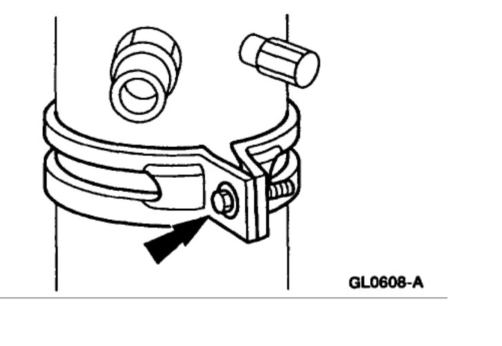

The low side service valve is located on the accumulator near the fire wall. Here are some guides and diagrams to help you get the job done.
https://www.2carpros.com/articles/air-conditioner-how-to-add-freon
and
https://www.2carpros.com/articles/how-a-car-air-conditioner-works
and
Here are some diagrams (Below)
