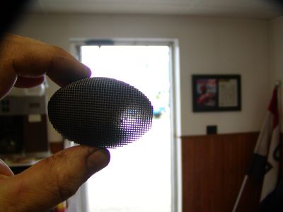

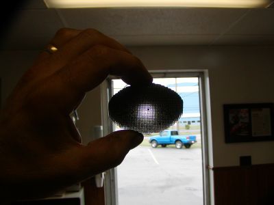

SERVICE WRITER
  • 9,123 POSTS
PO420? The converter may be causing the misfire. I understnad what your are saying about the moisture, but it may not be the cause of the drivibility IF there was a misfire from the ignition, misfire codes would be present, PO300-PO308, If you don't have those, I'd suggest to start focusing on the converter. The converter can break up internally, your is under factory warranty. There are good for 8 years/80,000 by federal law.
https://images.2carpros.com/forum/automotive_pictures/30961_converter1_1.jpg
https://images.2carpros.com/forum/automotive_pictures/30961_converter2_1.jpg
https://images.2carpros.com/forum/automotive_pictures/30961_converter4_2.jpg
