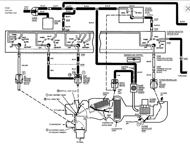

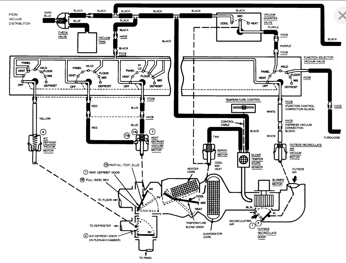

My girlfriend took her car to a mechanic to put in some wheel bearings, now the car shakes in idle and is getting poor engine performance, looks like some of the vacuum hose connectors have been broken, I don't know Lincoln's all to well so I don't know where all the lines connect. Can you help me?

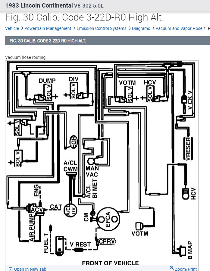

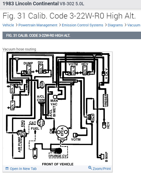

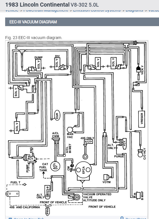

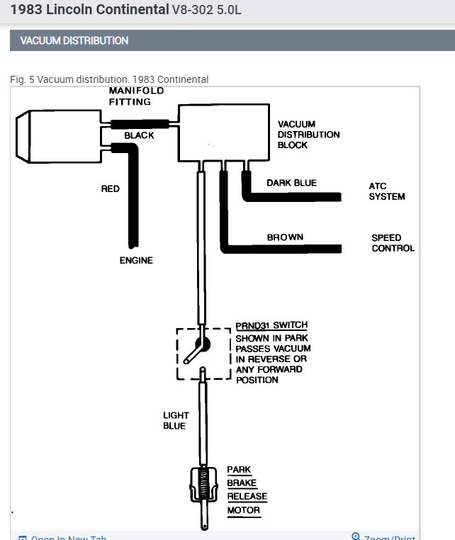

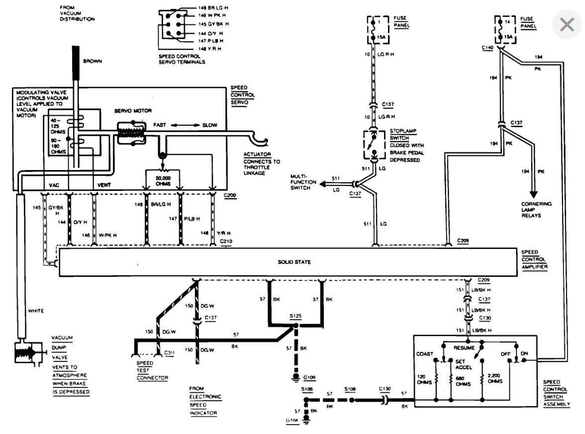

This vehicle has several vacuum operated components.
I have attached all the vacuum diagrams that controls different components (look below).
