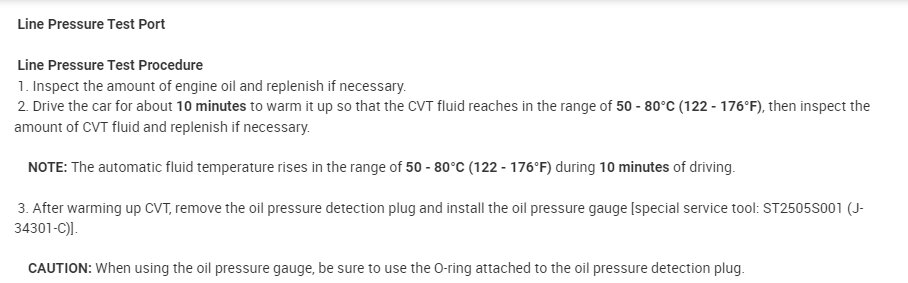

Car starts and idles great but when I shift into drive nothing happens. Rpm can only Rev to 2,000, same in reverse, P,N everything revs normal. Cannot move the car in neutral. If I turn the car off and put it in neutral it will roll. Another thing is sometimes it will move in drive or reverse but not for longer than 10 to 20 ft until it just stops completely locked up again. I can shut it off and back on and it will move again for 10-20 ft again. The shift knob moves and dash lights match the gear it's in. I can even move the shifter knob from where it hooks into the transmission. Just changed the transmission fluid with the cvt ns2 fluid.

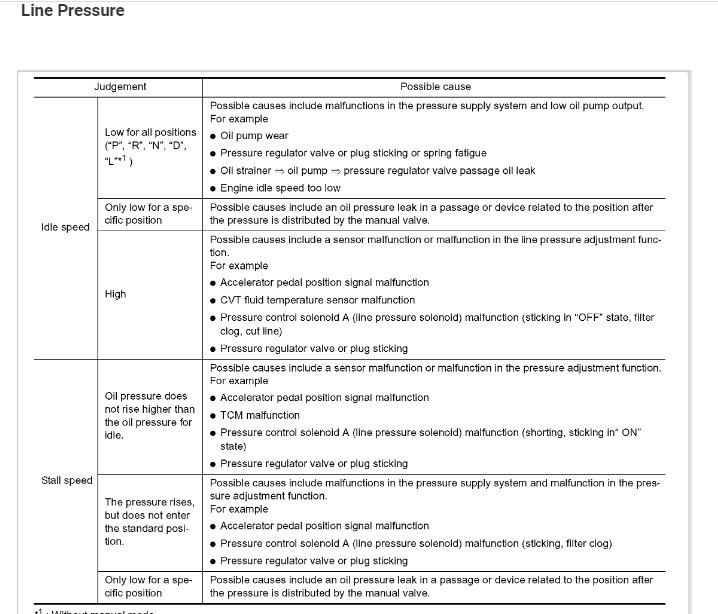

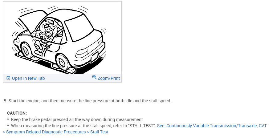

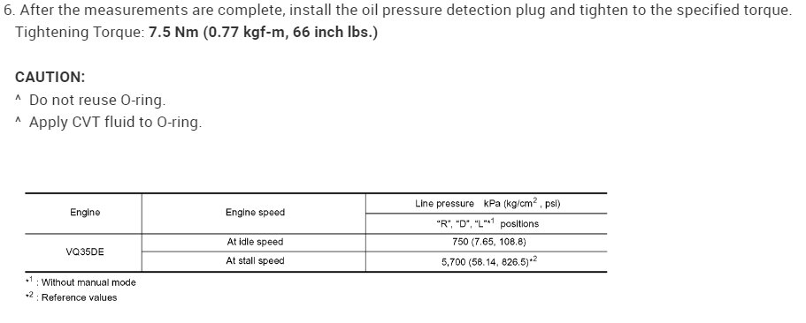

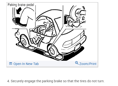

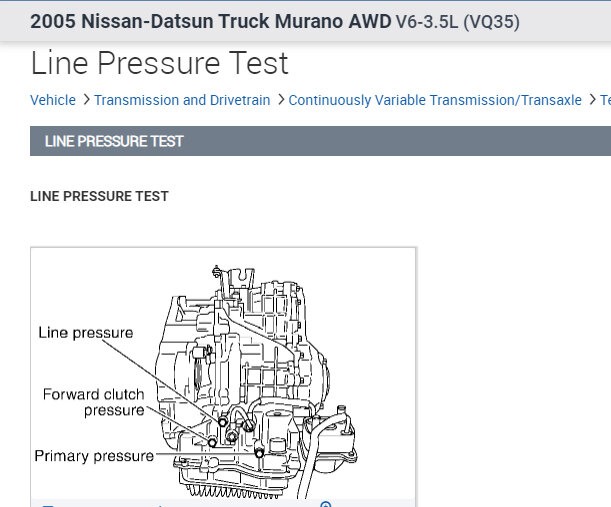

Also, is this the original transmission and how dirty was the fluid when you changed it? I ask because it could simply be a faulty transmission or there could be a line pressure-related issue. If you look below, I attached the tests for checking line pressure.
I've seen the transmission cooler become restricted causing low pressure. However, keep in mind with a CVT transmission, often times this indicates an internal problem.
