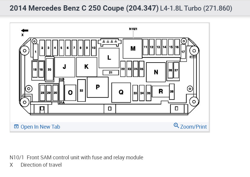

Limp mode and code c002?
2014 MERCEDES BENZ C250
120,000 MILES • 4 CYL • TURBO • 2WD • AUTOMATIC

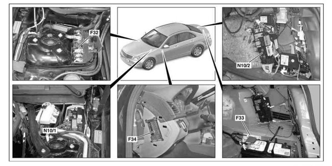

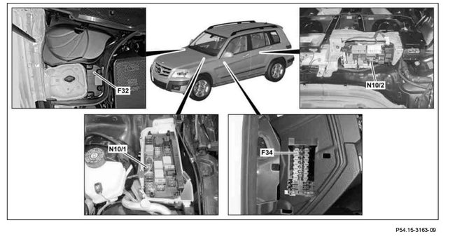

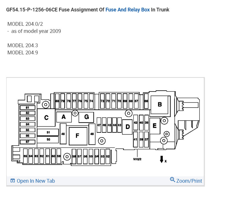

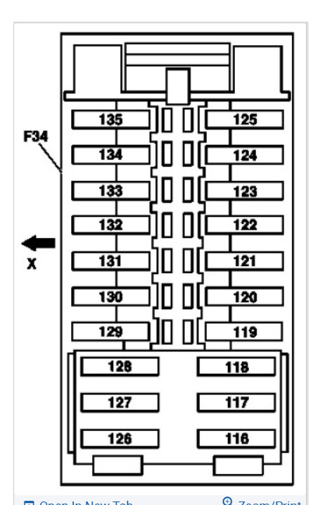

This code is because the DOG bus has lost communication, can I ask how you got this code did you use a CAN scanner? and has the car had any water damage? I would start by checking all fuses. here is a guide to help and the fuse locations in the diagrams below:
Most of the time it will be the front SAM control module, but we need to confirm that before a replacement. Do the testing with the key on. Check out the diagrams (below). Please let us know what you find. We are interested to see what it is.
