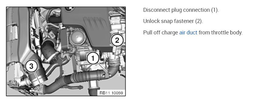

When I went to get into my car this morning, which is a 2 series, but not listed on your list, it would move forward in drive, backwards in reverse, but would not allow any gas to get to it. It wasn't until I turned it off and then back on that it started to work properly. My question is, do I need to have a part cleaned or is this more indicative of a larger problem?
Jan 31, 2023 at 4:31 AM
  • 55,224 POSTS

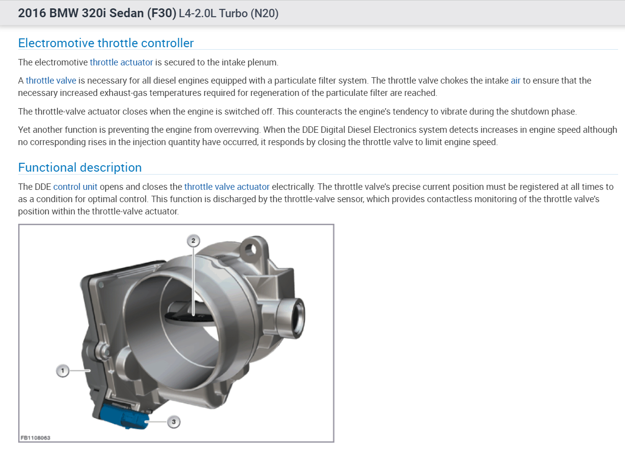

Most of the time this happens because the throttle bore gets dirty, please check out this guide below:
https://www.2carpros.com/articles/reduced-power-limp-mode

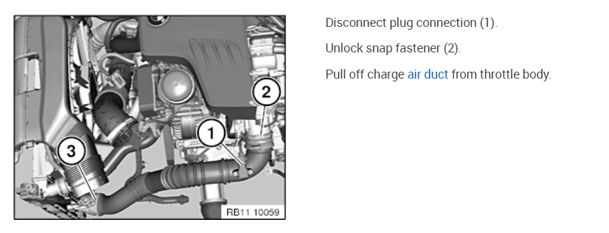

Here is a generic guide on how to service the throttle bore with instructions below for your car:
We should run the codes as well.
