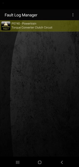

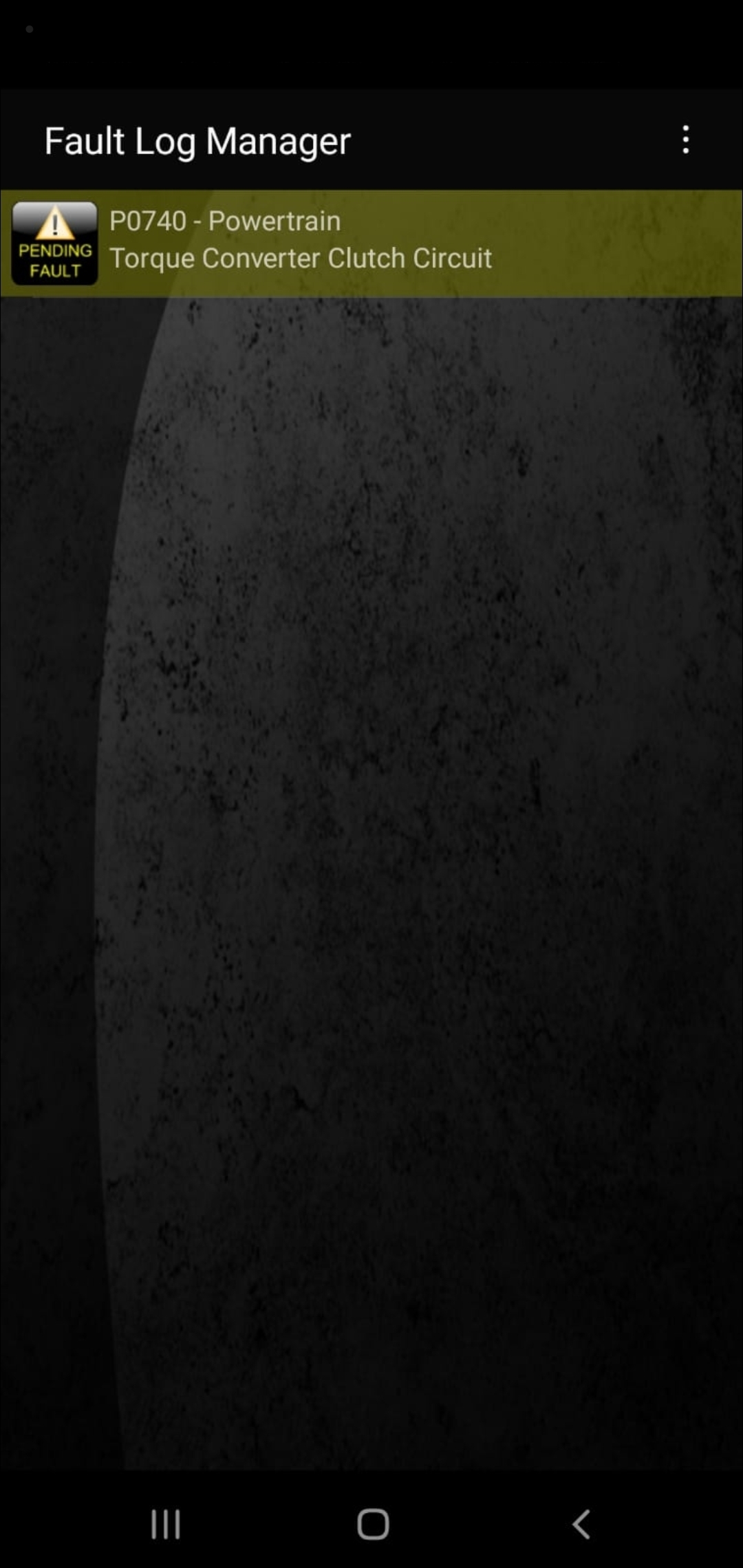

Once it has been running for a while, the transmission starts slipping in all gears. Changed the transmission fluid cooler to an aftermarket and helped a little. Took it to a shop and didn't help. Changed the transmission at 45,000 miles at the dealer but issue came back. Put a scanner and reads p0740. Does anyone know if I can put a standard transmission? If so, does it have to be from another diesel engine or can I use a gas engine transmission, considering the diesel stroke? Any ideas? On the verge of selling but has sentimental value. Please help.

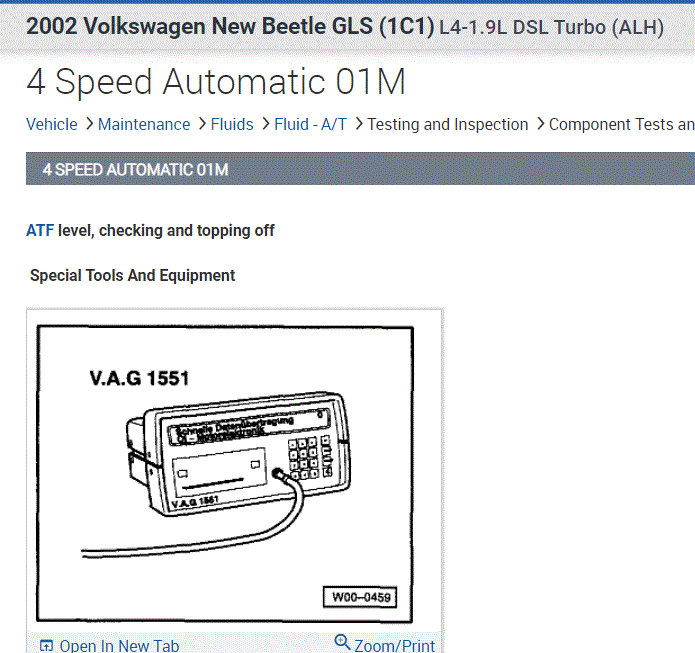

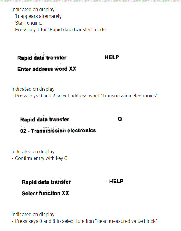

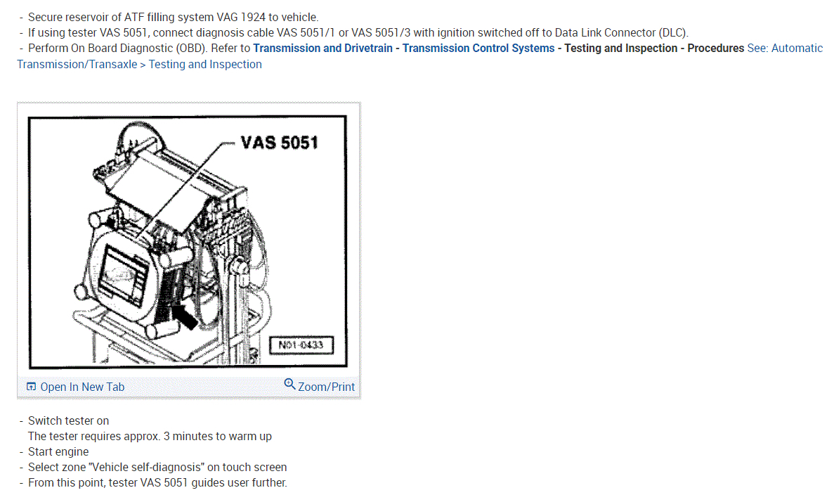

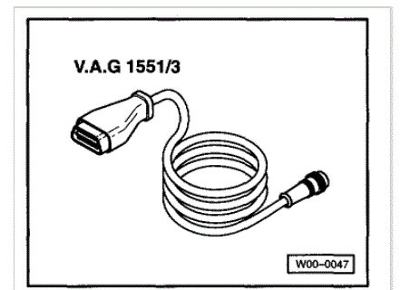

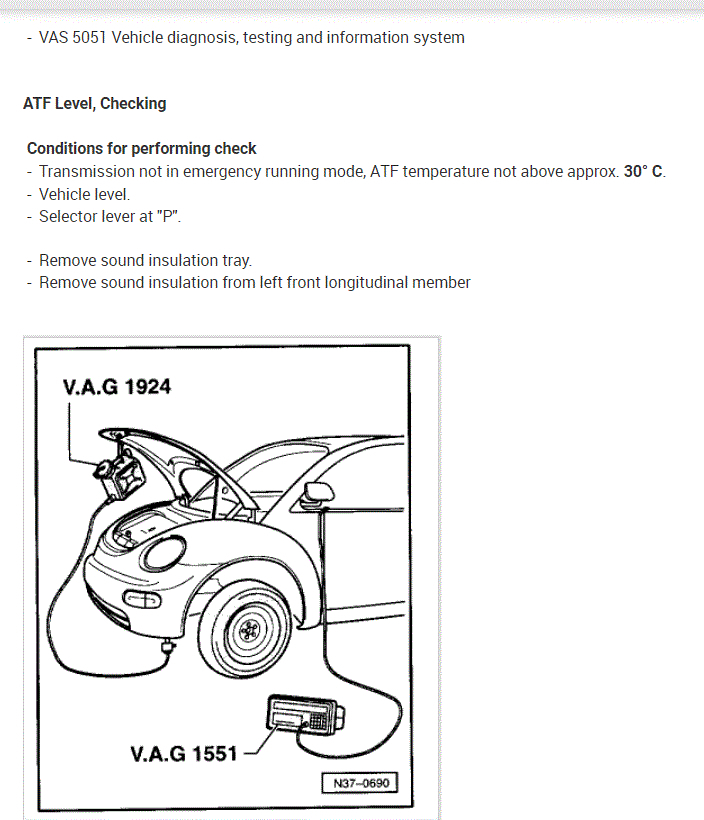

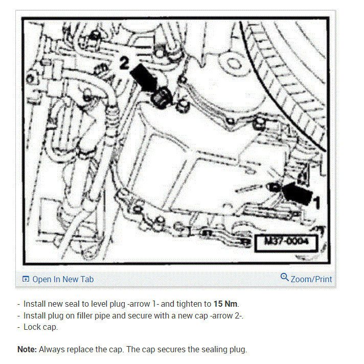

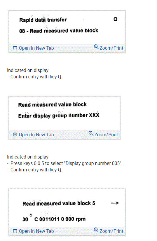

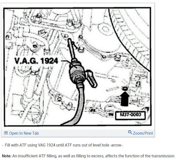

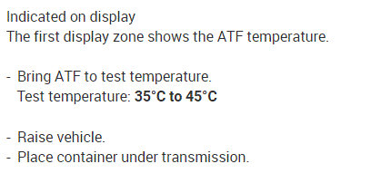

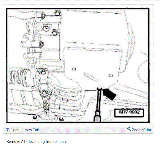

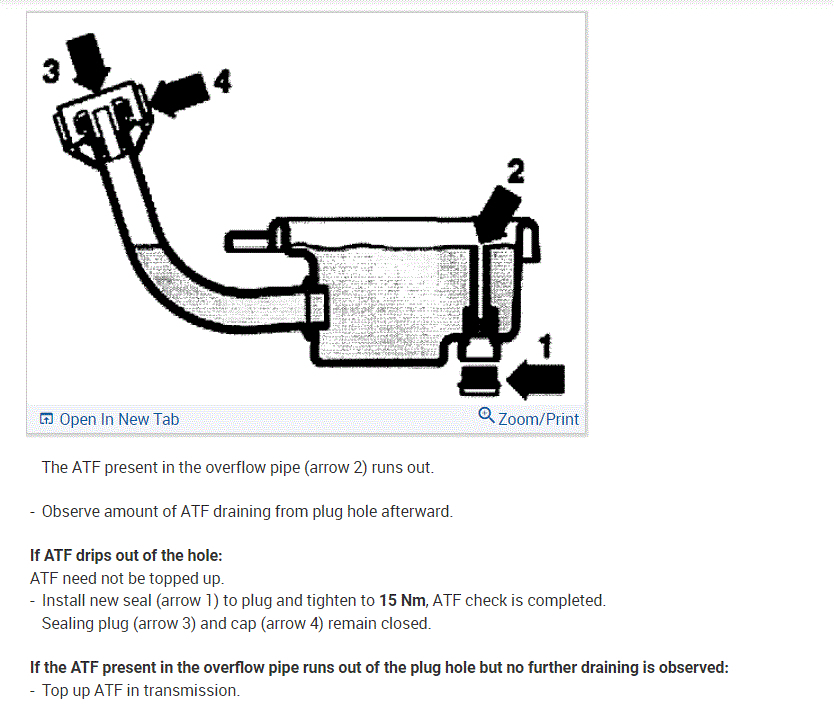

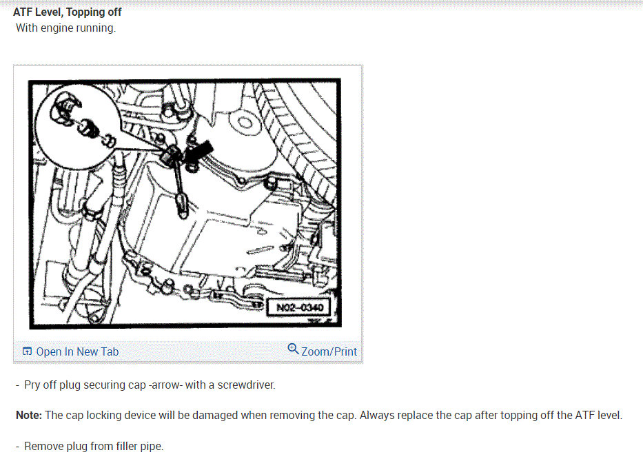

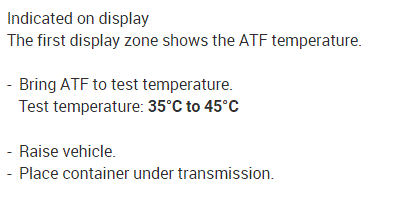

The code indicates the converter clutch is open. The diagnostic are very specific as far as checking the fluid. When you checked it, was the engine warm and running?

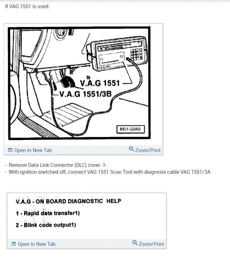

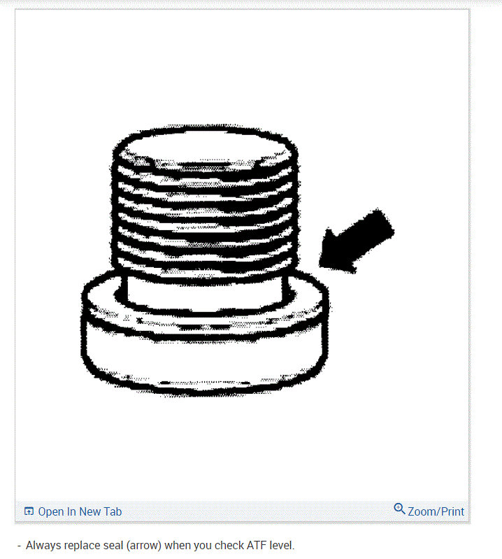

Take a look at the attachments below which describe how the fluid is checked. See if anything was missed.
As far as changing it to a manual, everything, including the powertrain control module, wiring, transmission, pedals, and so on needs to be changed. Anything is possible, but at what cost is the question.

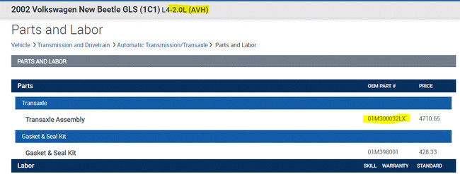

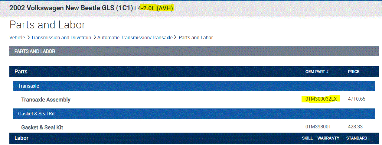

Sounds like a lot. Keeping it simple. Can I use an automatic transmission from a gas engine or does it have to be from another diesel?
Sep 15, 2021 at 7:33 PM
  • 110,194 POSTS

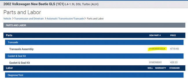

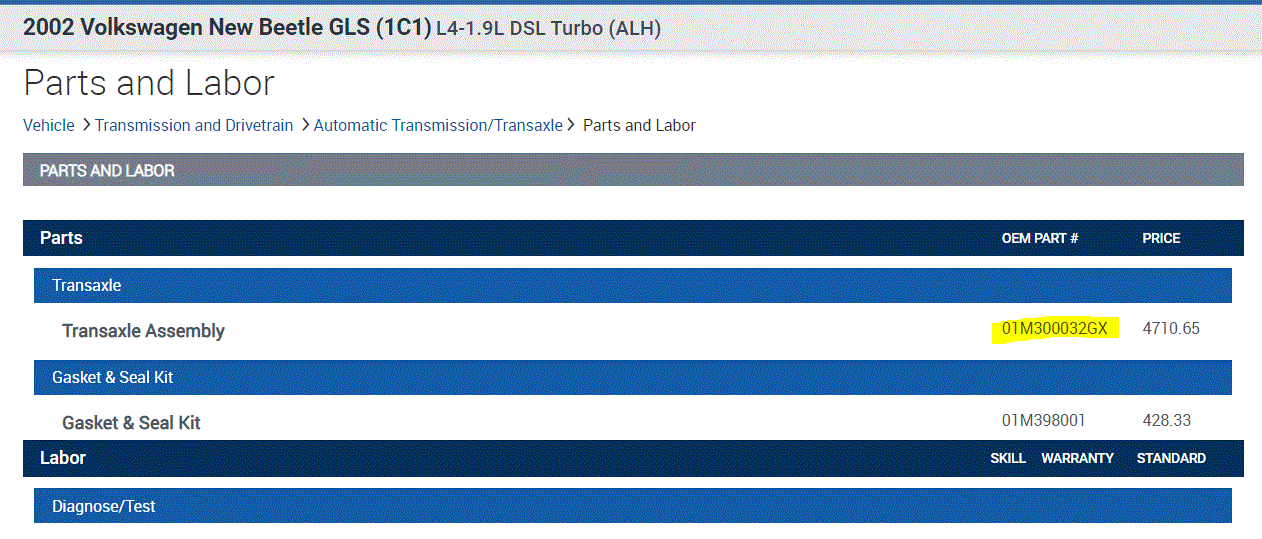

I looked up the OEM part number for an 02 Diesel and an 02, 2.0L gas engine. The part numbers are the same, so if you get one for an 02 2.0L, it should be the same.
See pics below. Pic 1 is the diesel and pic 2 is the gas 2.0L.
