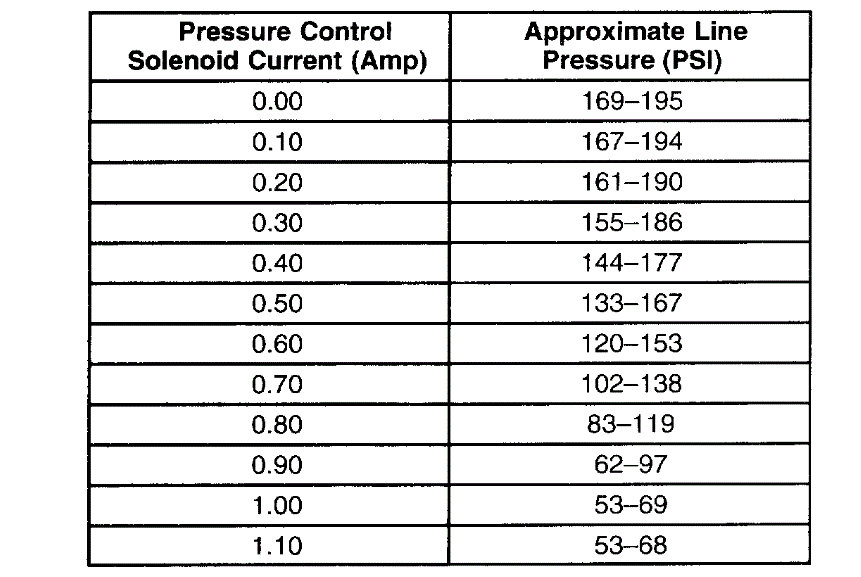

Two days ago my husband was pulling out and some one came up on our tail end pretty fast so he gave it some gas to get put of the way. we'll it went about 20 feet and then it would not go anymore. he pulled over and the head shot would go in to gear but all my car would do is rev up. it won't actually go. we have replaced both shift solenoids and the pressure solenoid and still nothing. Can some one please help me? I don't have another vehicle.

When the pan was dropped, was there any metal or debris in the pan or on the magnet?
Are there any codes set in the system?
Does the truck have reverse?
The most common failure is the torque converter or the front pump inside the transmission.

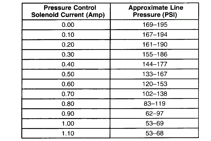

Pressure tests need to be done to confirm there is no line pressure for the transmission to work. I attached the procedure and the chart for testing. You will need an advanced scan tool for this test plus a pressure gauge to attach to the transmission.
Line Pressure Check Procedure

Important: In order to achieve accurate line pressure readings, the following procedure must be performed at least three times in order to gather uniform pressure readings. The scan tool is only able to control the PC solenoid in PARK and NEUTRAL with engine speeds below 1500 RPM. This protects the clutches from extreme high or low line pressures.
11. Begin commanding PC Solenoid at 1.0 amp and lower the amperage in one-tenth increments (0.01) until maximum line pressure is achieved.
12. Allow the pressure to stabilize between increments.
13. Compare your pressure readings to the Line Pressure table.
14. If the pressure readings vary greatly from the line pressure table, refer to Oil Pressure High or Low.
