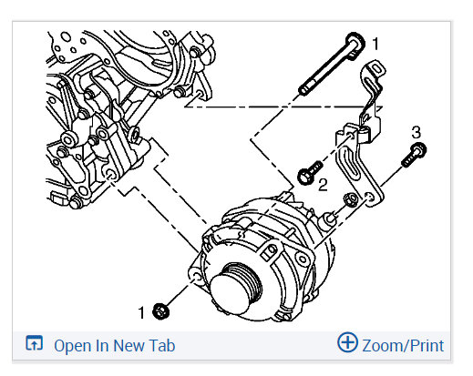

Intermittently, when my engine is running, all turned-on lights will pulsate (brighten then dim) repeatedly?
2012 NISSAN QUEST
270,000 MILES • 3.5L • V6 • 2WD • AUTOMATIC
JOSUE RODRIGUEZ2
  • 23 POSTS
Sometimes it's only the headlights and other times it's every light that's on. I thought it was the alternator but when I got it checked at AutoZone, they said that my battery and alternator were in the clear. I watched a couple YouTube videos and learned that it could be the voltage regulator or a bad ground somewhere. But since the voltage regulator is inside the alternator maybe it's alright. Any advice would be great.
Thanks!
Mar 30, 2024 at 2:45 PM
  • 55,433 POSTS
Yes, this can happen when the ground from the battery to the chassis or the ground from the battery to the engine is no good. I would run a jumper wire while the engine is running, and the lights are on to see if it makes a difference. If not, the alternator is bad and the auto parts store can't tell. Here is how to replace the alternator correctly in case you need it.

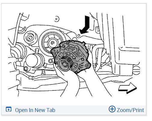

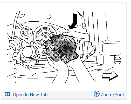

16.Remove alternator from the right side of the vehicle.
CAUTION:
Be careful not to contact with and damage surrounding parts when removing alternator from the vehicle.

- Temporarily tighten all of alternator bolts and nut. And then tighten them in numerical order shown in the figure.
- Install alternator, and check tension of belt. See: Drive Belt > Procedures > Checking Drive Belt.
- Be careful to tighten "B" terminal nut carefully.
- For this model, the power generation voltage variable control system that controls the power generation voltage of the alternator has been adopted. Therefore, the power generation voltage variable control system operation inspection should be performed after replacing the alternator, and then make sure that the system operates normally. See: Charging System > Initial Inspection and Diagnostic Overview > Inspection Procedure.
