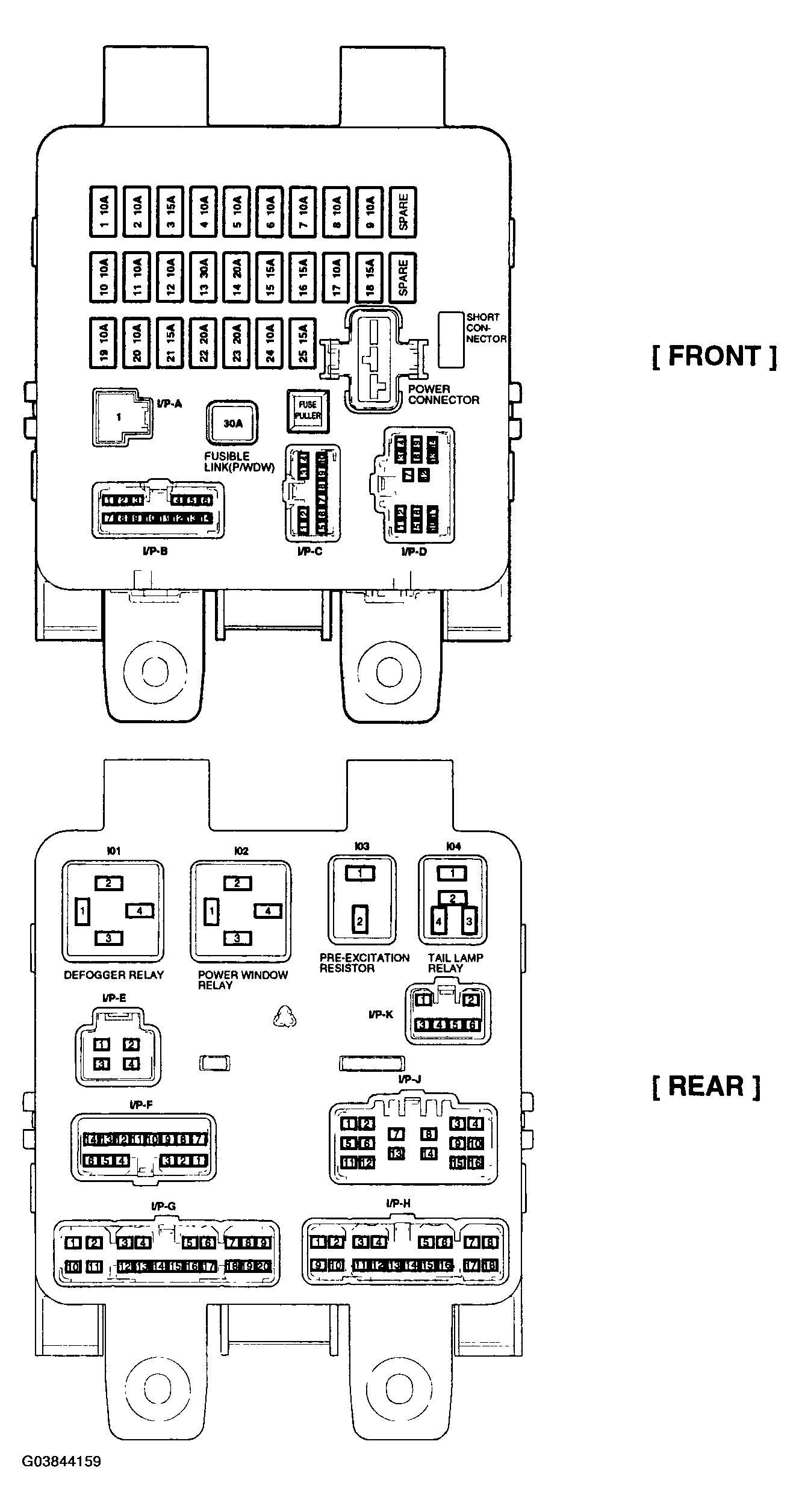

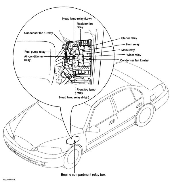

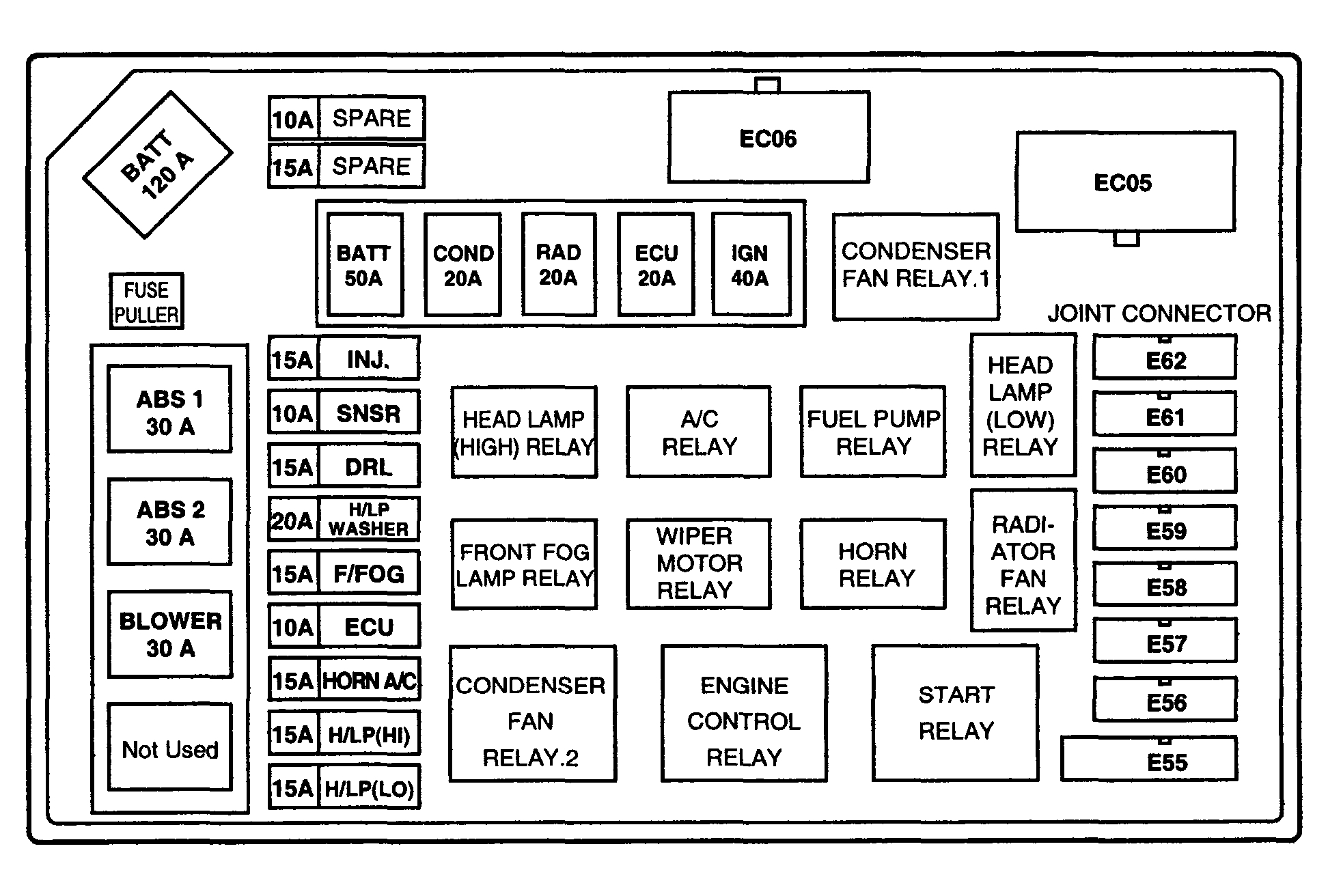

The low and high beams have quit working as well as the blower and radio all at the same time. All the other lights work just fine and everything else is good just not those thre.
