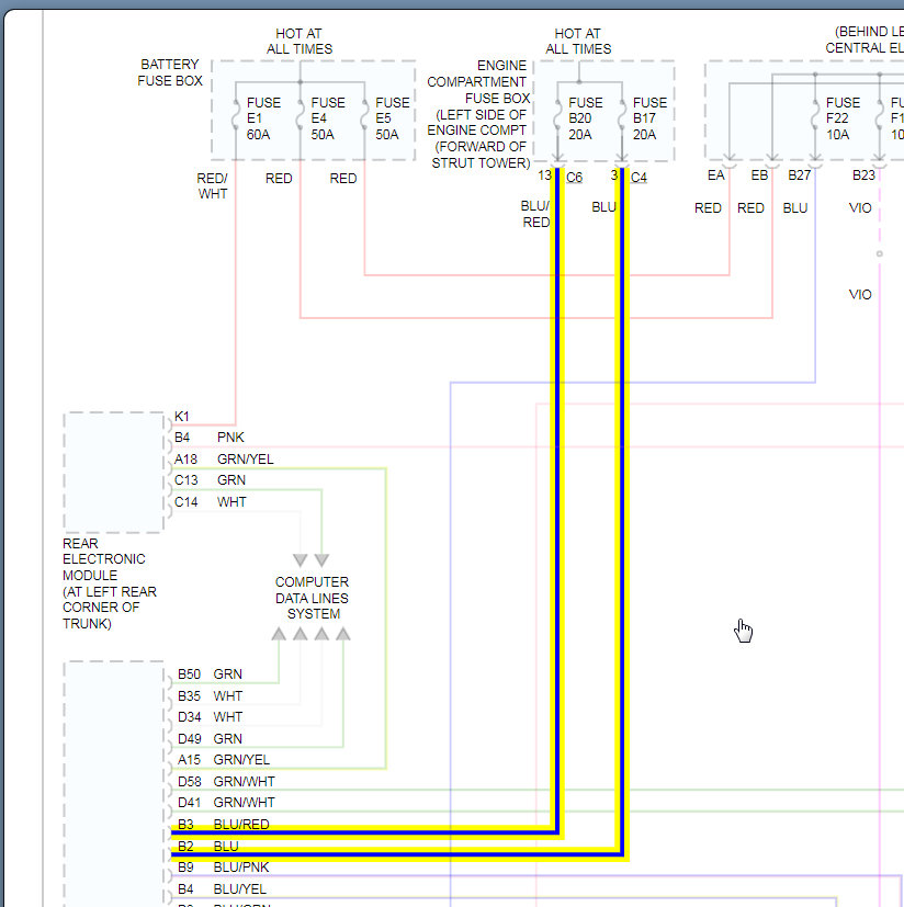

Headlights, brake lights, turn signals and lower interior lights stopped working
2005 VOLVO S60
130,000 MILES • 2.5L • 5 CYL • TURBO • 2WD • AUTOMATIC
JEFFMEHR0
Also, the check stop lamp appears in message window.
Nov 30, 2020 at 5:00 PM

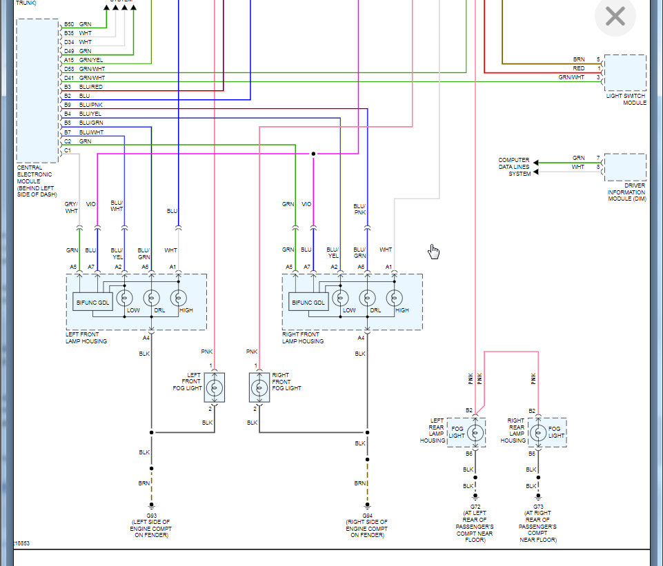

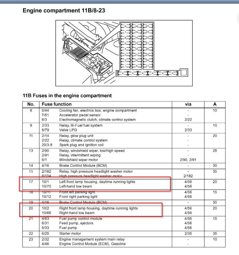

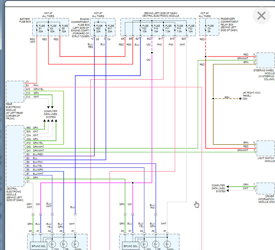

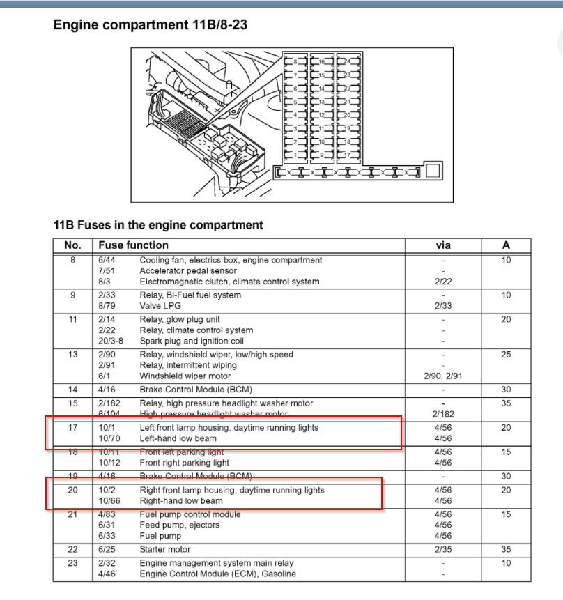

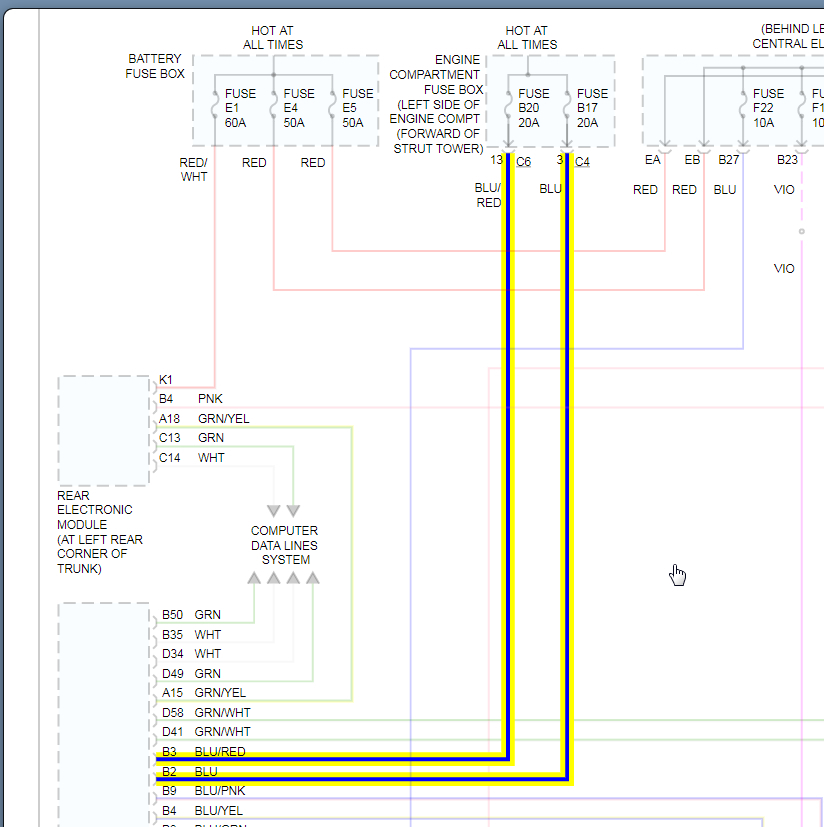

I have a feeling that this is the central electronic module but let's confirm that by checking the fuses for the CEM and the headlight circuitry. This is Fuse B20 and B17 in the engine compartment fuse box. If these fuses are ok, then I suspect the module has failed because if they all went out at the same time then this is the likely thing in common.
Let's start with this and we can go further with the brake lights just to confirm those are pointing to this as well.
However, as you can see these two fuses are for each headlamp so it is unlikely that they would each fail plus all the other lights. Which points to the CEM.
