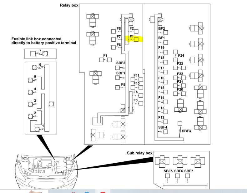

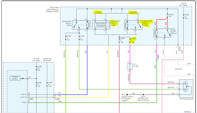

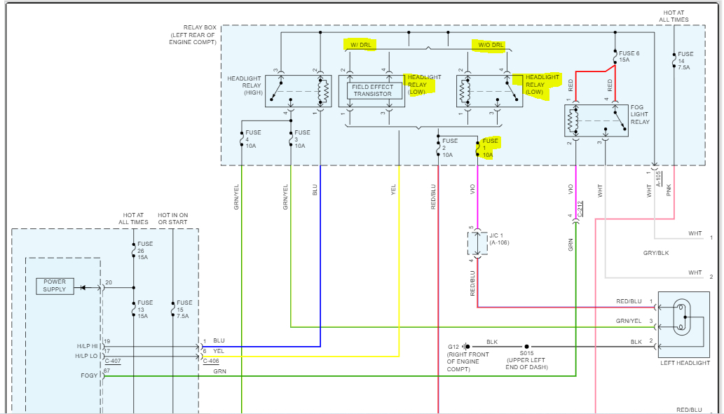

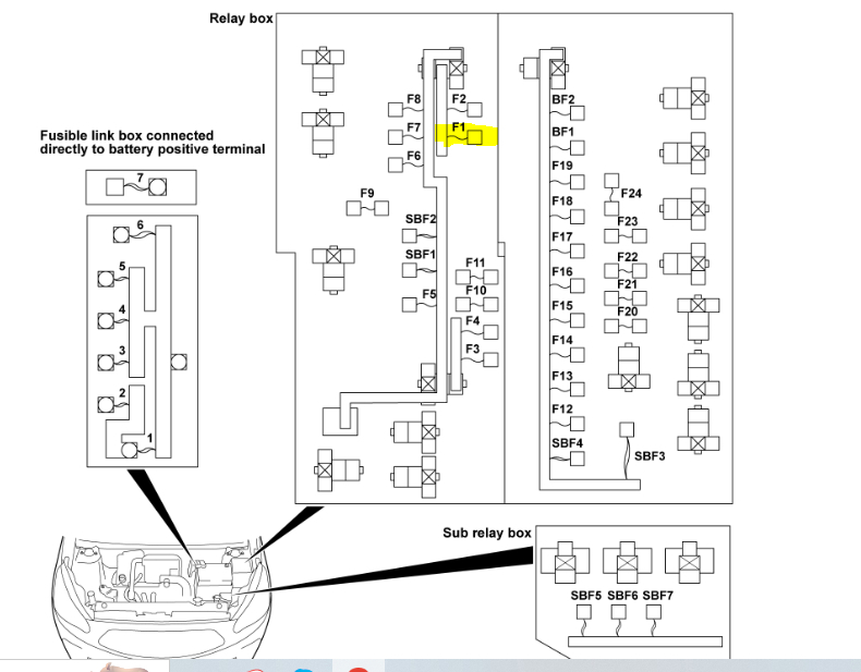

There is a headlamp relay for the low beam. It provides power to both the left and right lights. However, each bulb has a separate fuse. Fuse 1 in the under-hood fuse/relay box is for the left (driver's side) low beam. Check that fuse. When you check it, make sure there is power present to it and from it. In this case, turn the ignition key to the run position (engine off) and turn the low beam headlamps on to check for power at the fuse.
Next, if the fuse has power, go to the headlamp and disconnect it. Check the red wire with a blue tracer for power with the lights requested on. If you have power, either the bulb is bad or there is no ground. But, if the high beam works, the ground should be present.
