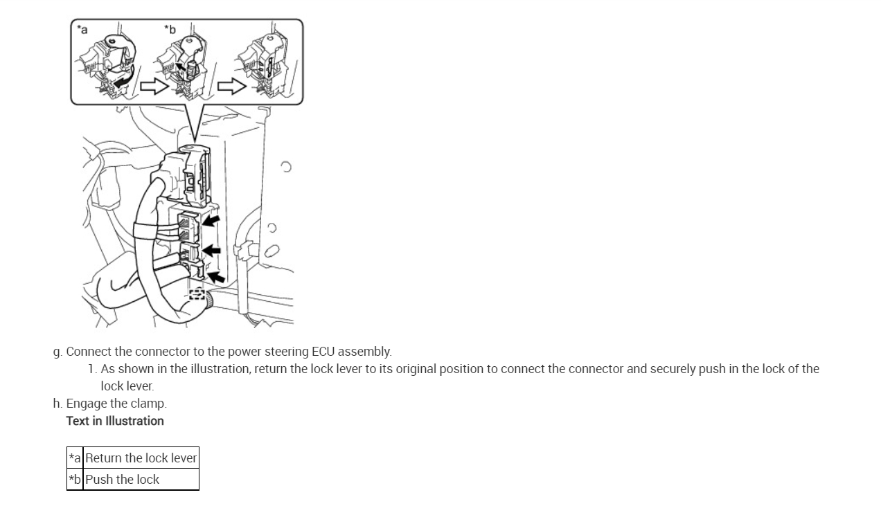

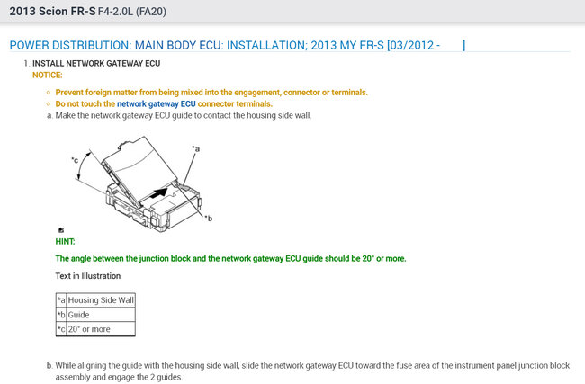

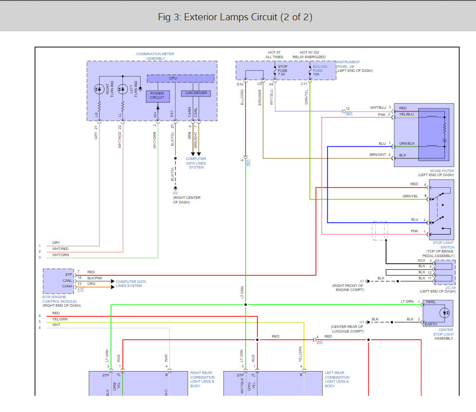

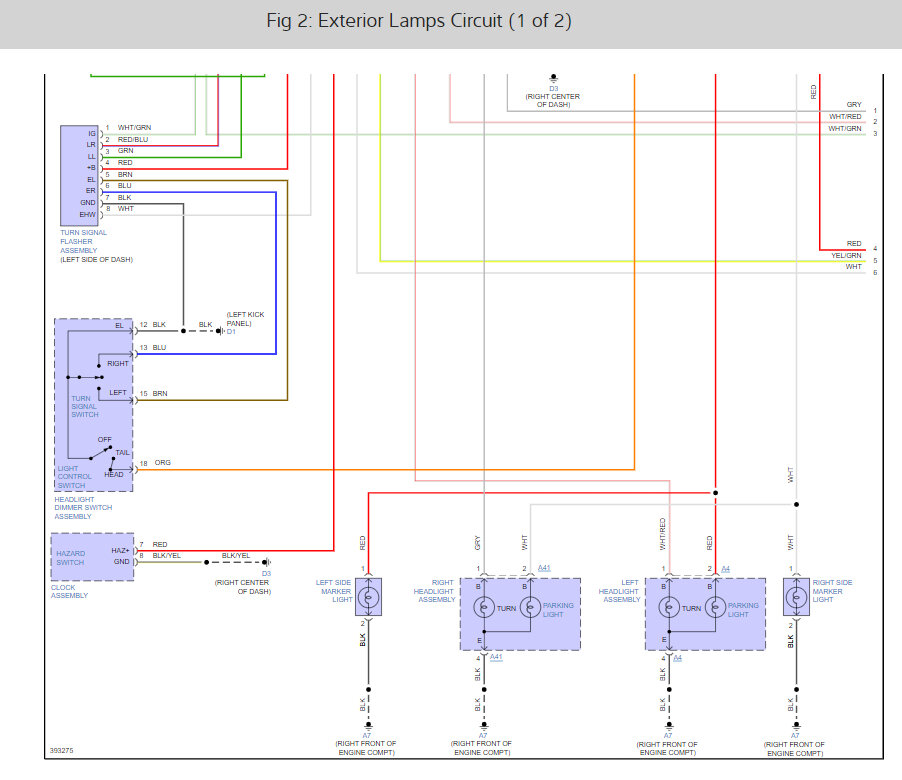

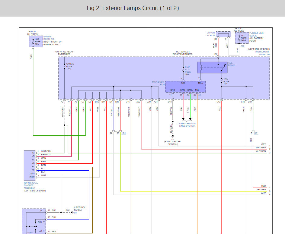

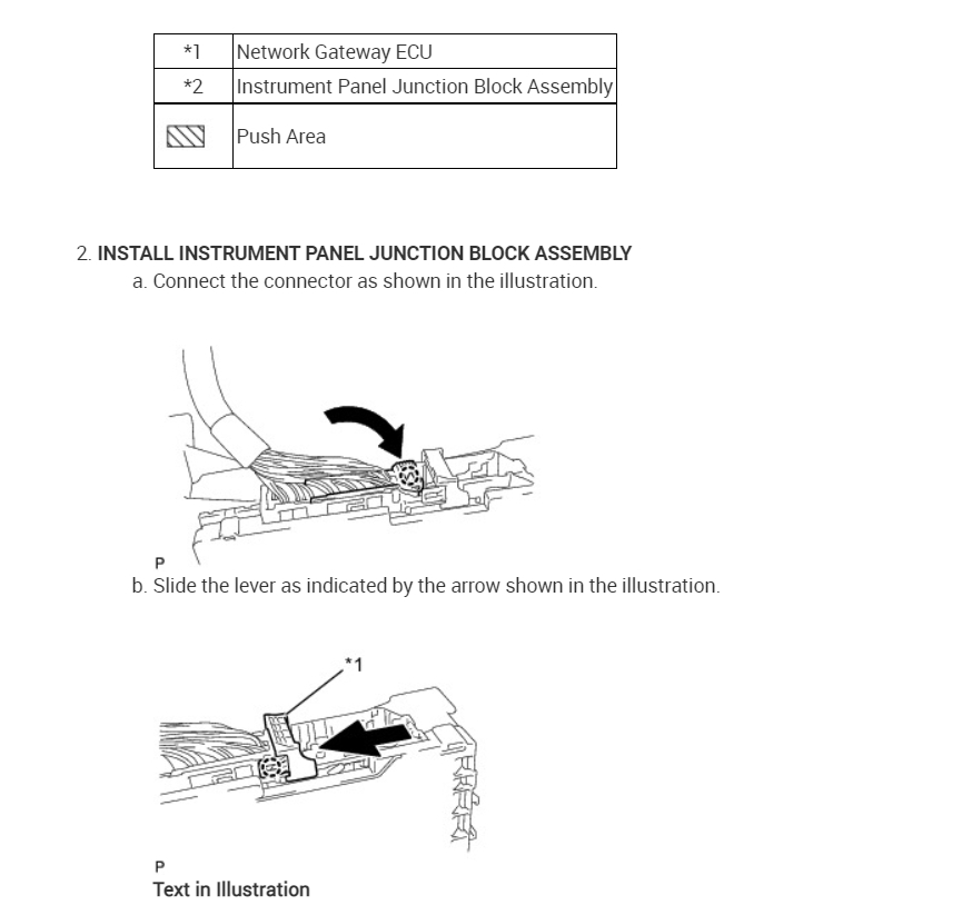

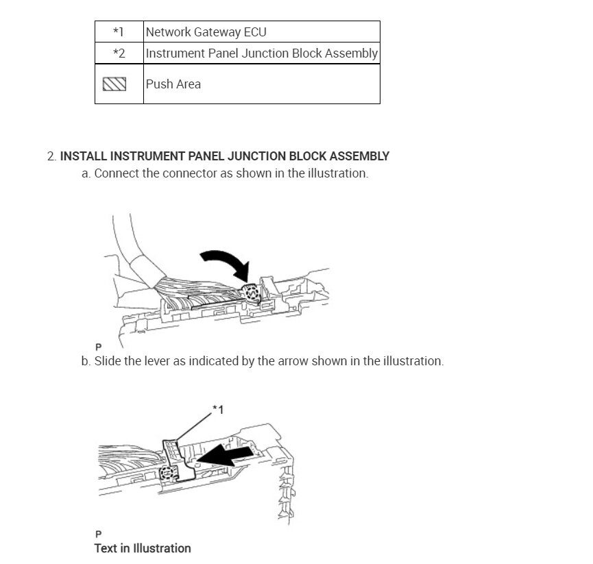

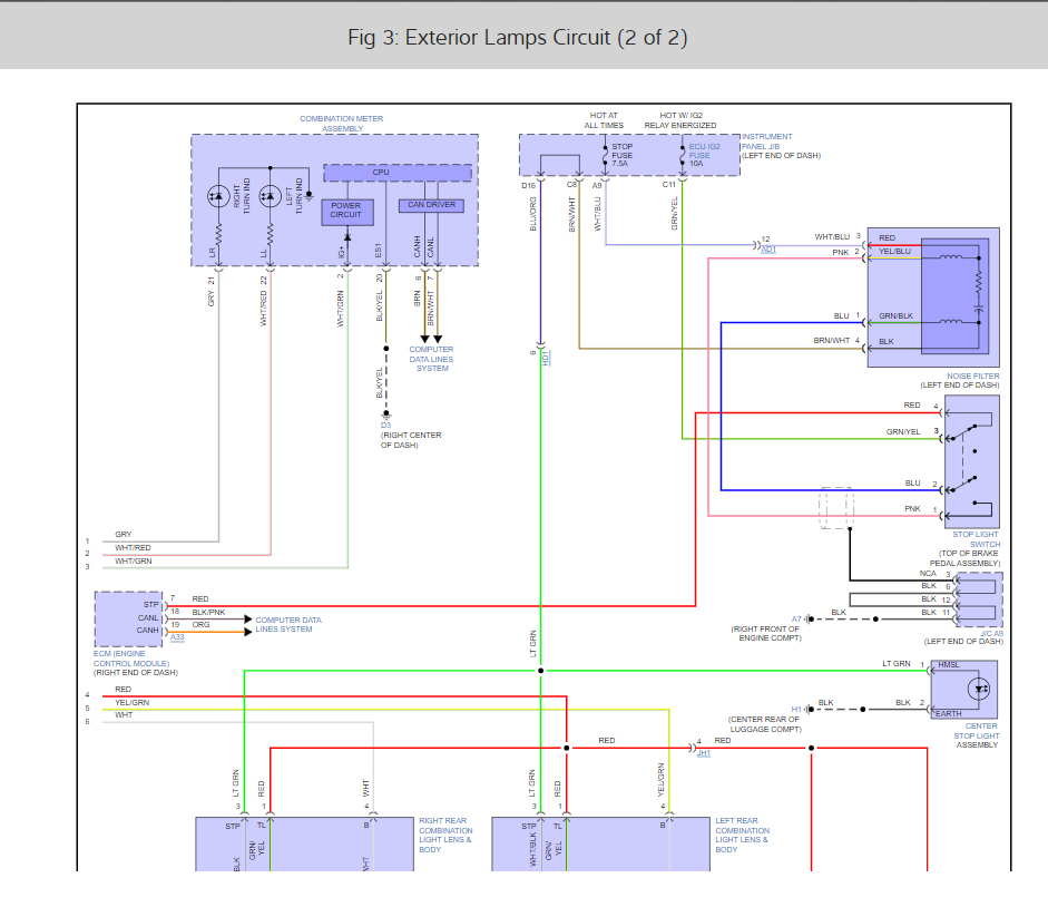

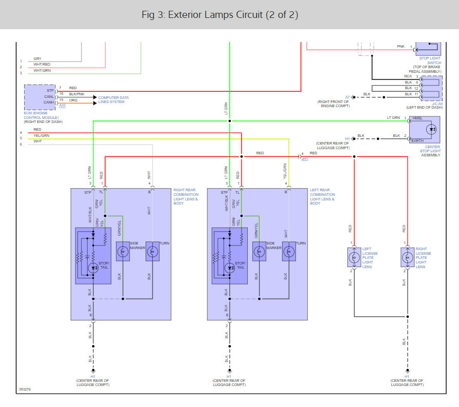

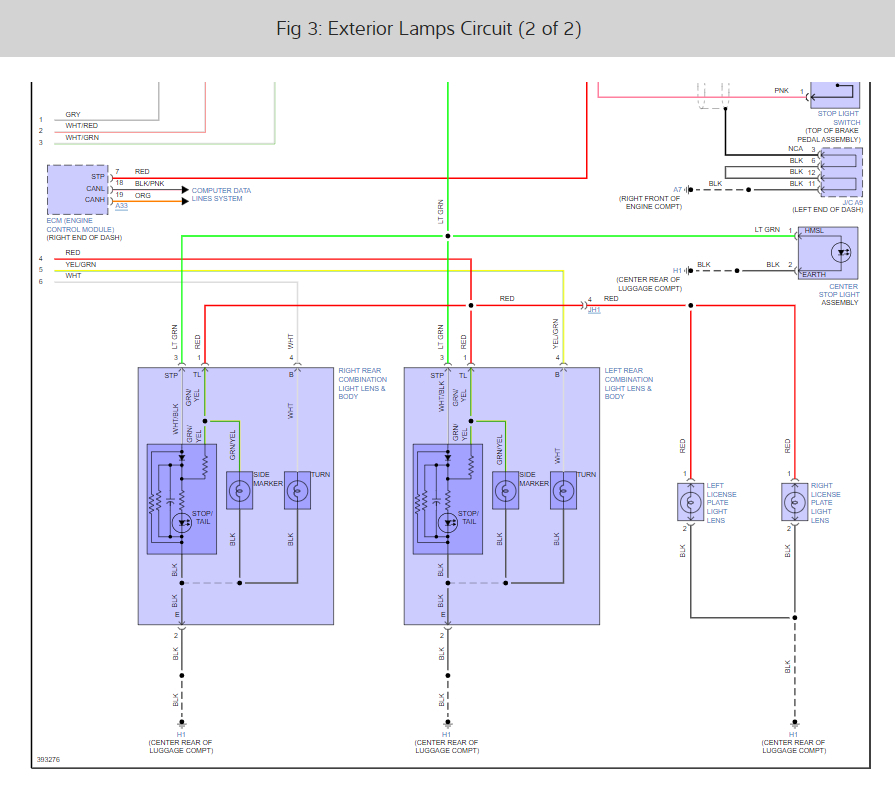

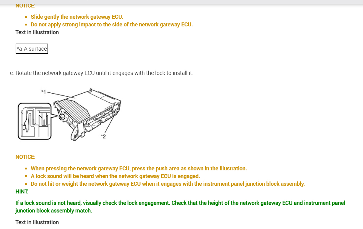

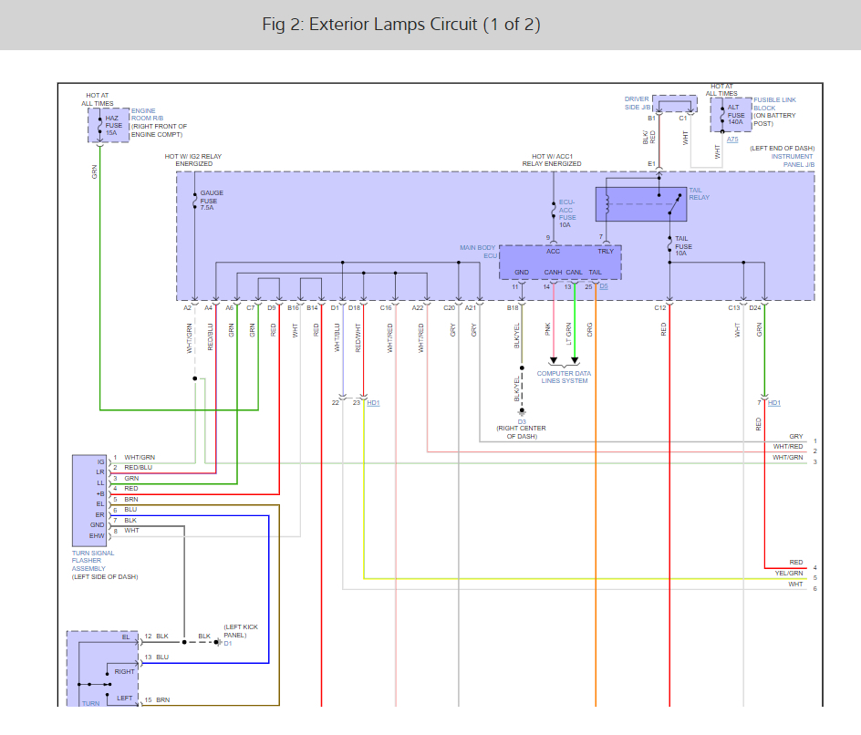

It sounds like the BCM is out or the taillight relay is stuck on, let's try to pull the relay to see if the lights go out. Here is the relay location which is on the left side of the dash fuse panel, and I have included the taillight wiring diagrams so you can see how the system works. If you swap the relay and the problem persists the BCM could be out but to be sure let's do a CAN scan which is easy,

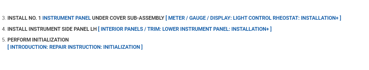

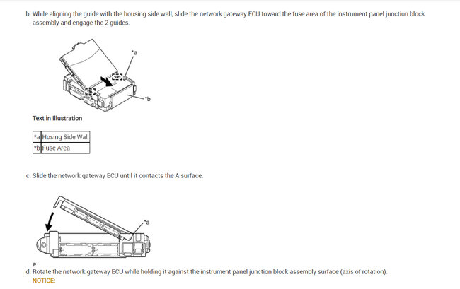

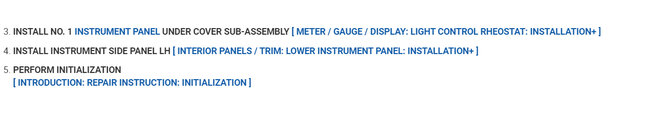

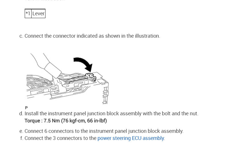

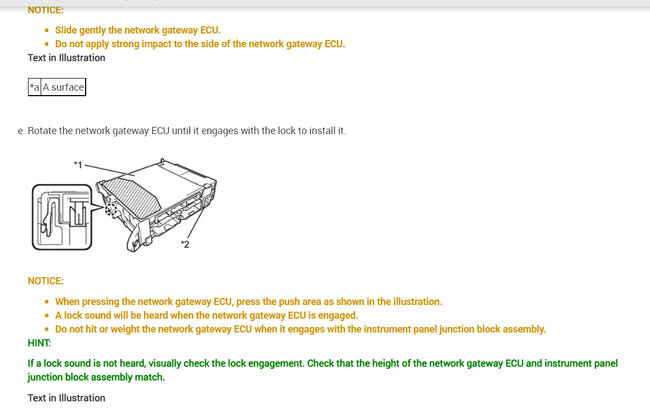

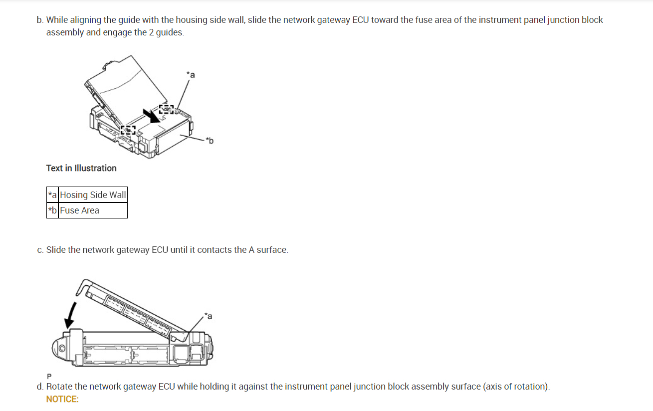

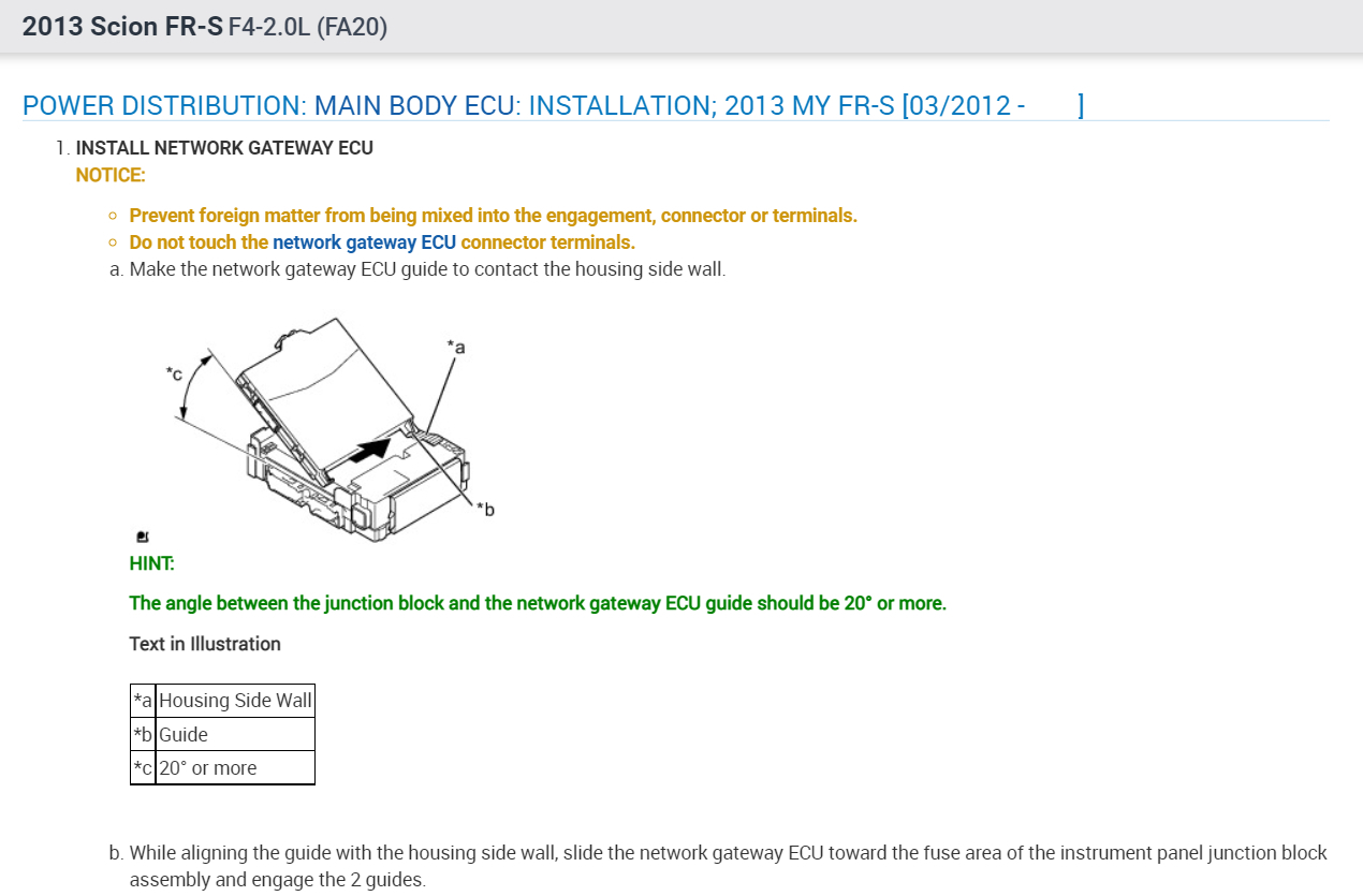

Here is how to change the BCM out as well in case you need it. Check out the images (below). Let us know what happens and please upload pictures or videos of the problem.

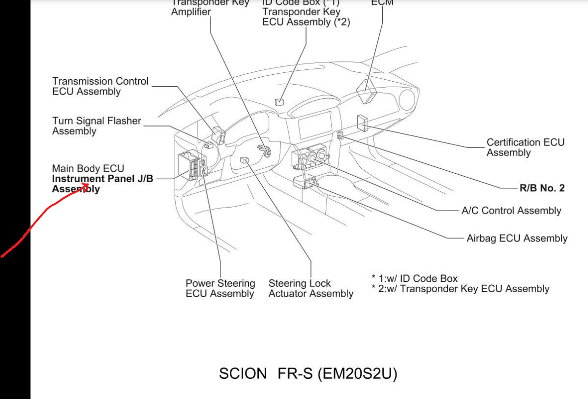

I will try your other suggestion as soon as I get home. I couldn't find the relay on any fuse box diagrams though, is it just number 4 on the dash fuse box? Left side top row?
And just wondering where is the actual BCM in my car, slightly behind the dash?

Yes, the fuse and BCM should be on the left side of the dash as in the diagrams. a U1201 code is an indication the BCM is bad as well. The relay is an intrical part of the BCM. I am not sure what you mean about fuse #4 ? Let me know what happens.

Hi again Ken, sorry it's been a while. I got the car started and got to the BCM. I took out the taillight relay and sure enough the taillights went out. I am looking for a replacement BCM now. My only question is why would the BCM have gone out after my wheel well liners came out? I only ask this because I want to be sure that the BCM is the issue and not something else. Thank you so much for your help, you've been amazing.

When the wheel liner got removed by the bump did it tear any wiring? If not, the bump could have knocked out the BCM which can happen. As far as the BCM goes I would call the company first to make sure they are there.
