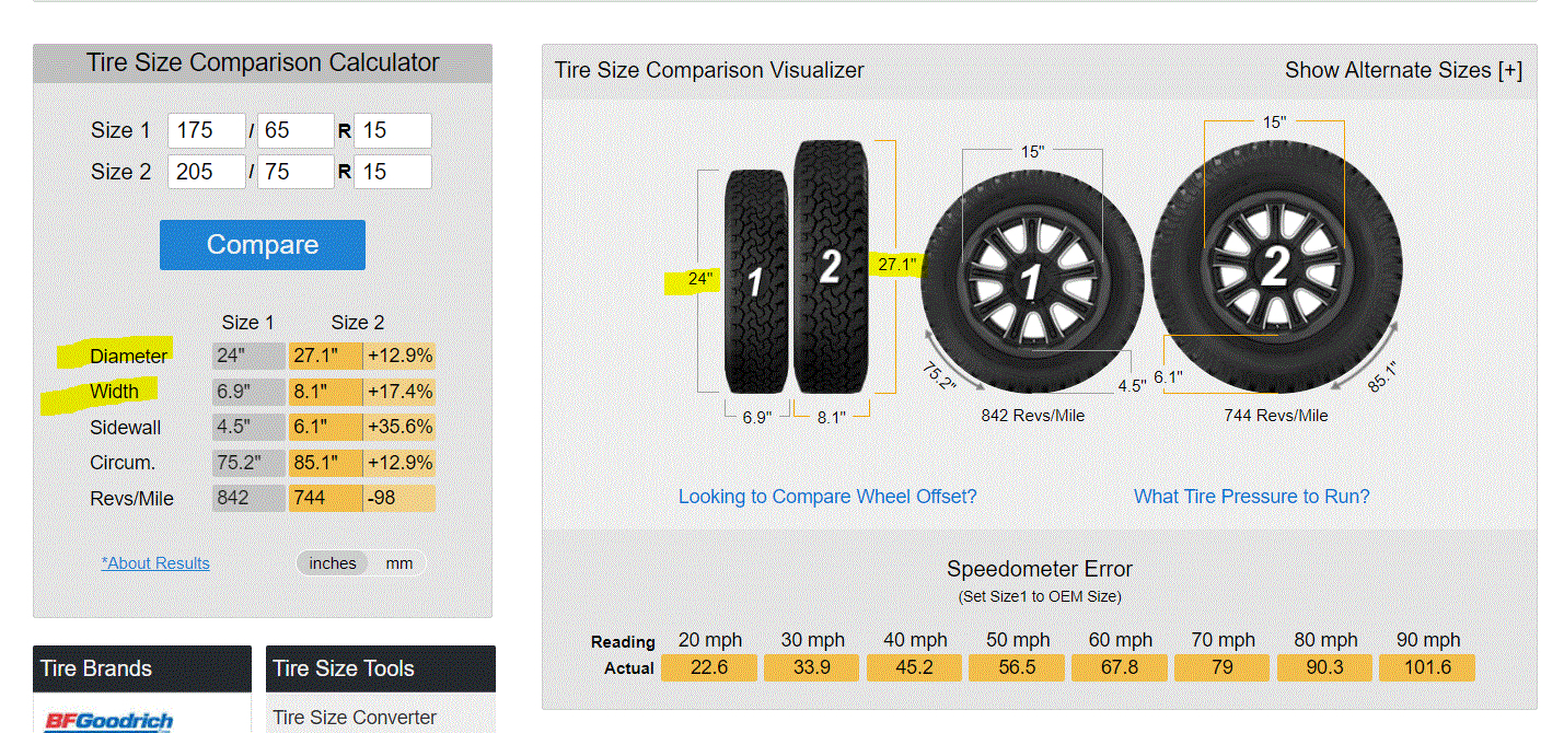

I'll have to verify this when I go outside tomorrow when it's not too dark to see but a basic search says 175/65R15 and if this helps this is the leveling kit I've found, also don't worry I have someone who is actually very good at this sort of stuff helping. Just trying to do my own research to help him. https://www.journeysoffroad.com/mini-cooper-lift-kit.html

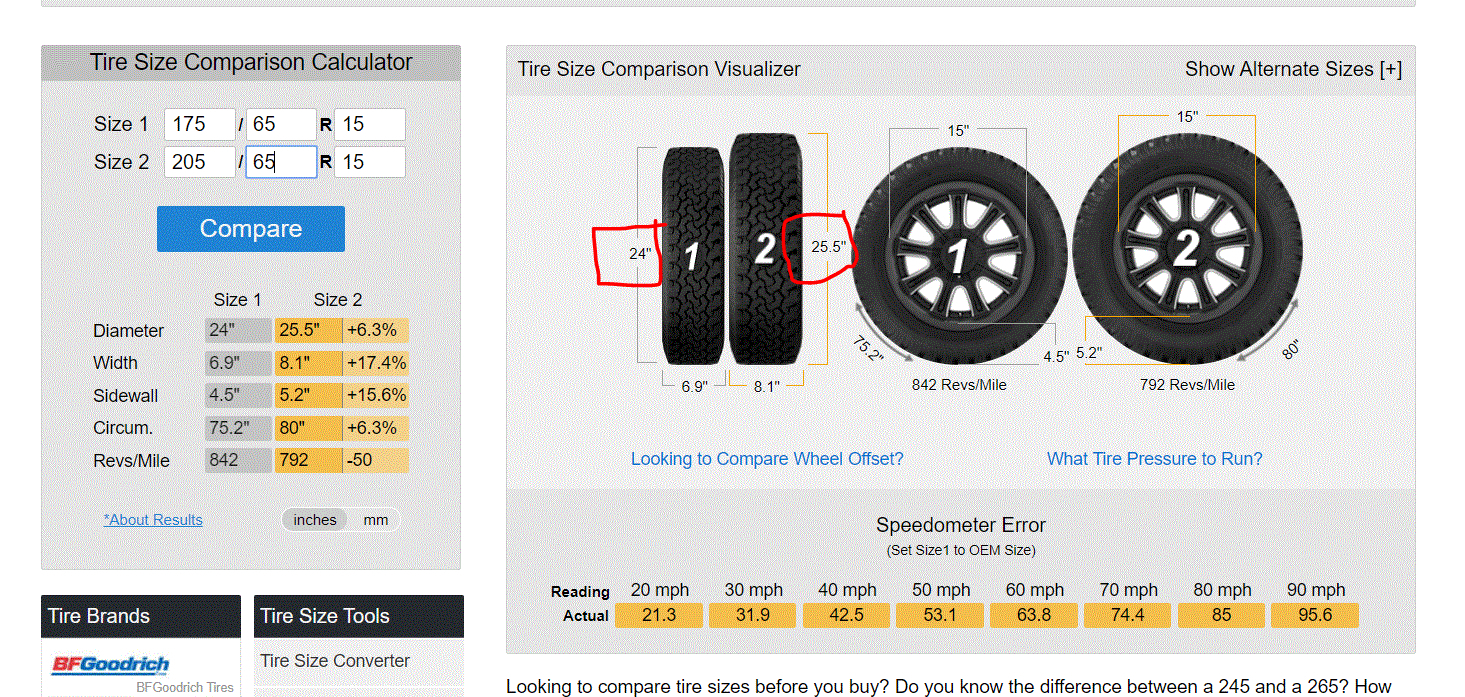

Tony, it's no problem at all. I have to be honest, if it is a 2" lift, you have some room to work. The only concern is I wouldn't go too much wider. Basically, the 175 you indicated is directly related to height, even though the second number (65) will play a role.
Don't laugh, but you should have 2 extra inches to work with. My biggest concern isn't necessarily the height but if a larger tire will hit the inner fender or fender itself when turning. So be aware of that. Now, when I try to determine tire size variance, there is a site I use that shows a side by side comparison of tires sizes. What I want you to try is this. Place the OEM tire size in tire size 1. Then start changing the 2nd size until you see an overall diameter that you feel will fit. For example, compare a 175/65/15 to a 205/65/15. The site will actually tell you how the size difference affects even the rotations of the tire per mile. Please keep in mind, using a larger tire will change the accuracy of the speedometer.
Try it and let me know what you think. Let me know the sizes you feel could work and I'll look compare them and tell you my opinion.
Here is the link. I've used the site a number of times when people want to go larger when ordering tires. It never failed me. LOL
https://tiresize.com/comparison/

The 235/75/15 is nearly 5 inches bigger in diameter. That will likely be too much. Additionally, going from a 65 series to a 75 series will cause the tire itself to be much narrower. If you look at a 205/65/15 it stands 1.5" higher, which should work. Plus the (65) series, so the width won't get too narrow. Actually, it gets slightly over an inch wider, which you may have to try first, but would look good on the car if it fits.

I'll look that up, for some reason that size isn't on the site I'm looking at, the closest is 205/75/15. Just going to chalk it up to ignorance, but what is the difference?
Apr 18, 2020 at 3:44 PM
  • 110,244 POSTS
A 205/75/15 will be taller. Actually, it's 3.1" taller than the OEM size, which is more than the lift. Take a look at the two pics I attached to show height differences between the one you mentioned and the one I mentioned.
Apr 18, 2020 at 3:49 PM
