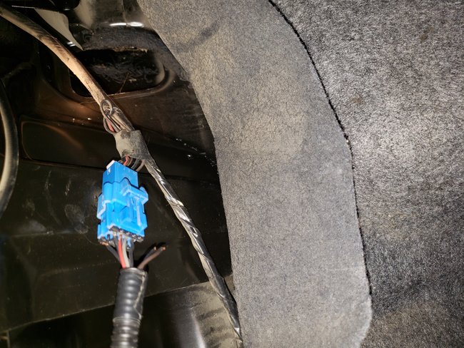

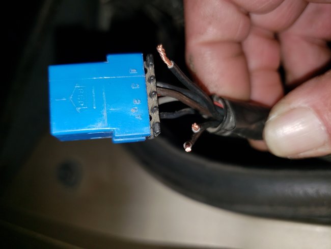

Found this connector (driver side) in the trunk, three wires (two black, brown) are broken off.
Please Help, I have no idea what goes where!

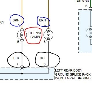

You found the reason the license plate lights don't work. I have to ask you a favor. Can you take a picture of the wires in questions and upload them for me to see exactly what you are dealing with? The brown wire should have power to it when the parking lights or head lights are on. If you could check that for me it would be very helpful. The black wires should be grounds for the lights in question.

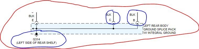

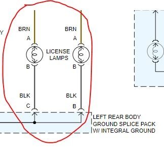

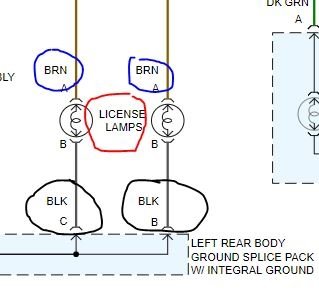

Now, I attached three pictures for you to look at. These are portions of the wiring schematic for your vehicle. I circled everything that relates to what you are dealing with. As you will see, power is supplied via the brown wire and ground is supplied via the black. Take a look at them.

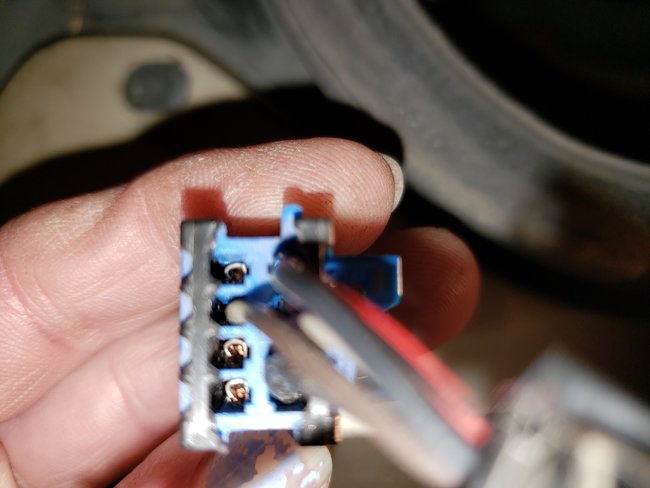

Next, if you found a broken wire, there should be two sides to it. Is that correct? If it is, chances are you will have to do nothing more than rejoin the wires to the correct colors. Again, worst case is you blow a fuse. There are a couple ways to fix the wiring, but the easiest way is to simply use a butt connector. Take a look at picture 4.
I placed two sad looking arrows toward where the two wires enter. You simply remove a small amount of the insulation from the wire (approximately 1/2"), push the wire into the end of the connector, and crimp it with pliers. Just make sure it is tight and can't come out.
Also, the connectors come in different sizes. The picture I attached shows a yellow one which will be too big inside to work for these wires. Most likely, you will need red or even blue.

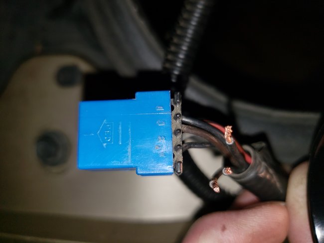

Thank you for responding, I'm uploading (hopefully) pictures of what's happening.

I just noticed that on the female end it has letters A=brown B=black C=brown D=black so that tells me where the loose brown wire goes (A=brown because C=brown is still attached). You said the two black wires are ground? So can I put either one in B=black and D=black?
Also, how do I stick them back in or do I need to do something else?

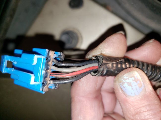

I'm sorry, I should've said the letter's A B C D are on both (male and female) ends of the connector.

All you have to do is identify (on the opposite plug) where those wires go to. Then, just use the butt connectors to put those two wires together.
