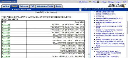

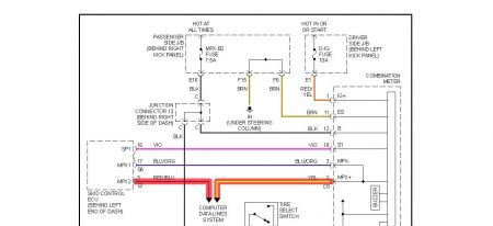

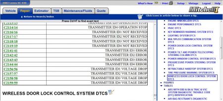

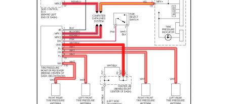

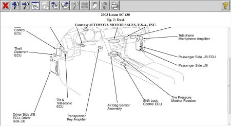

My car has Michellin run-flat tires (PS2). I am getting a tire pressure warning lamp (steady on, no chimes) that would normally indicate low pressure. All tires are at exact correct pressure. I suspect that one of the tire pressure sensors may be defective or some other part of the system. How might I trouble shoot this problem? Do the sensors have a battery that needs to be replaced? How does one replace a sensor and then reset the system? Thanks.
Jun 16, 2010 at 2:32 PM
  • 75,992 POSTS
Hi Lexman01, Welcome to 2carpros and TY for the donation Probable causes here could be the tire pressure monitoring receiver,tire antennas -you need to scan the computer for codes
