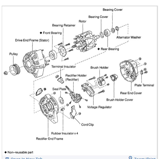

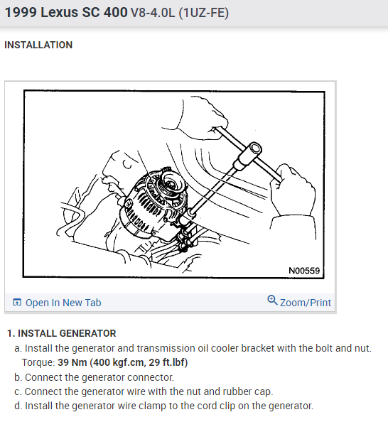

With the AC on the battery discharge light comes intermittently and when it does the battery charge drains. Also, with the AC on the car idles at 500rpm and with the the AC off the car idles at 650rpm shouldn't it be the opposite.
Thanks
Jul 28, 2009 at 12:08 AM
SQM
  • 6,383 POSTS
First you need to get the alternator tested, as when the battery light comes on it mean that the battery is not getting sufficiently charged.
It could be due to the idle speed drooping below recommended level but then again you could have an issue with the voltage regulator in the alternator, which is unable to support the extra load when you turn on the A/C.
