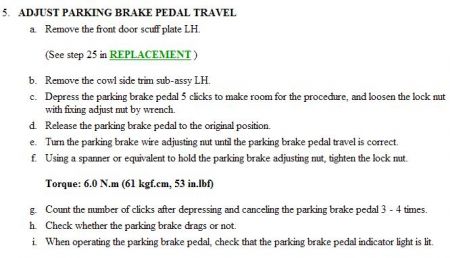

2005 Lexus RX 330 Emergency Brake Adjustmnent
125,000 MILES • 6 CYL • AWD • AUTOMATIC
MWS123

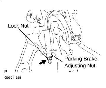

how do I adjust the emergency brake? The EB pedal has excessive play in it and practically goes all the way to the floor. We recently had the brakes done on it but I don't think the dealership remembered to adjust it during the service. Where is the adjustment point on the cable? In the cabin, in the engine compartment or under the vehicle?
thanks

Hi there, See text for adjustment & location. Mark (mhpautos)
