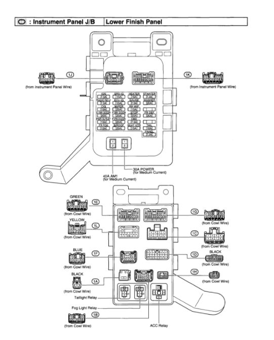

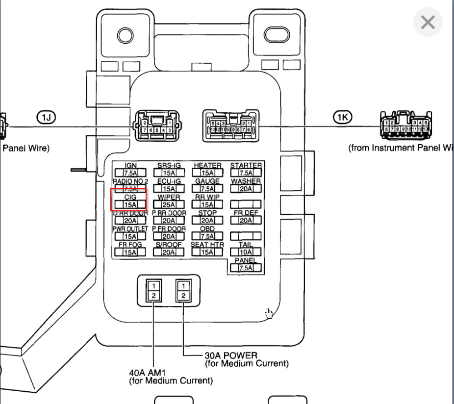

Do you know where the fuse for the cigarette lighter is located?
Aug 12, 2008 at 8:24 AM

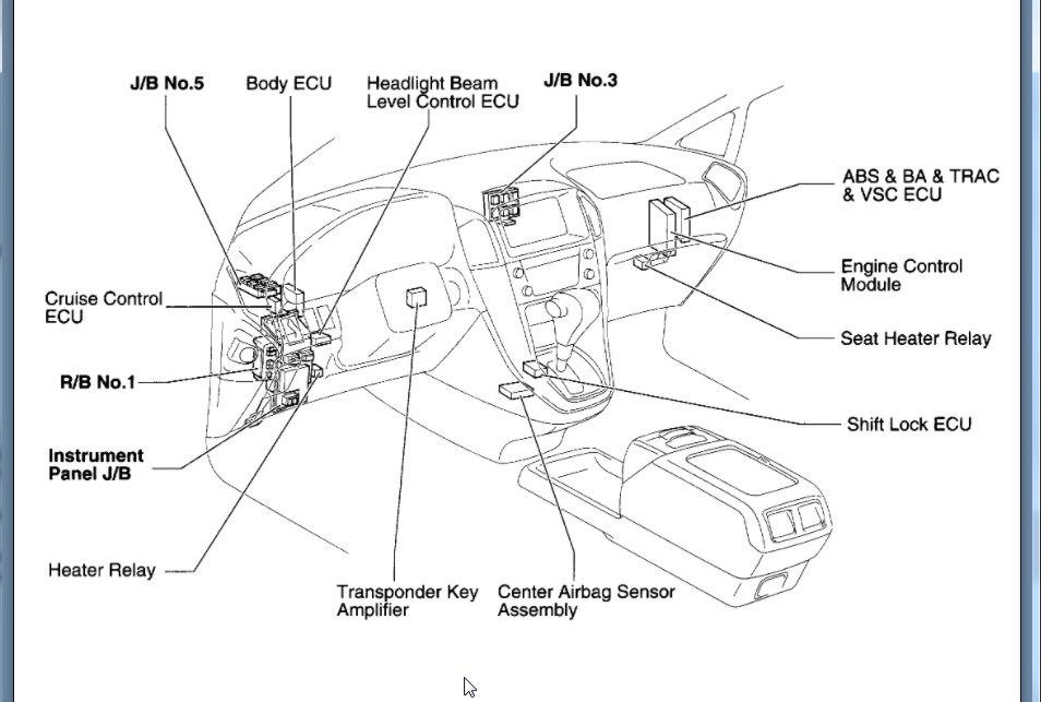

I am attaching the fuse block and showing the location in a red circle. It is located in the instrument panel fuse block so just review this material and let me know if you have other questions.
Here is a guide on how to test and replace a fuse in case you need this:
Thanks
