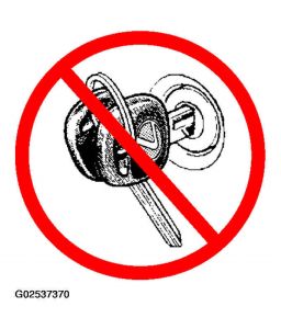

I looked up service bultein and did not find any in reference to resetting the ignition. I did find that the key has a computer chip in it that locks the ignition system of the vehicle. try using the key with out any other keys around.
https://images.2carpros.com/forum/automotive_pictures/54223_hs_1.jpg
