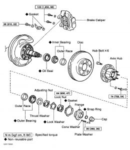

hosw do i remove hubs to change rotor

Shouldnt have to remove the hubs to get therotors off that vehicle. There should be 2 phillips head screws holding the rotor on the hub.The screws usually require an impact driver to get them looe, then the rotors come off

nope, there are 8 bolts with lock washer type cones, i had to get a piece of brass to pound with so I would'nt ruin threads, then there are 8 more bolts holding hub to rotor, then you can removr the rotor, the 450 XL is all wheele drive.

My bad, sorry about that.Here is an exploded view of the front hub assembly, hope it helps.
