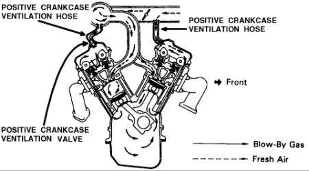

A few days ago I start noticing that the idle of the car is not the same as when I bought it. My friends told me that it had something to do with my PCV valve. I already bought a new PCV valve but now I have a new problem, I can’t find where it soppose to go. Can you help me?

The Positive Crankcase Ventilation Valve is located in the rear valve cover below the Data Link Connector 1.
