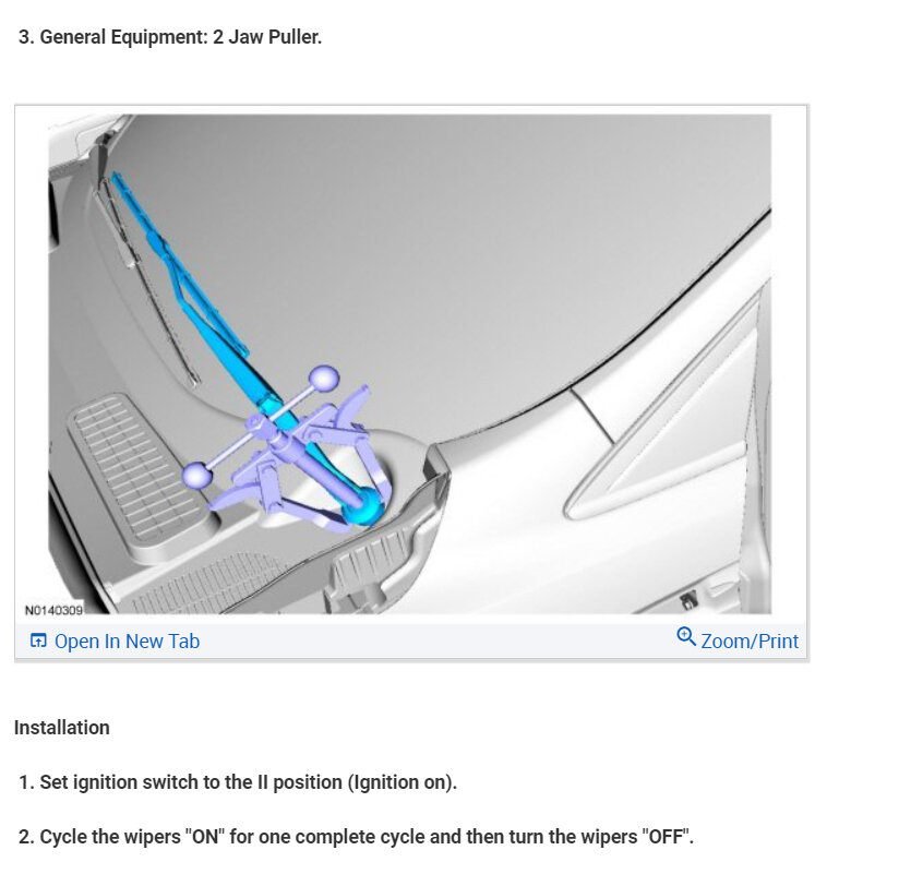

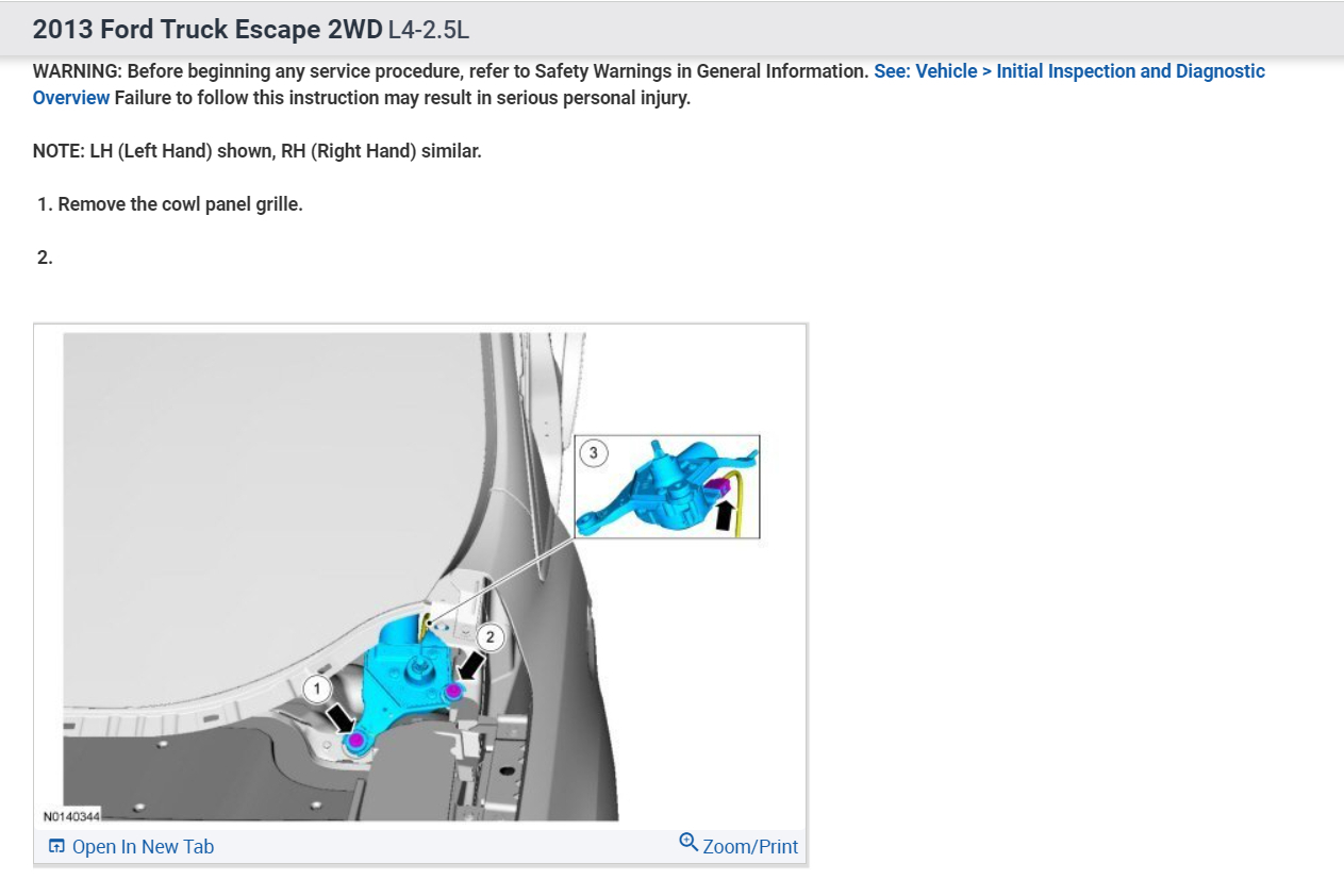

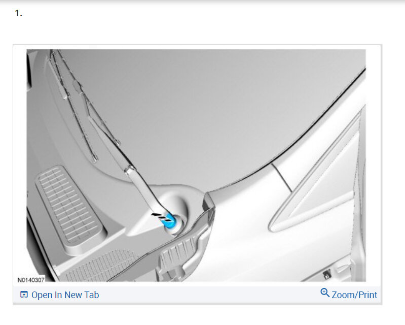

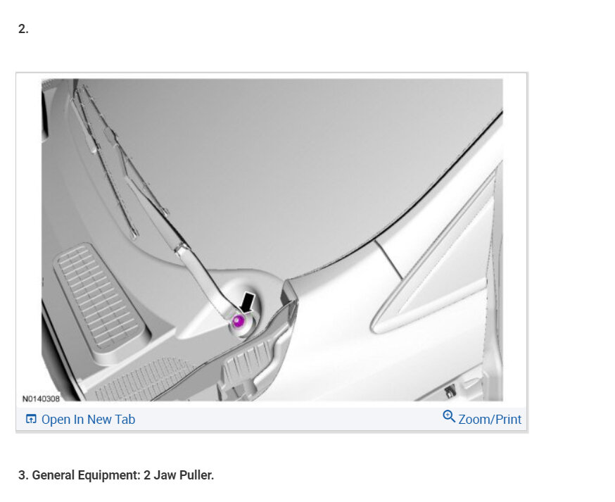

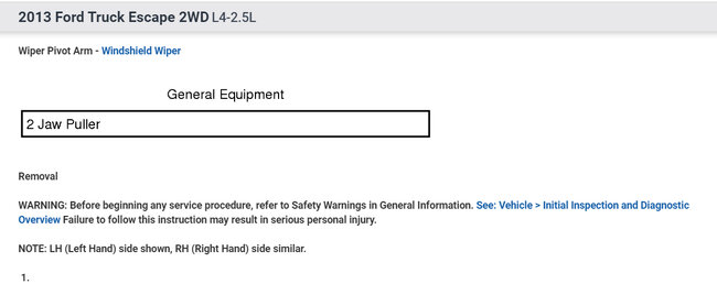

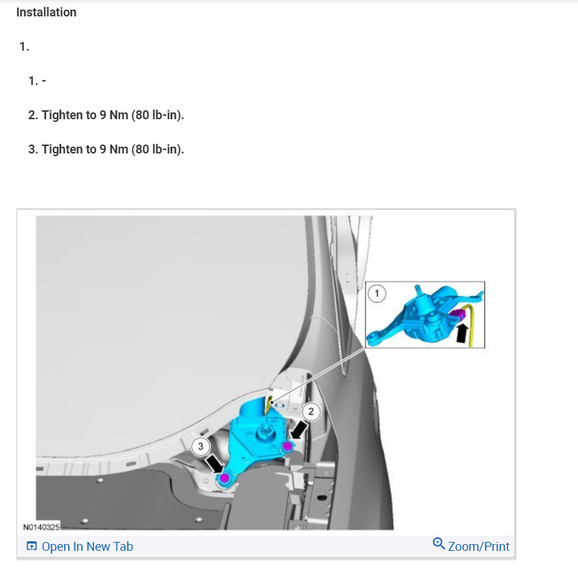

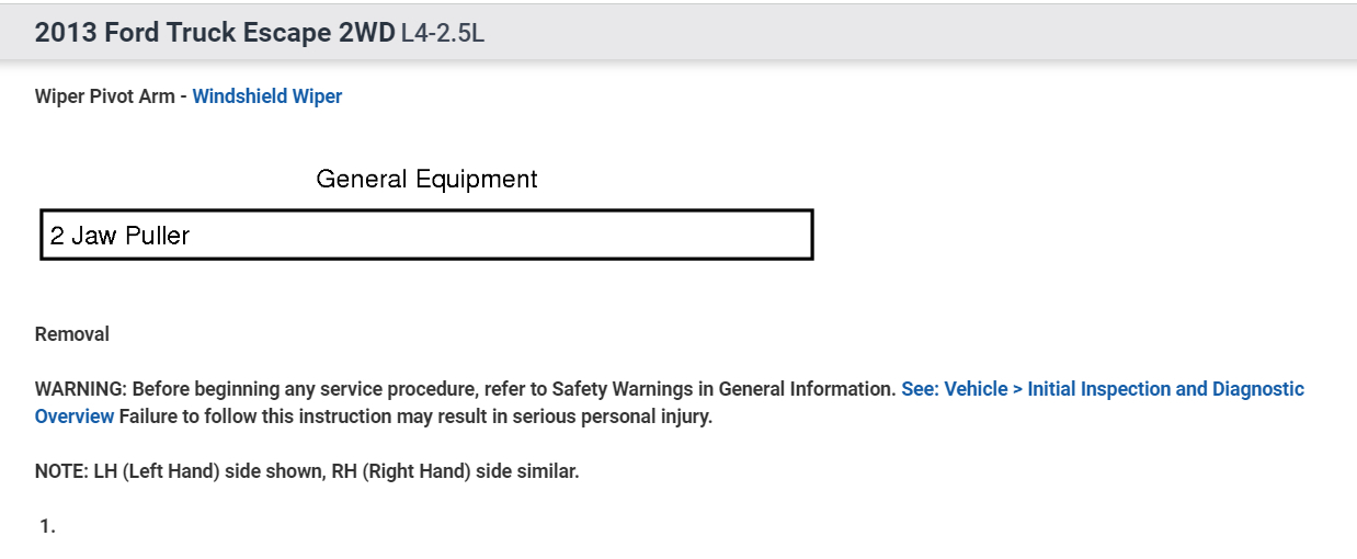

There is only one wiper motor so if one works the problem is the wiper arm pivot. here is how to check for the problem in the images below. Let us know what happens and please upload pictures or videos of the problem.
Jan 5, 2023 at 3:34 AM

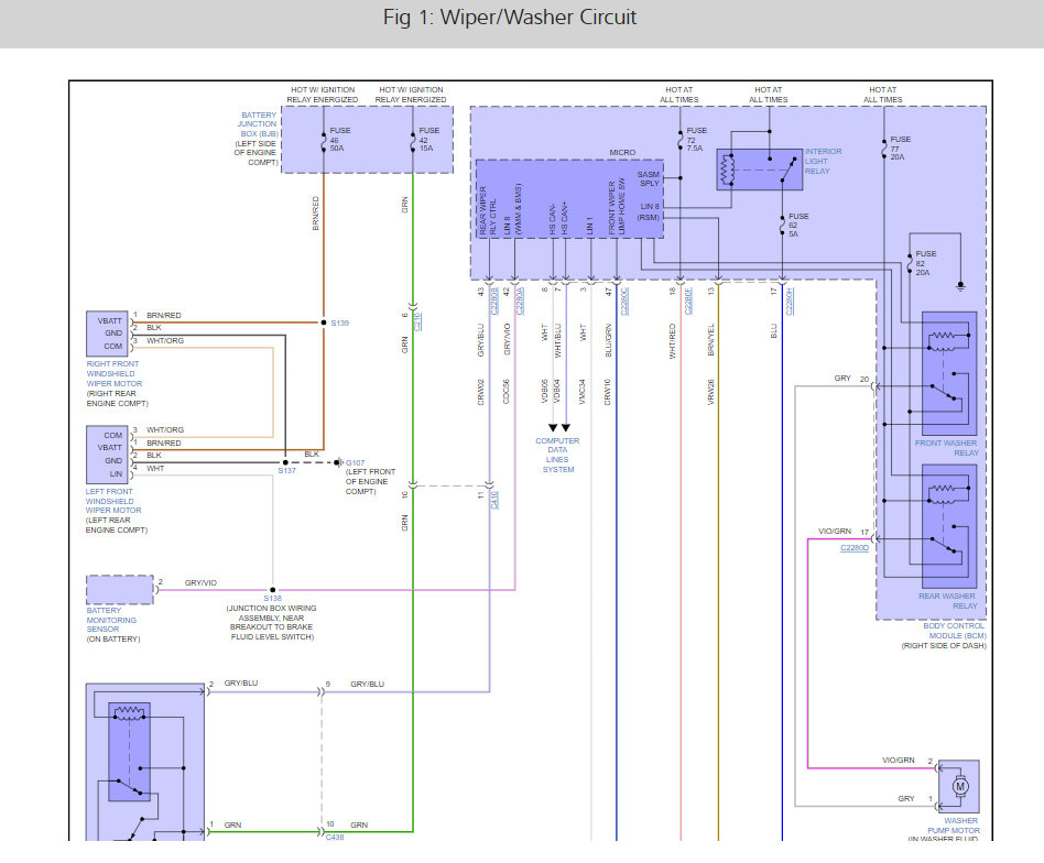

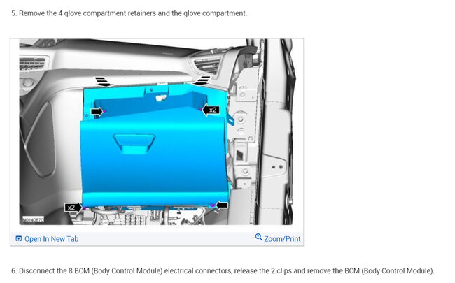

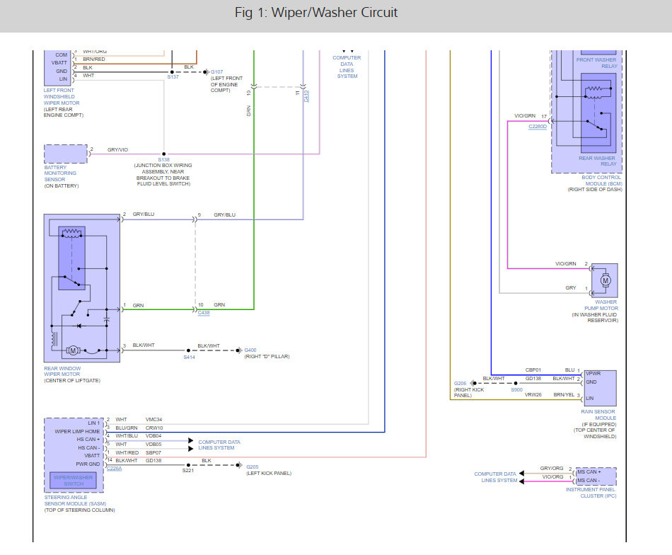

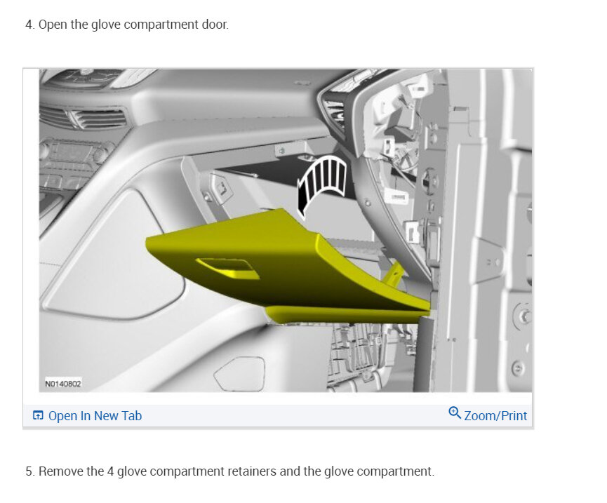

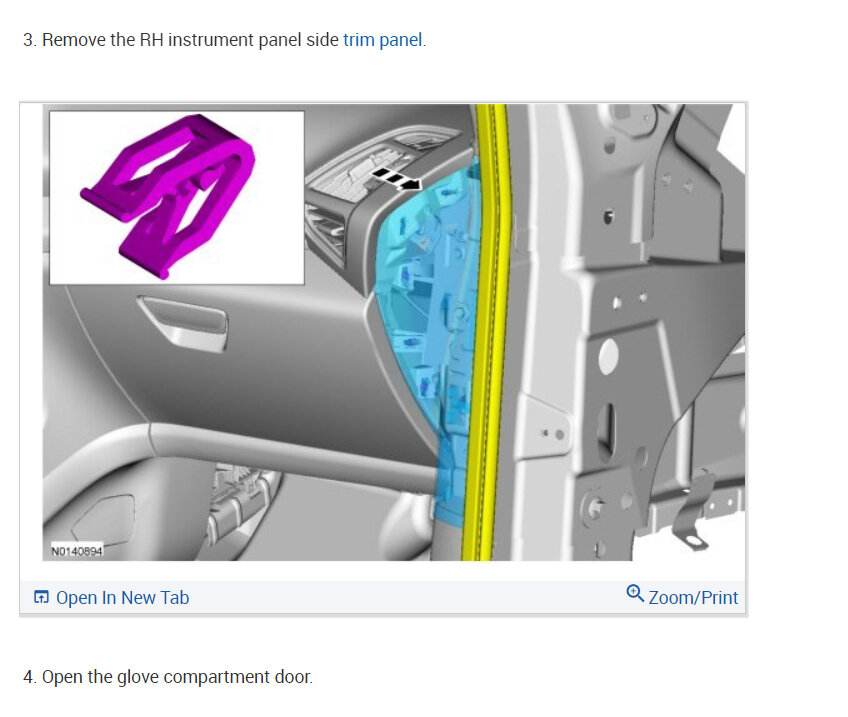

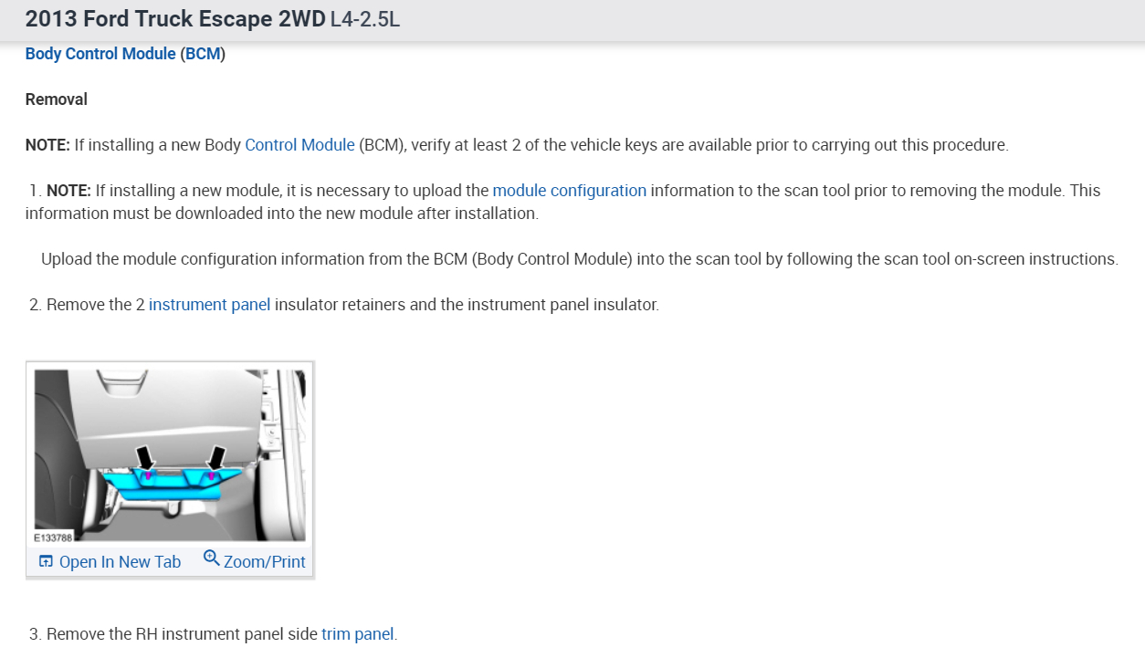

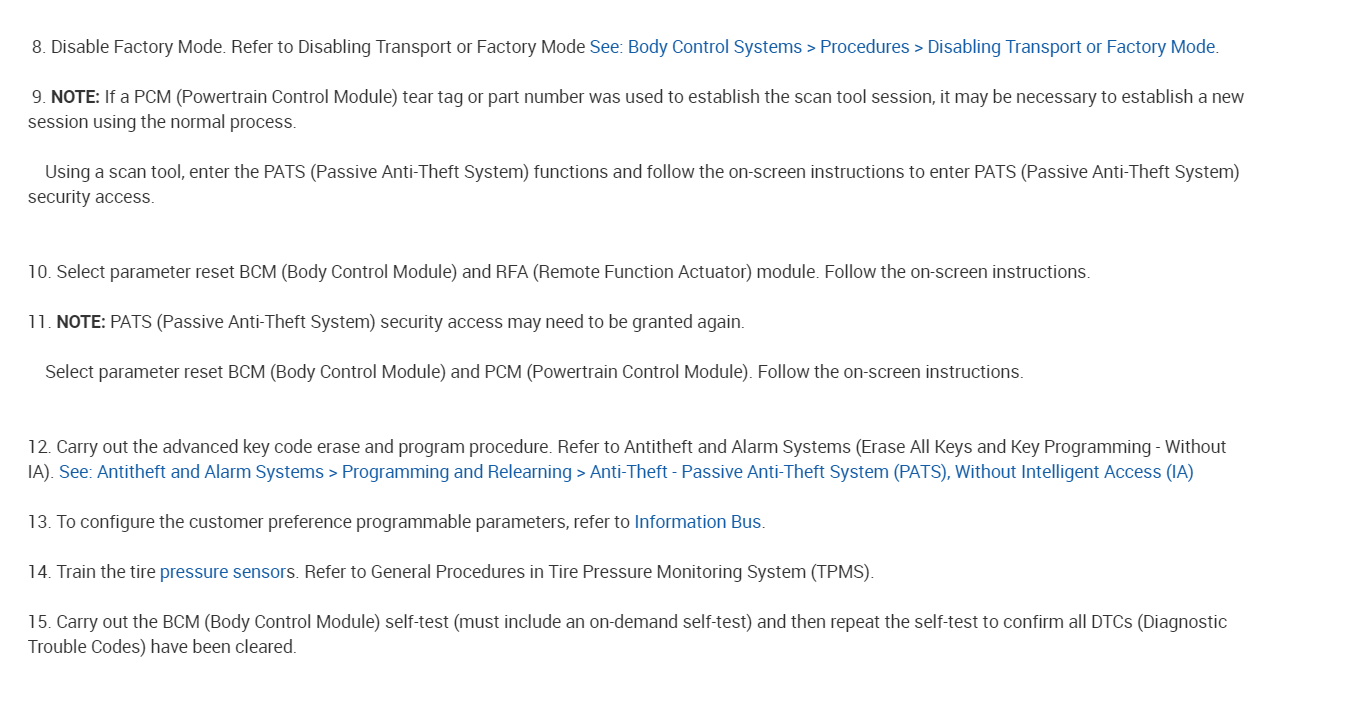

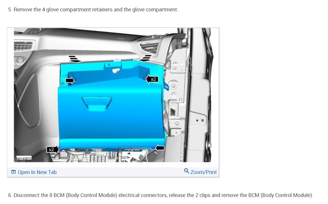

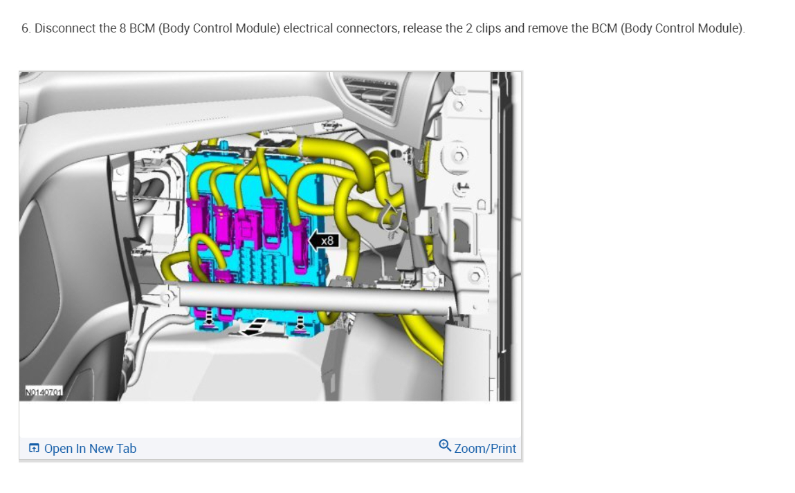

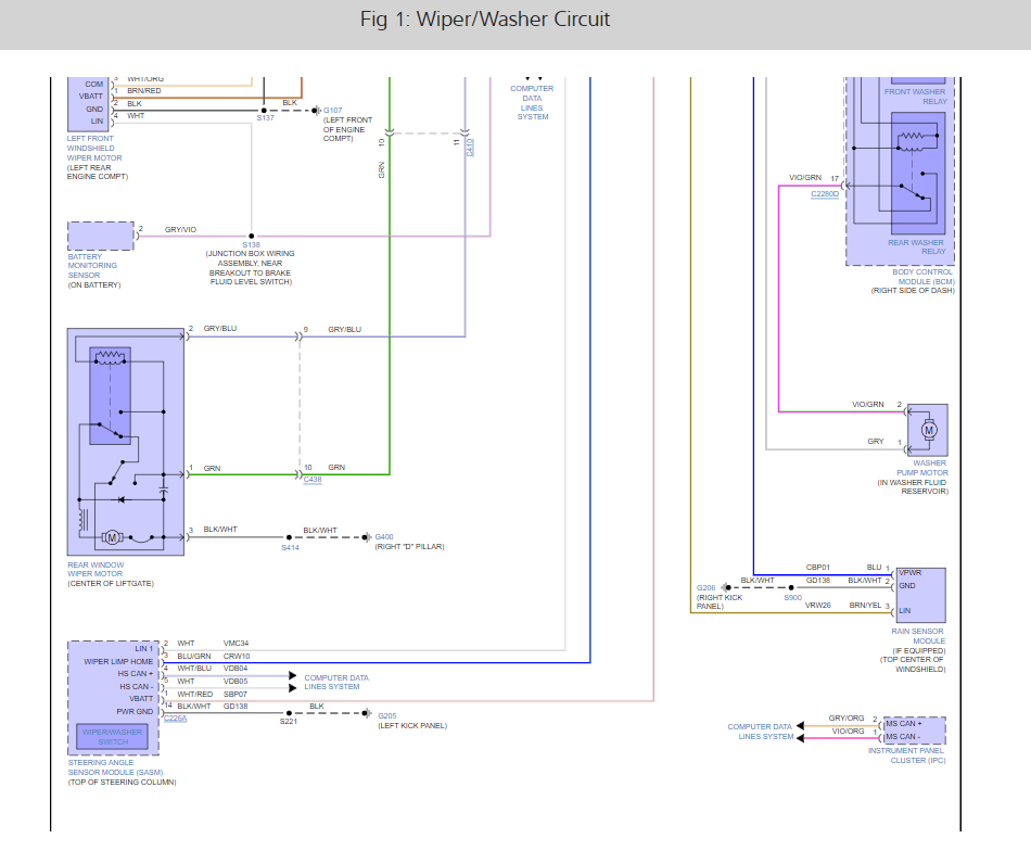

Yep, my bad, I should have looked, something new, both wiper motors share the same ground and power supply that leaves the BCM being out but to be sure we should do a CAN scan, you can get a CAN scanner (Controller Area Network) from Amazon from about $32.00.
https://youtu.be/u-4syLc-ifQ
and
Amazon CAN scanner Link.
https://amzn.to/3G7mpFP

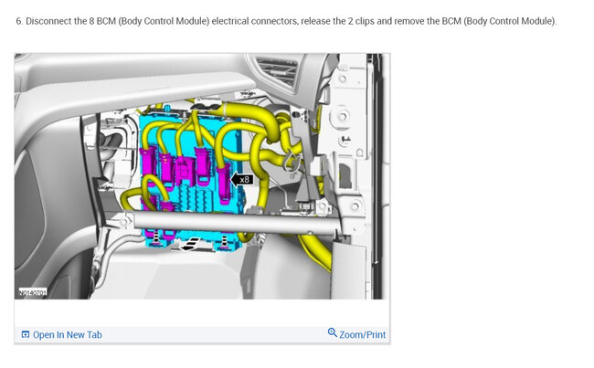

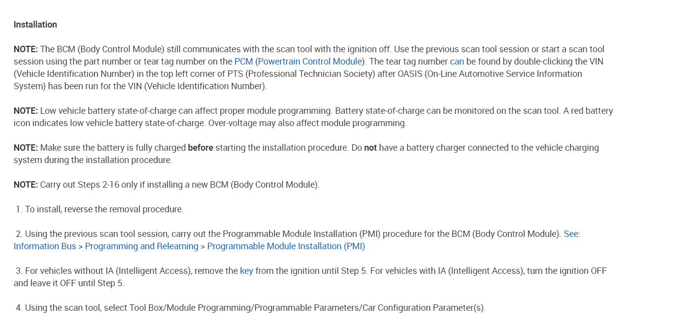

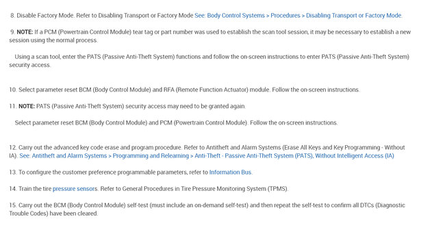

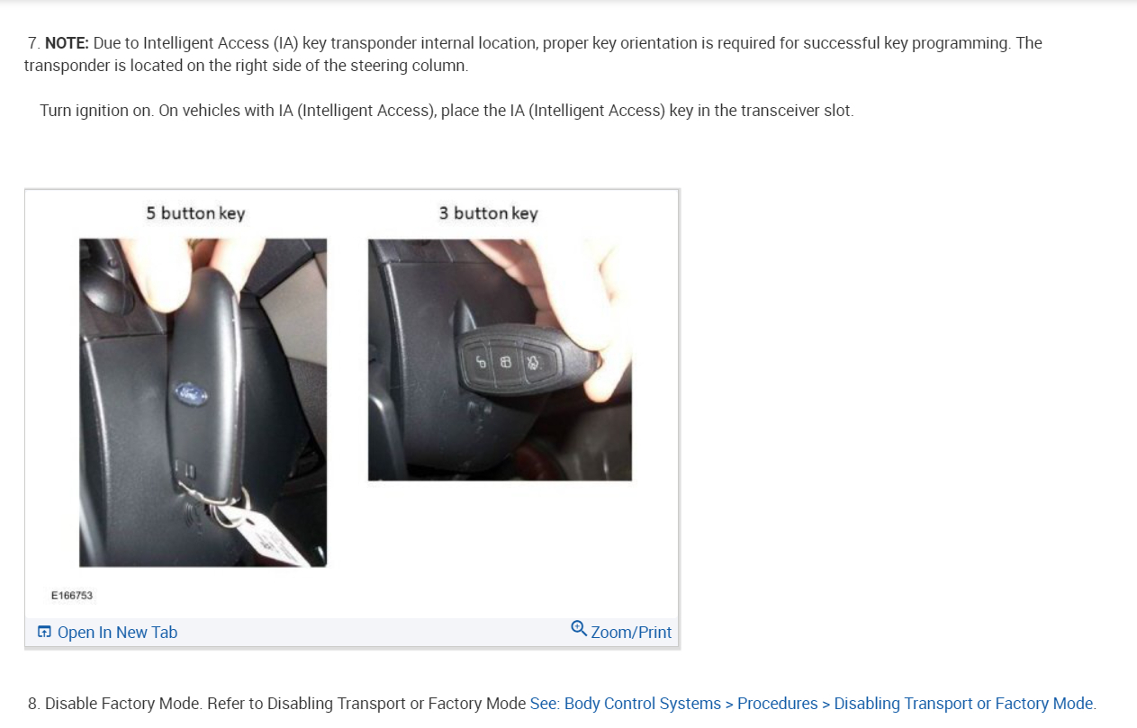

Here are the wiper wiring diagrams so you can see how they work and how to replace the BCM in case you need it. I would get a rebuilt BCM so it will come preprogrammed, you can search google or eBay. Check out the images (below). Please let us know what you find. We are interested to see what it is.
