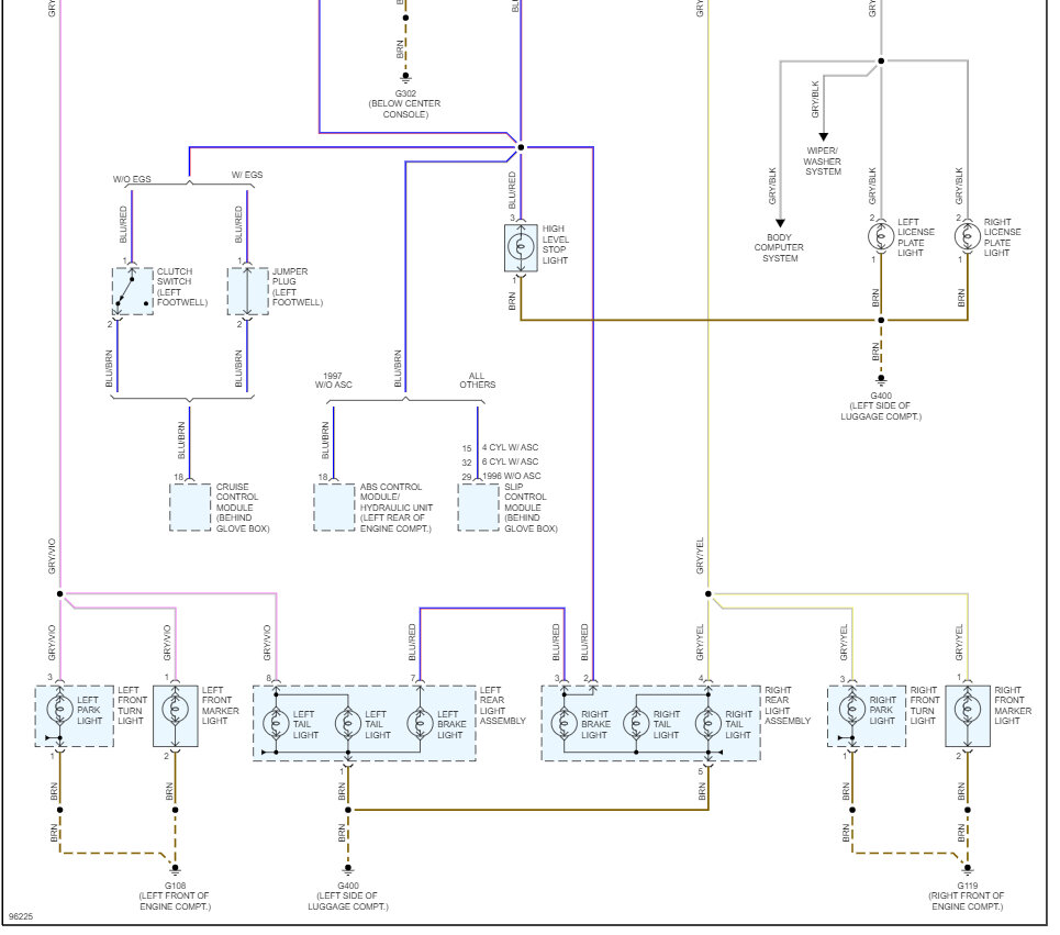

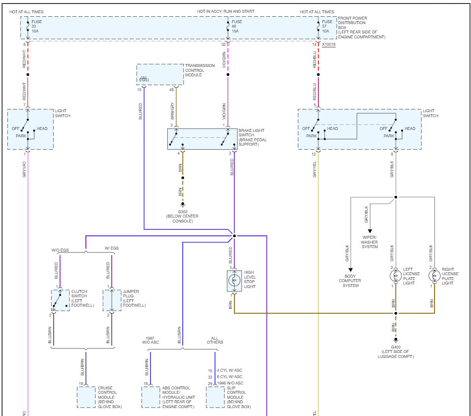

Front/rear left side parking lights and front left corner lights don't work. All fuses tested. swapped fuses 33 and 37 (left and right-side parking lights for) no change. Is there a separate relay for parking lights? American market car. Could headlight switch be the culprit? Flasher's work. Bulbs all checked and good.

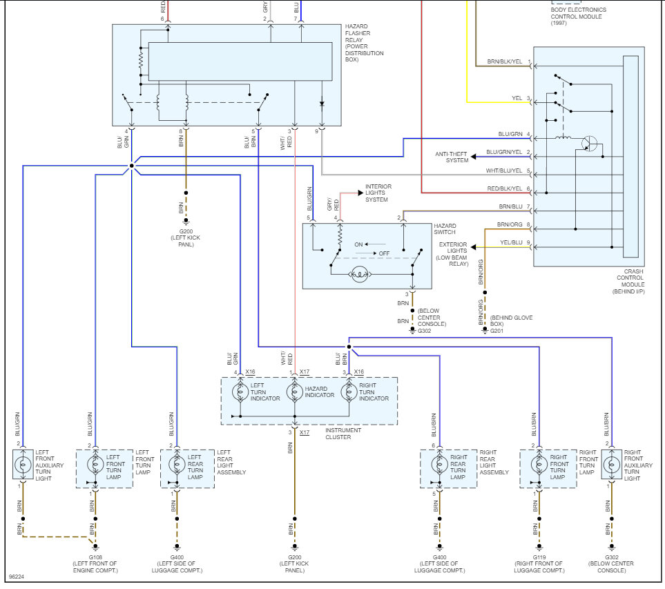

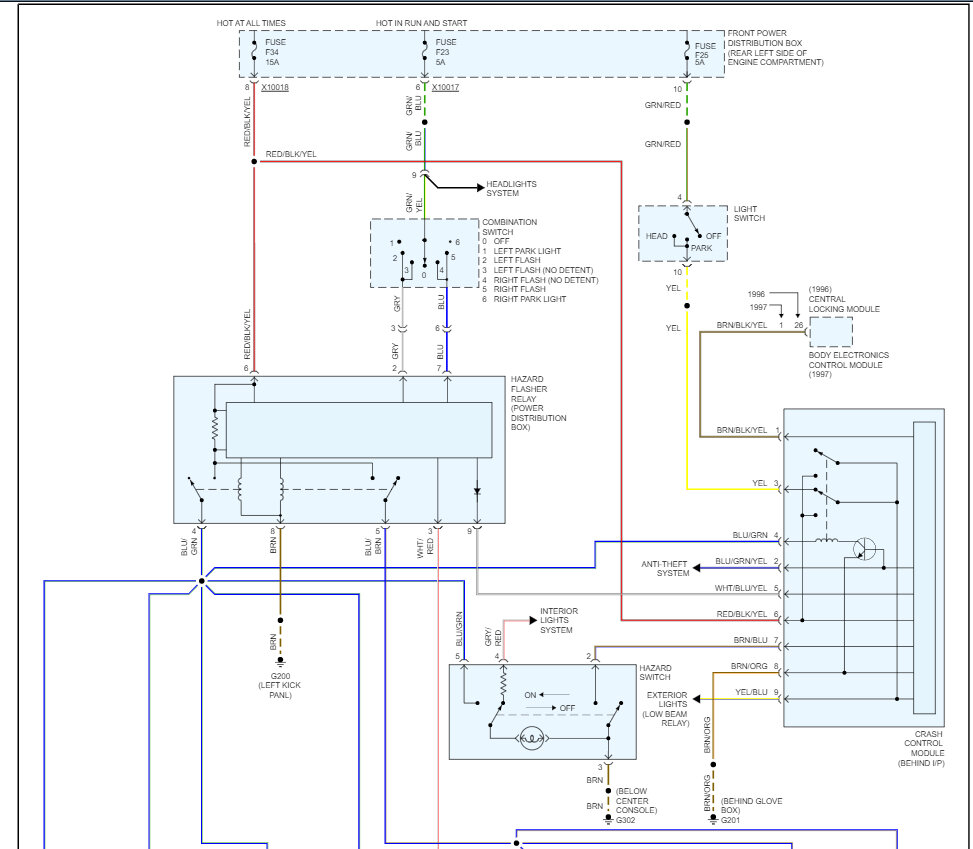

It could be the switch, or you don't have power at a fuse, this guide can help you check for power to see where you are losing it at. Also, I have included the turn signal wiring diagrams below.
