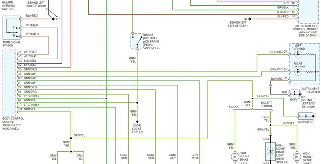

Turn signal activates both directions, but the opposite side is much weaker.
So, I turn on the left turn signal, both the left and right flash, but the right is much dimmer. The indicator arrows do the same. If I turn on the right signal the same thing happens. left also activates but is much dimmer.

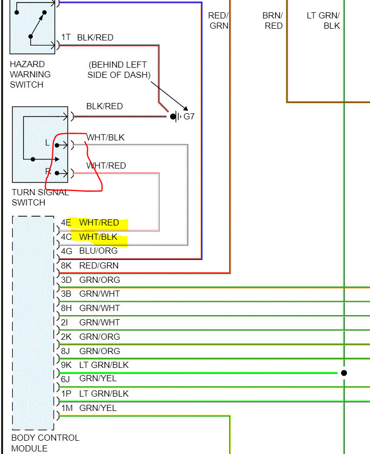

My first thought is there is a weak ground, but considering all lights have their own ground, that is unlikely. The next thing is the wiring between the switch and the body control module. The wires are very close together and may have shorted together. I attached a pic below. What I would suggest is to check for power at the switch wiring. See if there is power out of the black/white wire when you turn the left on and the white/red when turning left.
Try that and let me know what you find.

Using a test light, I got no power from either of those wires. I probed the wires as the switch and at the BCM. Same result.

There is no power to those wires, they provide a ground to either the left or right input for the body control module. If you use the test light connected to a good ground and probe the wires at the BCM with the turn and hazard switches disconnected, the White with black stripe should turn on the left signals. Probe the white with red wire the right turn signal should come on. Then probing the blue wire with orange stripe turns on the hazard lights.

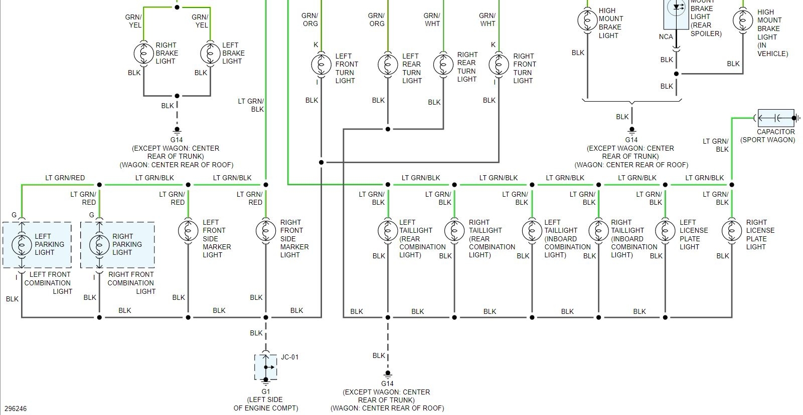

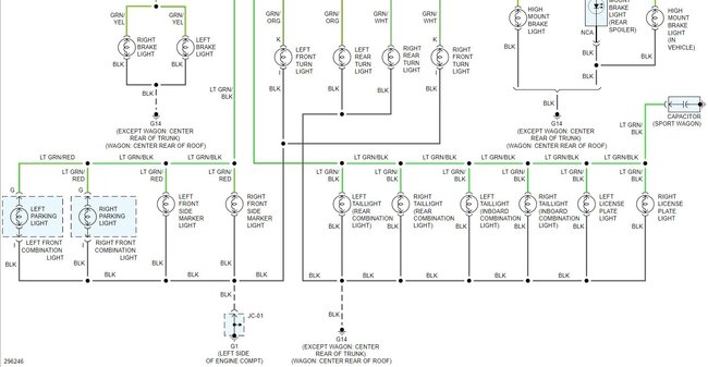

However I think you have a ground issue, looking at the wiring the left and right fronts share a ground, and the rears both share a ground, it's possible a bad bulb or poor ground is causing this.
This car is stock correct no LED conversion bulbs or anything like that? I have seen those cause issues like this when the diodes fail.

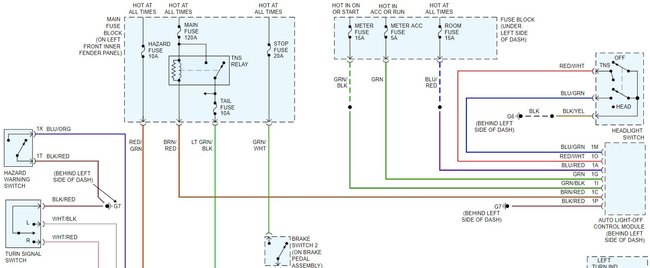

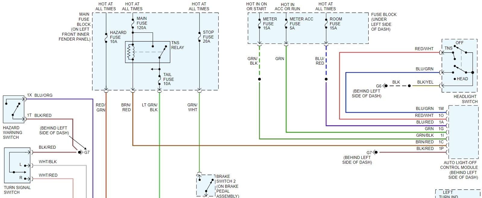

Checking if it's a ground is simple. Go to either corner and run a jumper wire from the black wire on the light to a good ground. If the lights return to normal remove one or the other to see which circuit is feeding back through the BCM. I added the wiring in 3 parts, splice them together and you have the full diagram.

I grounded out all 4 turn signal bulbs, and the behavior of the turn signals does not change. I am about to replace the BCM. Does it make sense to do that?
