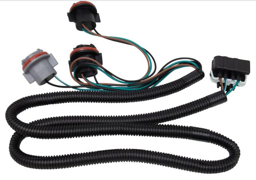

It sounds like you might be having an issue with the wiring harness itself.Have you noticed if on any side that any of the bulb sockets appear to be burnt or melted? Had a friends Suburban with this problem but kept blowing brake light bulbs until I replaced harness.Yours might have a short in the wiring.They are about $30.00. I've attached a picture below of the harness for your attention but I think this is the right side.It's very easy to replace.Keep us updated.Hope this helps and thanks again for using 2CarPros.
