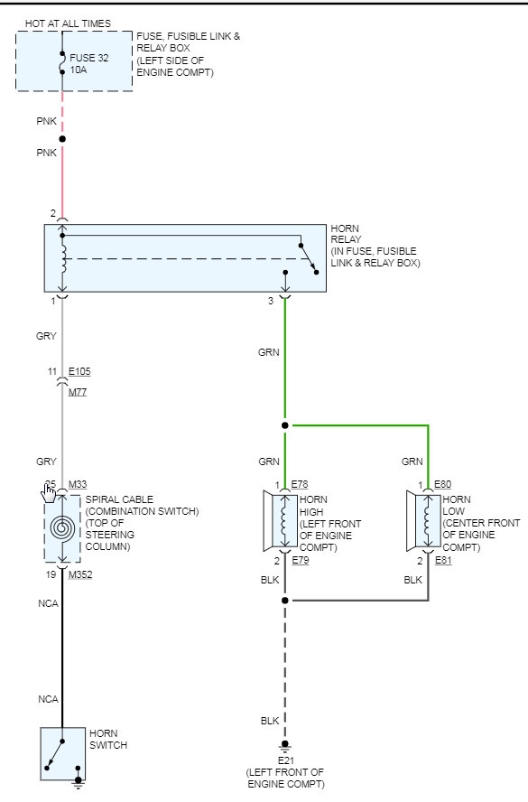

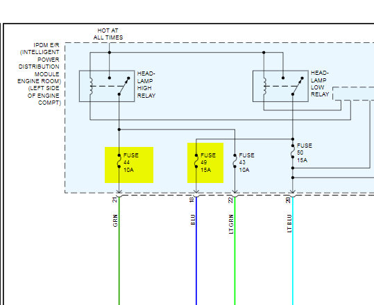

The left side of my car has been giving issues. First my left front blinker went out and so did my horn, so I changed the blinker and things we're fine, my horn worked too. The horn then went back out a day later but my blinker was fine. I decided to wait on fixing my horn but my headlight has gone out now. So same deal I got a bulb and replaced it. didn't work. Checked the fuses. they're fine. I made an appointment to take it in, but is it possible these are related?

Unfortunately there is not much relation between the horn and the lights. The issue with the lights at this point could be your integrated power module as each of the fuses come from this module. They would need to test to see if there is power coming out of the fuse and if not and the fuse is okay, the circuit board on this module is most likely the issue.
As for the horn, more than likely that this is either a fuse/relay or the steering column clock spring.
Obviously, if you are taking this in, then we can let them do the testing but if you want more information here is a link to information about a clock spring:
https://www.2carpros.com/articles/symptoms-of-a-bad-airbag-clock-spring
