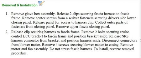

my blower to my air and heat has not been working right, they have 4 resistors in the motor area/fuse box that controls these 2 for defrost and 2 for air, for some reason it is over heading the resistors and burning them out, I can buy new ones and the system works perfect, but once they are in there a day or so they burn out.

Hi there,
I would have the blower motor checked out as it my be over loading the system and causing this problem, how is the motor on low speed are the revs smooth and even or dose it tend to labour a bit?

the work smooth that is what is strange, do you know where the blower motors are located , im pretty savy working on vehicles, ran a body shop for 25 years, most of the work on it ive done myself.

Blower motor removal.
https://images.2carpros.com/forum/automotive_pictures/61395_rover_1.jpg
