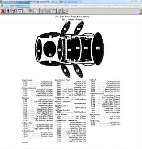

We removed the fenders to perform some body work. In removing the fenders, I had to remove some wiring - also removed the coil wiring under the hood. We put it all back together, I re-wired the coil, so I now have a spark, but the engine won't start - I can't remember where the grounds were when I started. Can anyone tell me where to ground my rover so it'll start for me?!

I am very sorry that it has taken this long to get your question answered. From the infromation you have given I hope this helps. If you need anymore diagrams let me know
https://images.2carpros.com/forum/automotive_pictures/170656_ground_1.jpg
