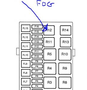

My 2004 Disco never had fog lights, but after a fender bender, I decided to upgrade the front bumper with the fog light holes, original fog lights including the front fog light switch (YUG000720PUY) and I had to replace the rear fog light switch (YUE000290PUY) with a new one (YUE000300PUY) even if I don't have the rear fog lights.
Besides checking the fuse I really don't know what more there is to do to make my lights work.
Appreciate any guidance

i think that there will be a missing relay, i will see what i can find out.
Mark (mhpautos)

Check that relay R12 is installed and working.
https://images.2carpros.com/forum/automotive_pictures/61395_Capture_3.jpg
Mark (mhpautos)

Relay 12 was missing, so I removed relay 11 that had a "snow flake" looking picture from the diagram at the fuse/relay box cover, so I insertted the relay to location 12, but no luck.
I followed the owners manual that states that to use the fog lights, the main headlights must be ON.
Question 1.
Is relay 11 the same type that works in slot 12?
Question 2.
Someone mentioned that the BCU (computer) in the car must be activated by the dealer, so the fog lights can work... Is that true?
Thanks.
Juan

That relay is for the A/C compressor and should be the same, i doubt that there is any factory re set for the lights, i see nothing in the data base, but a call to a dealer will confirm this, and did you actually check for power at fuse 3 (fog lamps front)?
Mark
