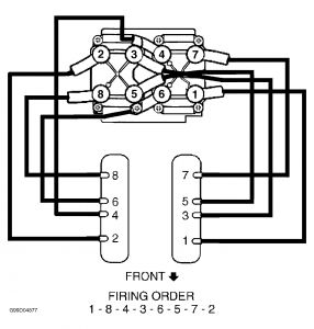

I need the wiring diagram for the plug wires.

https://www.2carpros.com/forum/automotive_pictures/266999_land_31.jpg

The two coil has been changed yet two plug from the drivers side did not fire and the two plugs from owner side did not fire.
Saturday, December 12th, 2020 AT 5:36 AM
ABDULSALAMI EGANYI IBRAHIM
Please what can I do to rectify the situation? The model of the vehicle is 2002 Land Rover discovery.
+1
Saturday, December 12th, 2020 AT 5:37 AM
4DRTOM
  • 467 POSTS
If you have replaced both coils and your not getting spark out of part of both of them assuming that the wires and plugs are good you need to check for corrosion in the plug connections for the coils and verify that they both are grounded properly. It sounds to me like its the latter and your ground isn't connected. If I remember properly that vehicle has ground straps that go from one of the mounting bolts of each coil pack to the block.
