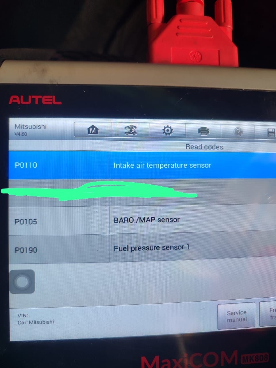

Hey, I scanned the car however it said the fuel pressure sensor has failed . I don’t know where is my fuel pressure sensor and why would my neutral light blinks when I’m in drive gear can a fuel pressure sensor makes the neutral light blinks in drive gear. how do I go about fixing this I replaced my gdi pump already new head and block new transmission.

So, the codes that came in the scanner are.
Po110 intake air temperature sensor
Po105 baro/map sensor
Po110 fuel pressure sensor 1
What can I do to fix this also can this make my car in limp mode? And neutral light while in drive gear.

  • 110,194 POSTS
It sounds like you are on the right track. However, since I don't have specifics on the vehicle, that information isn't available to me. I hope you understand.
