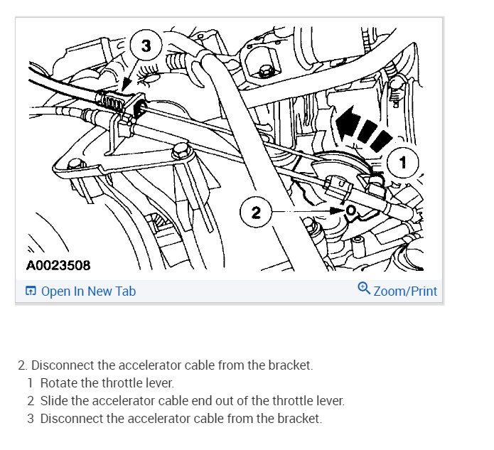

The car starts with a low idle. Give it acceleration with no change. sits and idle all day even when pushing gas pedal to the floor.. Doesn't shut off.
Oct 26, 2022 at 9:52 PM
  • 55,658 POSTS
It sounds like the car is in limp mode, we should run the codes to see what comes up, also please check the throttle cable to make sure it is connected to the throttle body.
This guide may help as well:
https://www.2carpros.com/articles/reduced-power-limp-mode
If everything checks out the fuel pressure needs to be checked.
You can rent a gauge form the auto parts store for cheap.
