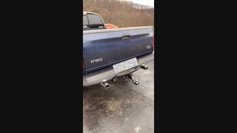

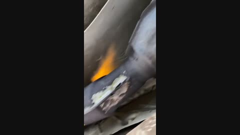

Sorry for the late response. Here is a video where you can really hear it.

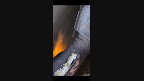

Here is another, it’s not as loud here.

Thanks for the video.
That is internal engine noise. It could be lifters or bearings.
I would suggest replacing the engine with either a used or rebuilt engine.
