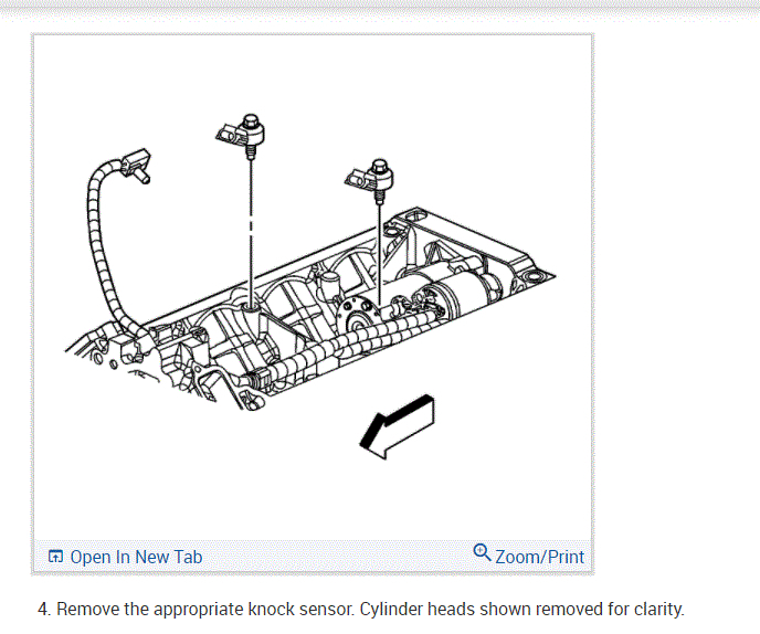

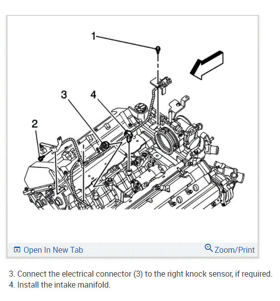

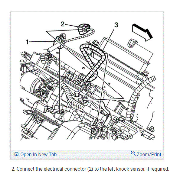

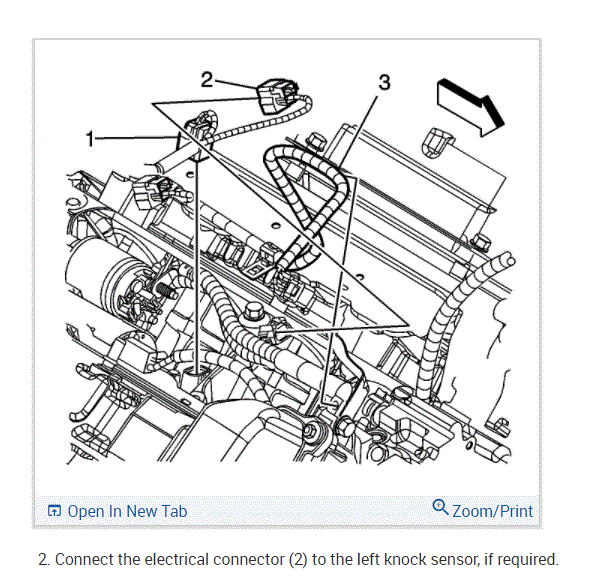

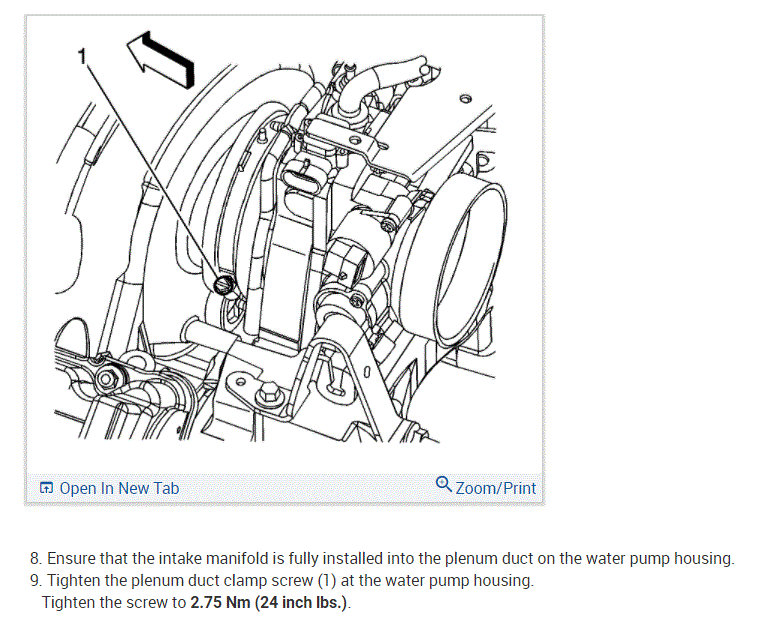

Cannot locate knock sensor. Car listed above a CXS model with a NorthStar engine.
Mar 22, 2021 at 6:49 AM
  • 110,241 POSTS

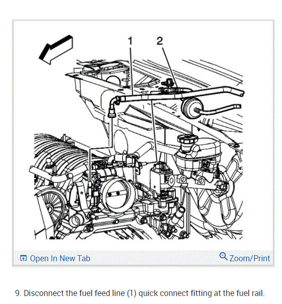

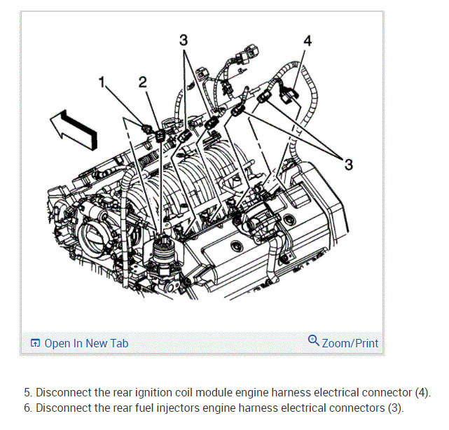

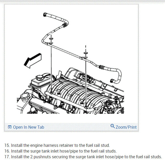

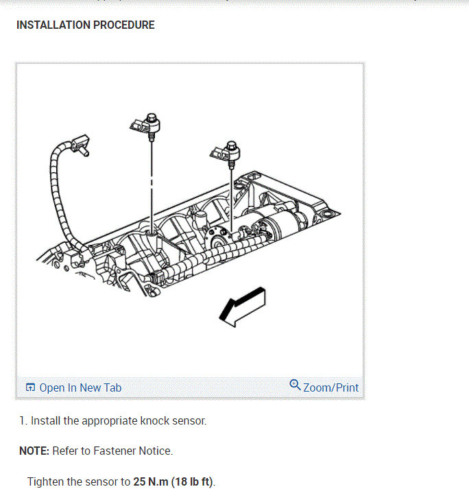

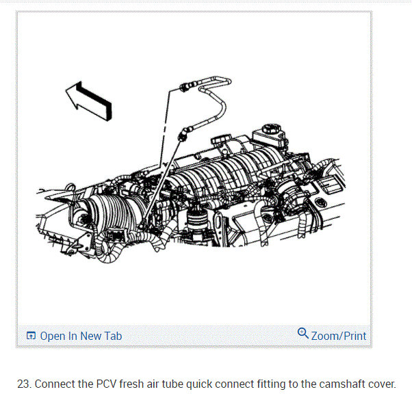

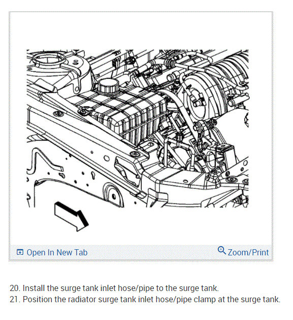

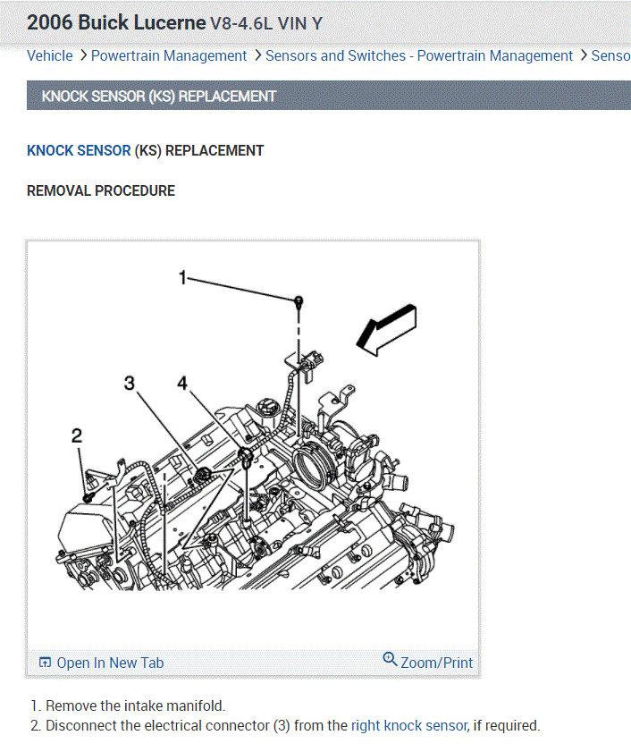

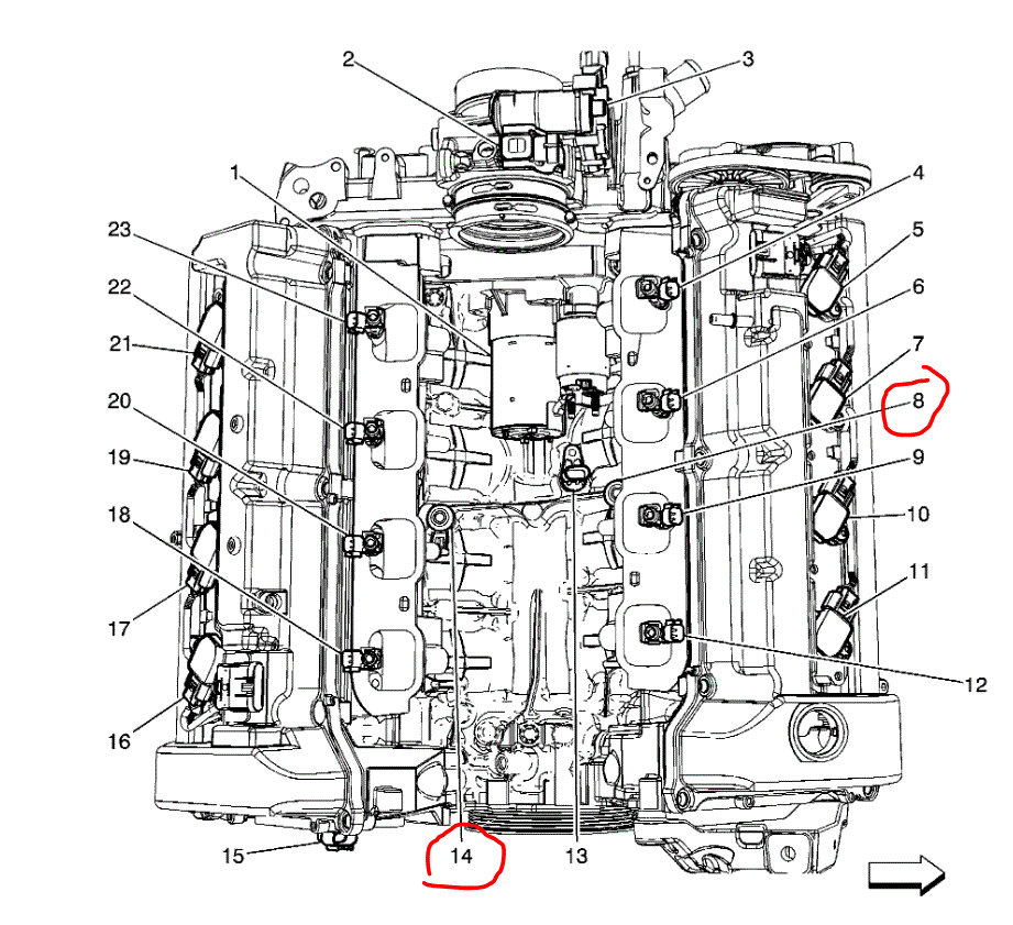

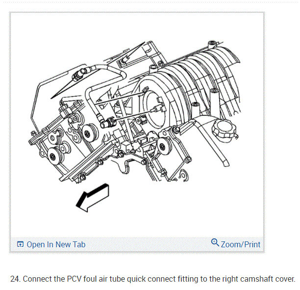

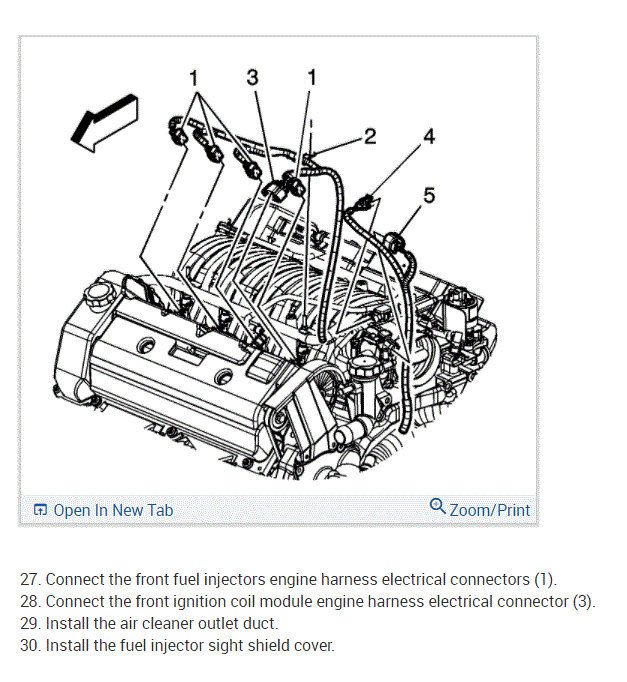

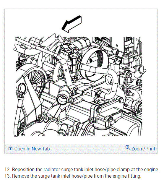

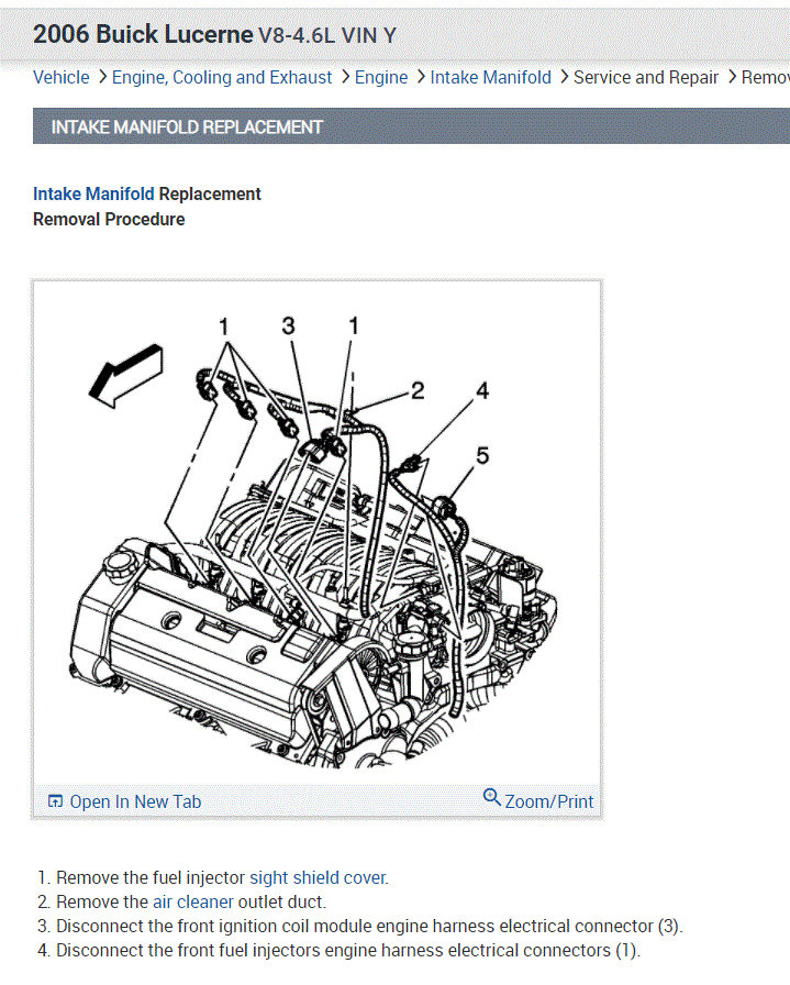

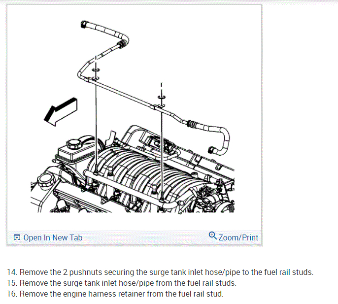

On this engine (4.6L V8) there are two knock sensors. Both are located under the intake manifold. If you look at pic 1, I circled both.

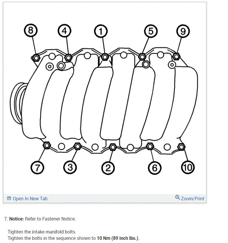

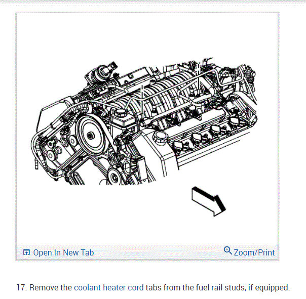

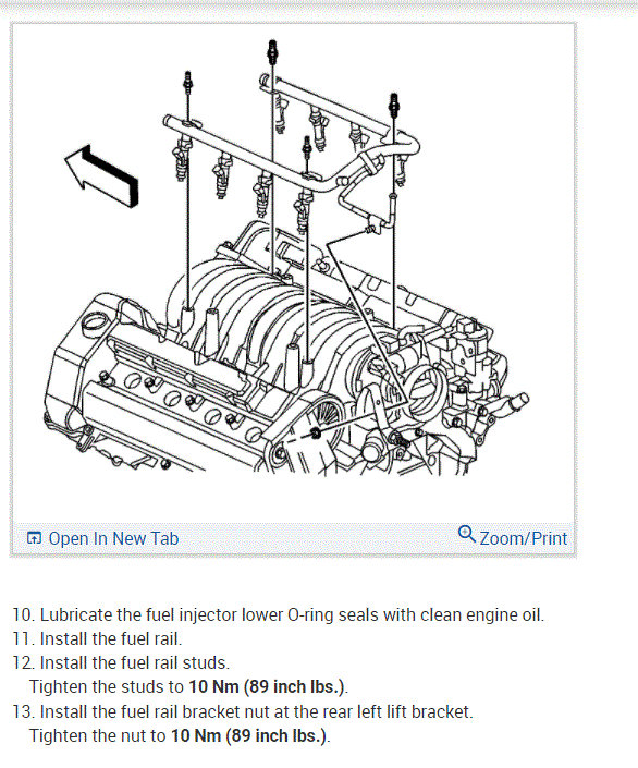

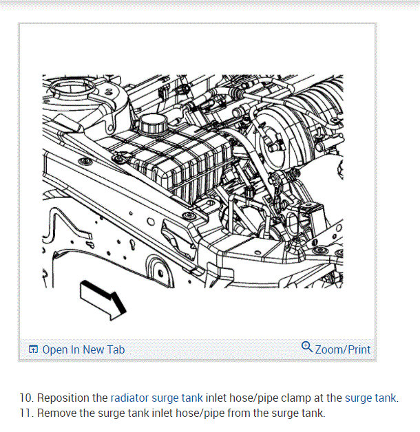

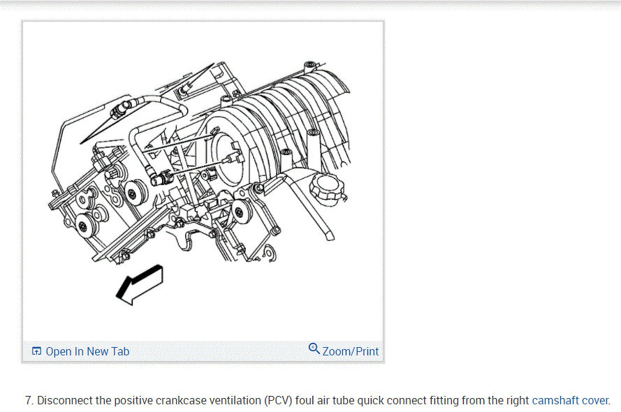

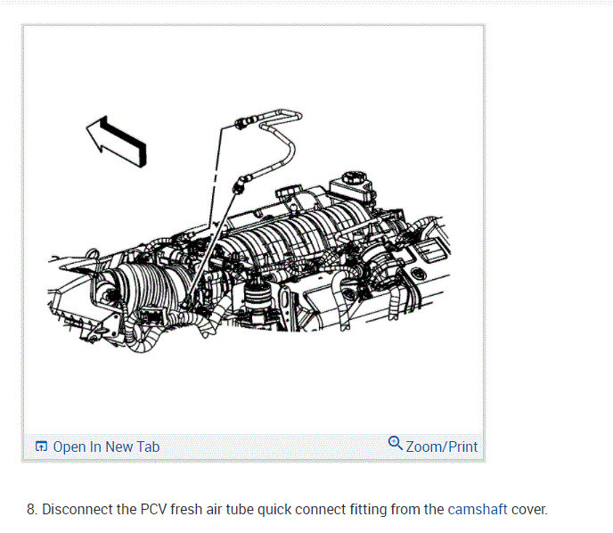

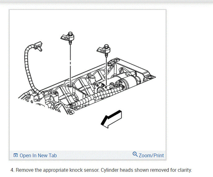

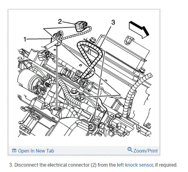

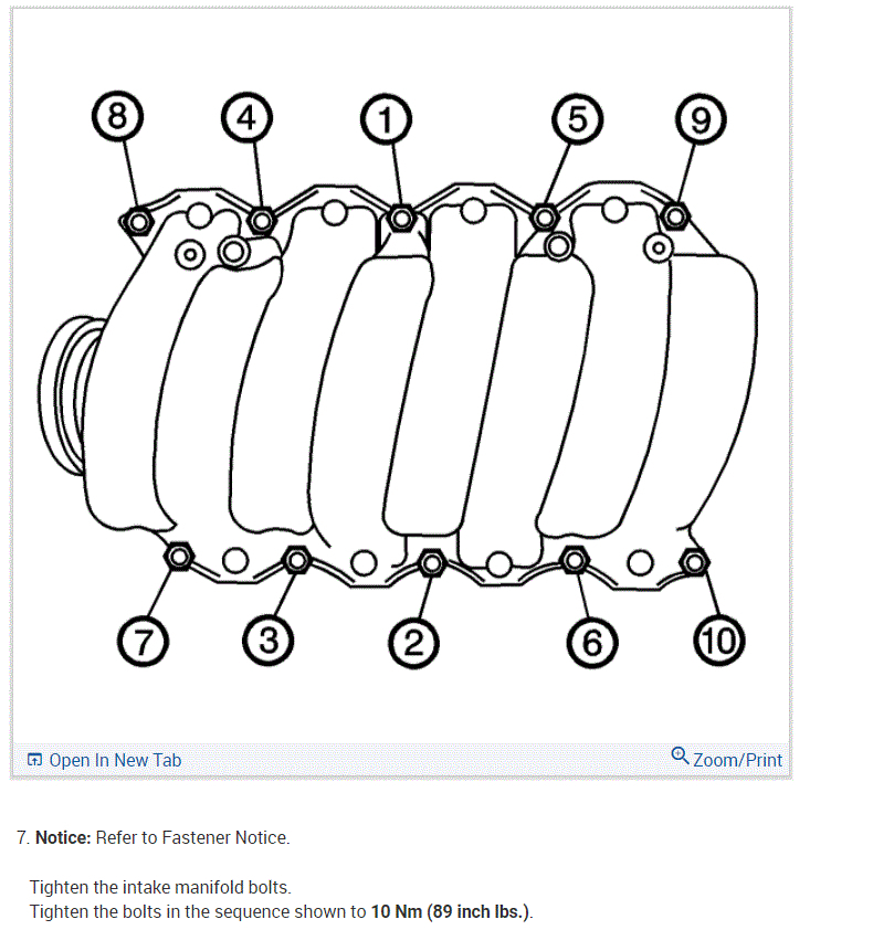

Starting with pic two, are the directions and pics related to removal and replacement of the sensors.

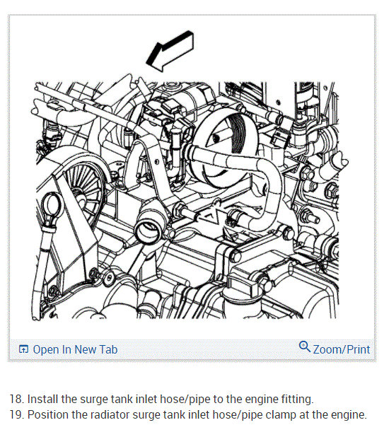

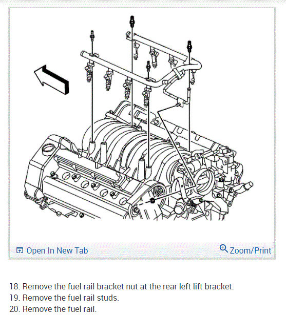

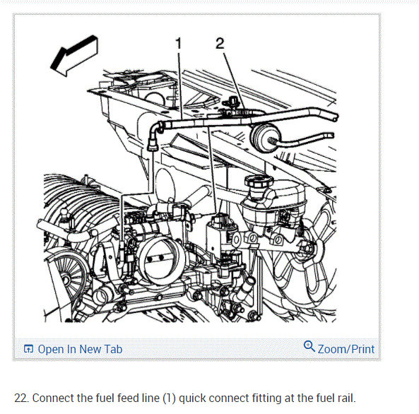

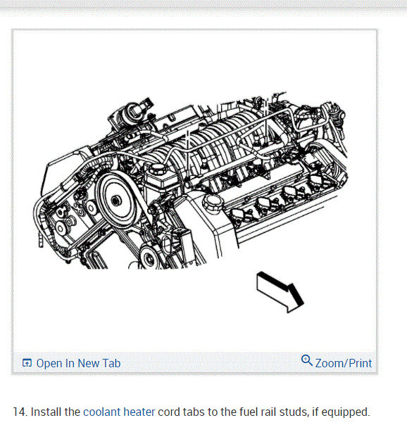

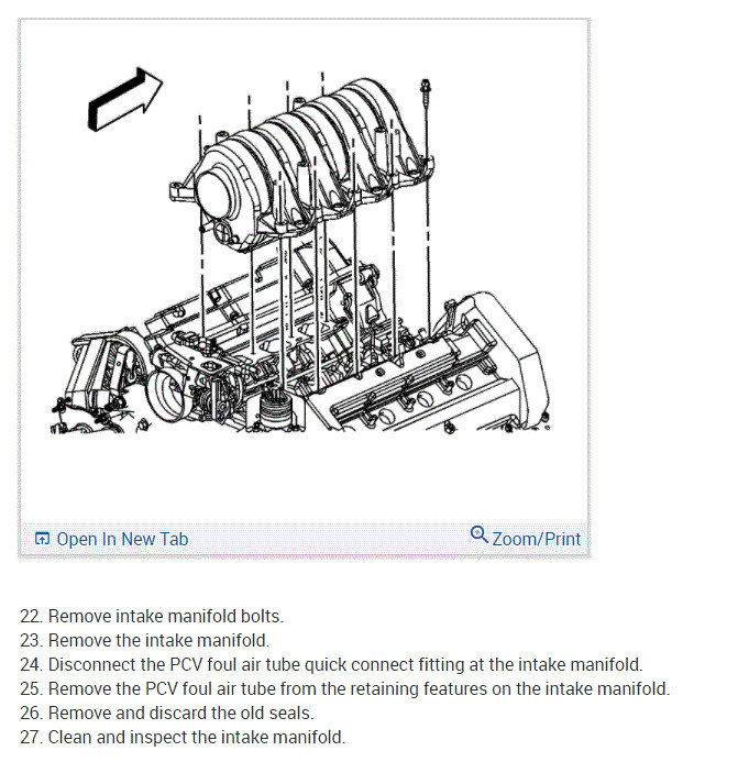

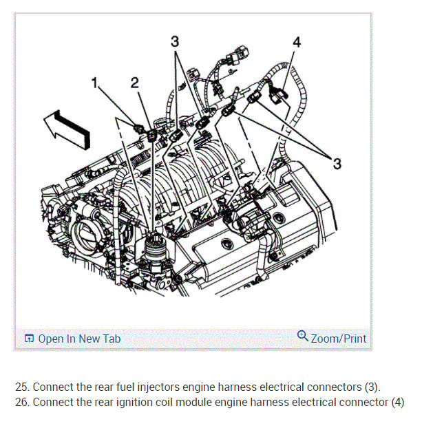

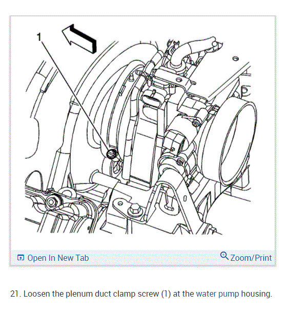

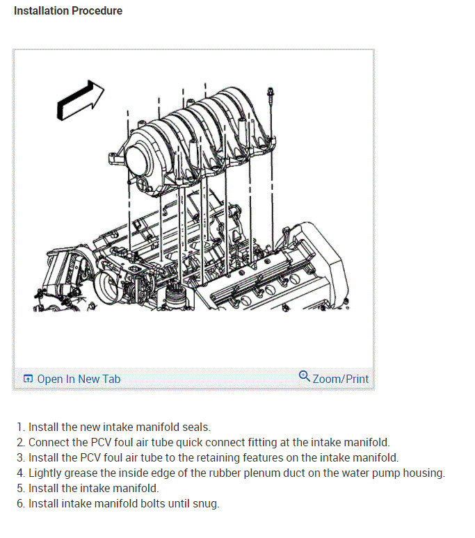

Starting at pic 8, I included the directions for removal and replacement of the intake manifold. It needs to be removed to access the sensors.

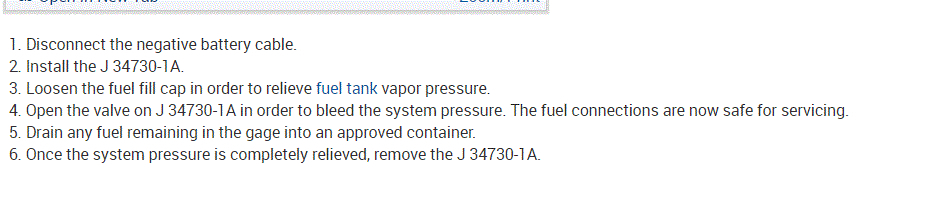

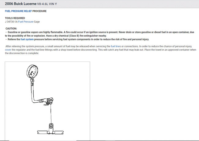

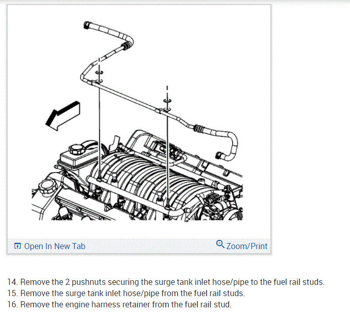

Thanks for the response. Just wanted to know if I need to release the fuel pressure before beginning this job.
Mar 26, 2021 at 3:04 AM
  • 110,241 POSTS
Since the injectors and fuel rail need to be removed, it should be done. If you look at the pics below, they include the directions for releasing pressure.
I hope this helps.
