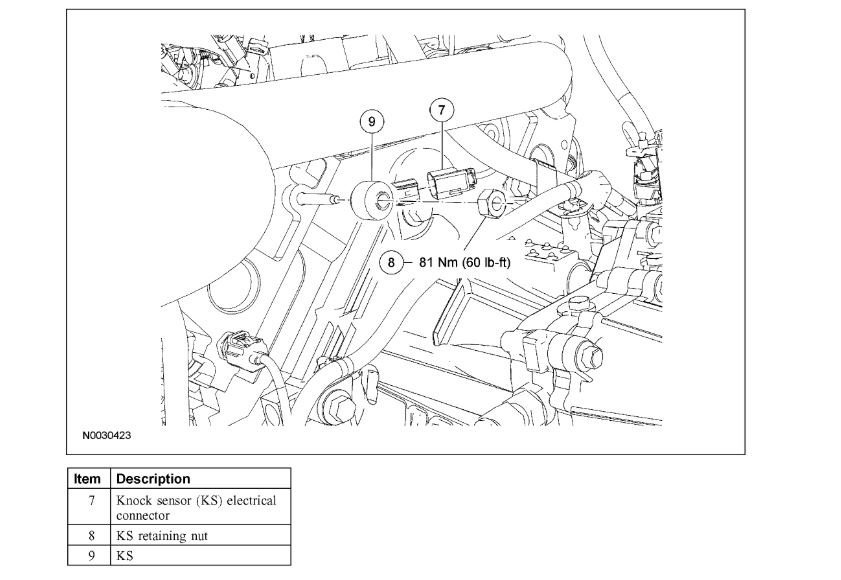

I would like to know where the knock sensor or sensors are located.
Sep 18, 2018 at 6:56 AM

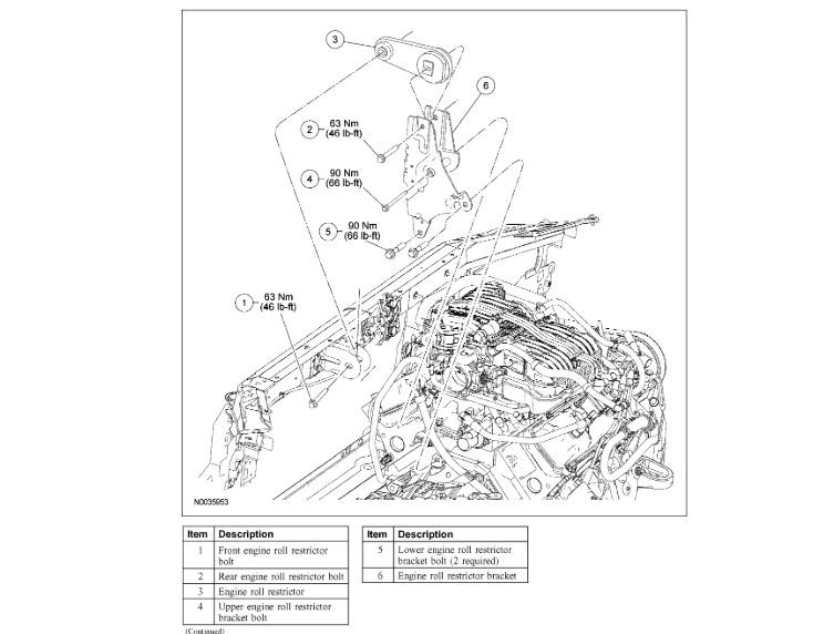

Procedure and location below:
Removal and Installation
1. Disconnect the battery ground cable.
2. Remove the air cleaner outlet pipe.
3. Remove the front and rear roll restrictor bolts and the roll restrictor.
- To install, tighten to 63 Nm (46 lb-ft).
4. Remove the upper and lower roll restrictor bolts and the roll restrictor bracket.
- To install, tighten to 90 Nm (66 lb-ft).
5. Disconnect the knock sensor (KS) electrical connector.
6. Remove the nut and the KS.
- To install, tighten to 20 Nm (15 lb-ft).
7. To install, reverse the removal procedure.
