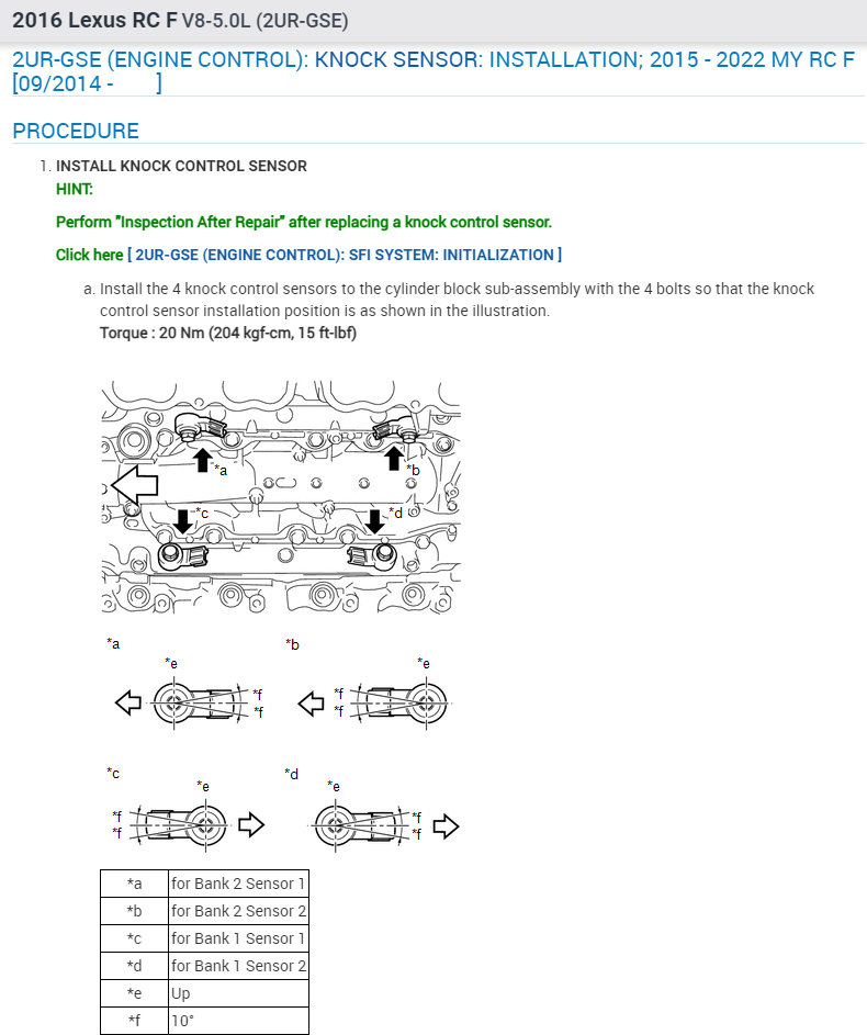

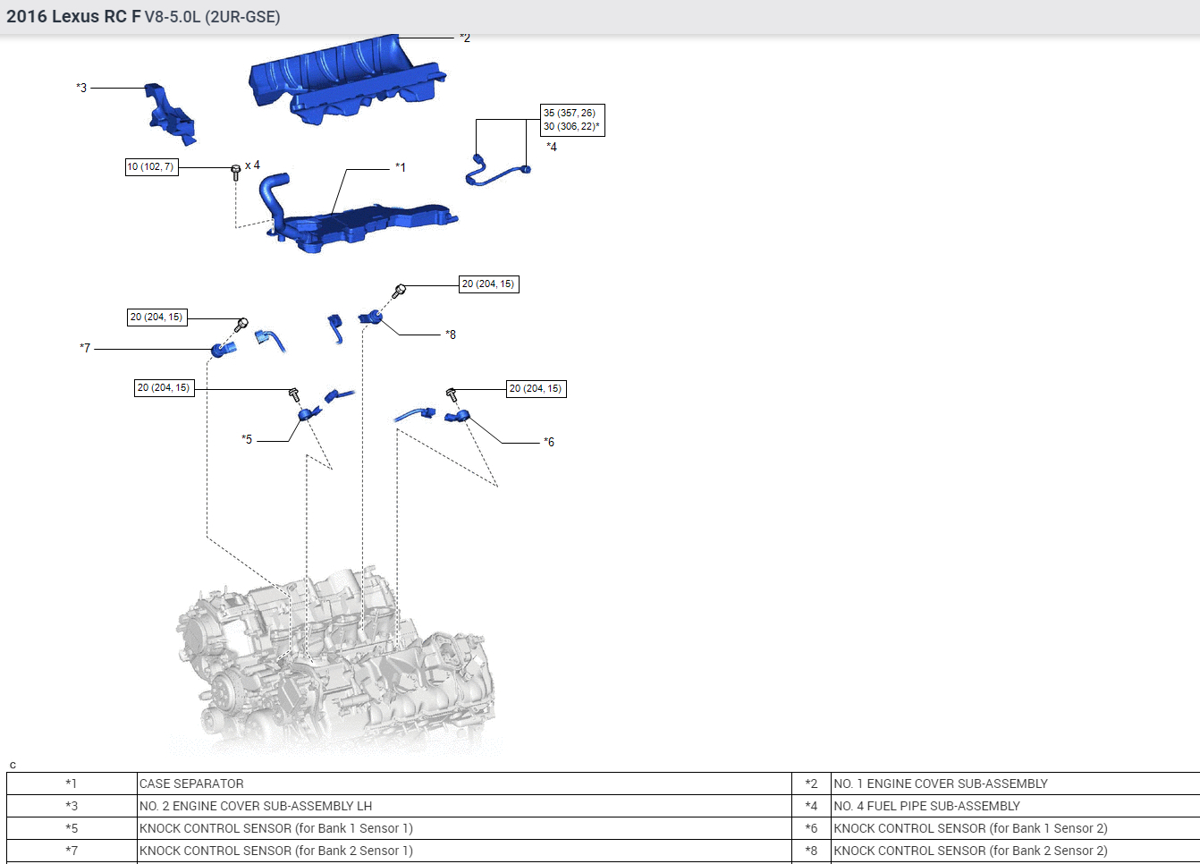

Knock sensor location needed.
Aug 28, 2022 at 3:23 AM
SQM
Experienced Mechanic
6,383 POSTS

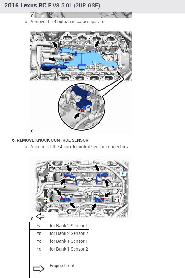

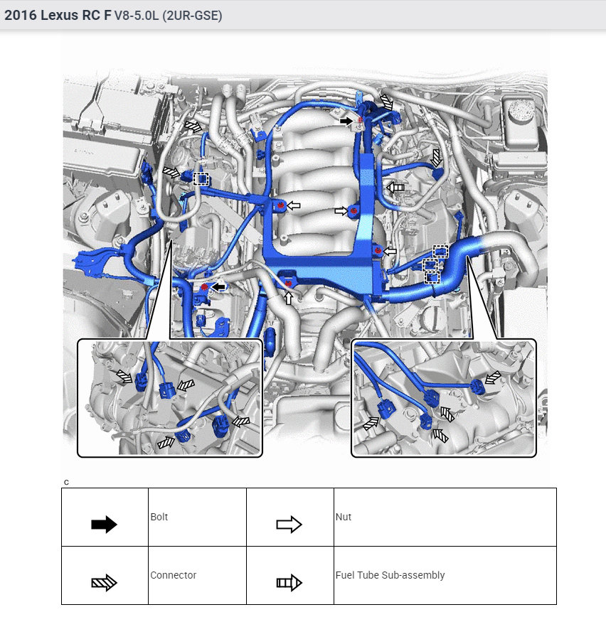

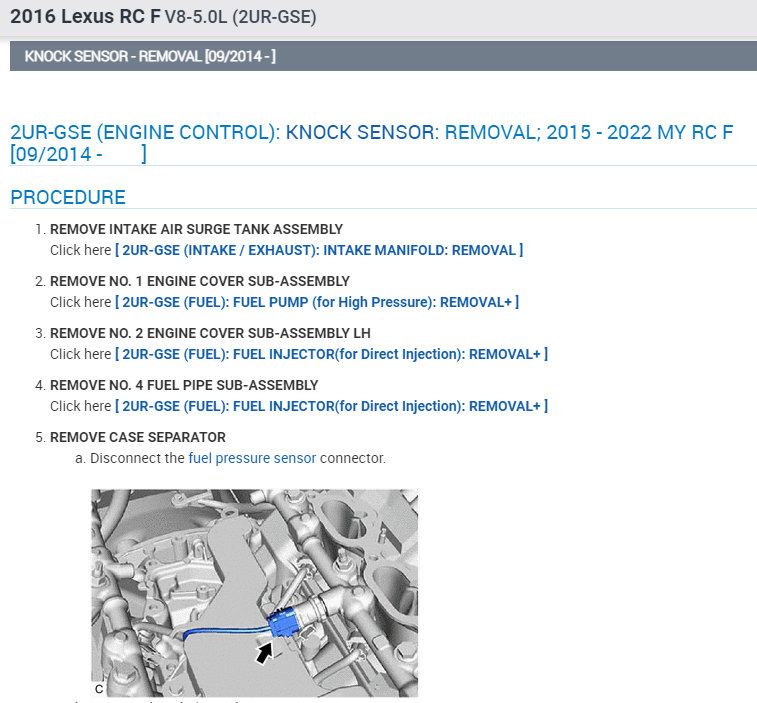

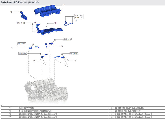

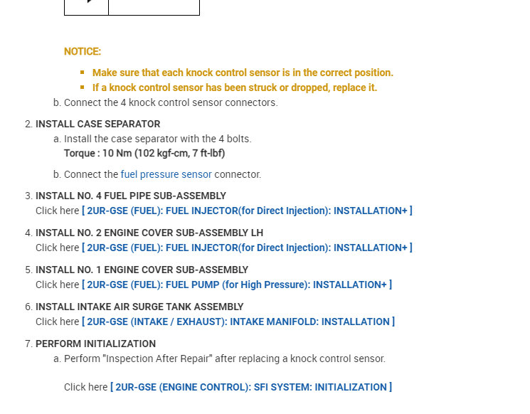

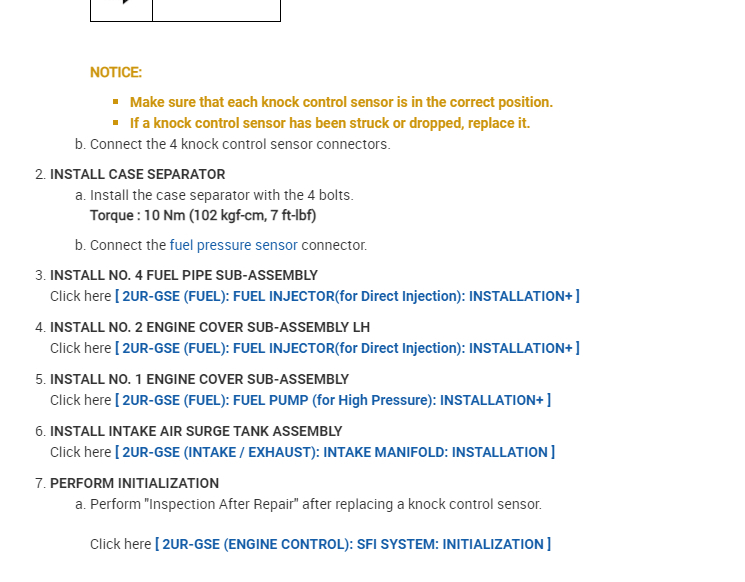

This vehicle has four knock sensors. They are located under the intake manifold. The manifold will have to be removed in order to access the sensor.
I have attached diagrams below for your reference.
Let me know of any questions.
