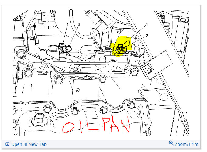

i was wondering where knock sensor 2 circuit bank to was located on my car listed above.
Mar 11, 2023 at 8:23 AM
N3TH6N
missed typed sorry but I’ve looked everywhere to find the location of the knock sensor 2 for my car, but i can’t find any videos on how to replace it nor been able to find the circuit bank 2 location for the car.
Mar 11, 2023 at 8:28 AM
  • 110,194 POSTS

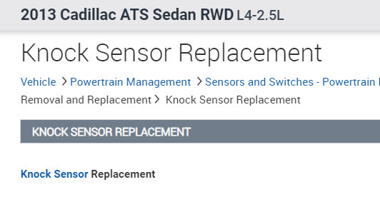

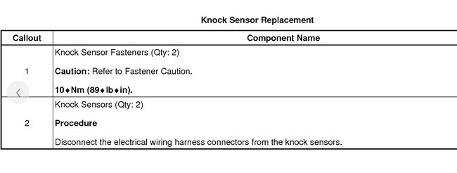

If you look at pic 2 below, I highlighted the sensor. They are mounted on the cylinder block. I highlighted sensor 2.
Also, in the pic I attached, you are looking up at the engine from below the engine oil pan. If you plan to replace one, I suggest doing both at the same time. Otherwise, you will likely be doing the other one in the not-too-far future.
Let me know if this helps or if you have questions. Also, if possible, I recommend getting a quality part. OEM is the best, but don't get something inexpensive from online. I have been seeing a lot of issues with the low-priced electrical sensors and components.
