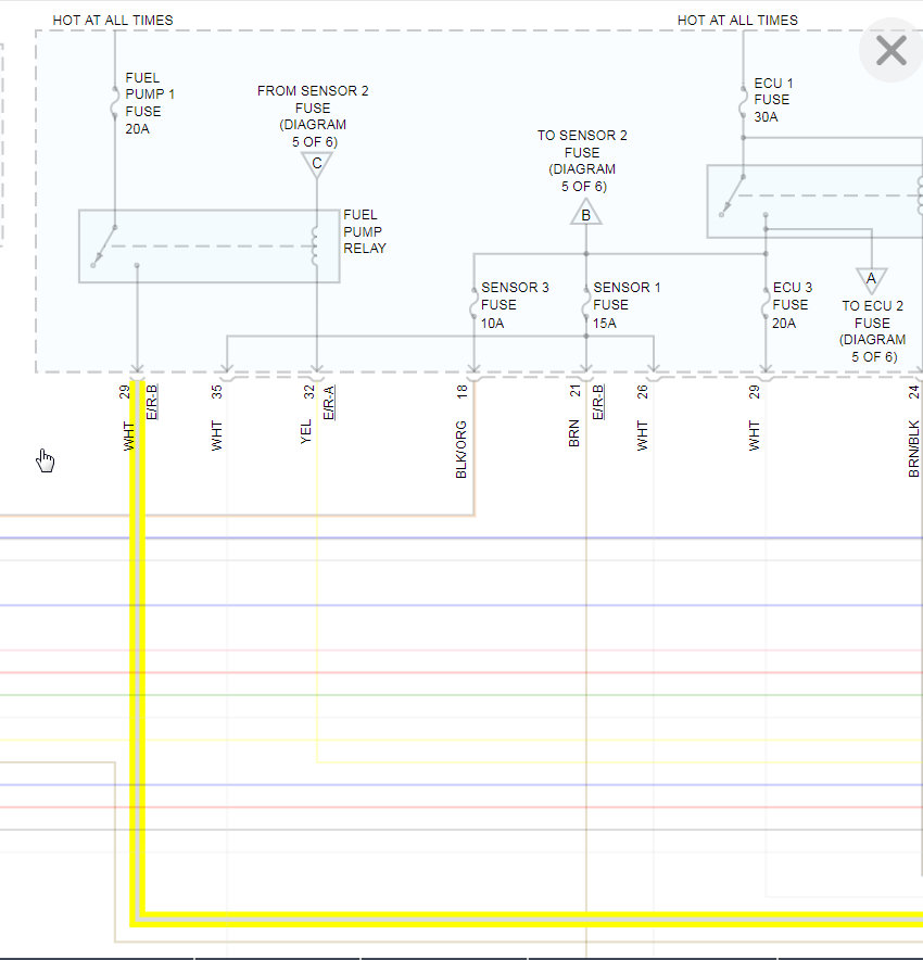

Good day.
How can i install a kill switch, either to the fuel pump relay or the ignition? Any help would be accepted.
May 6, 2020 at 5:45 AM

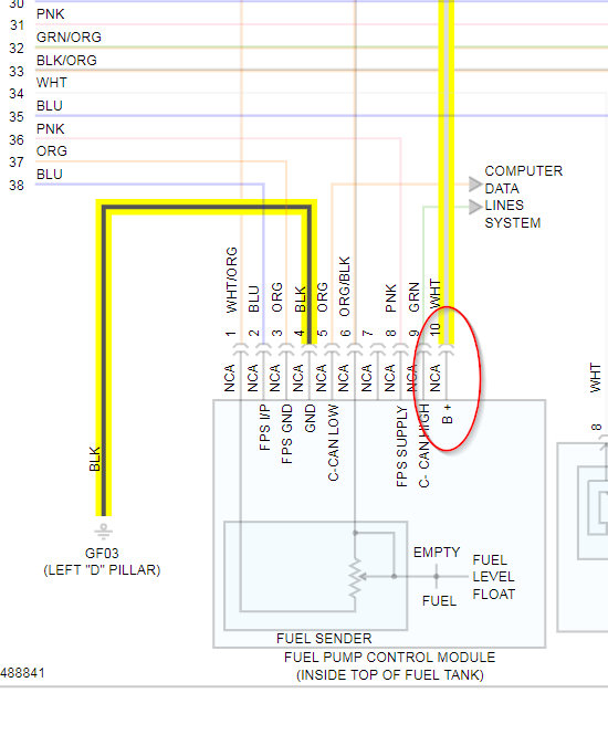

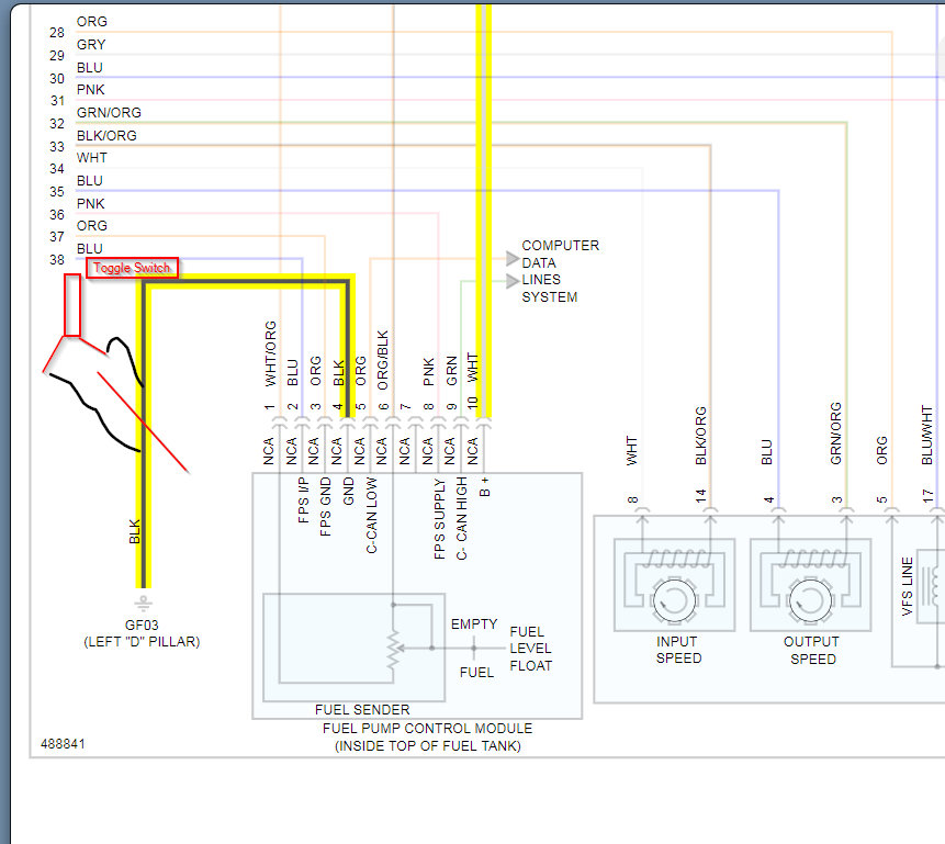

Any time you want to add a shut off switch to a component you need to interrupt the power supply or the ground.
I highlighted both wires. The way to do this is cut one of these wires and run a new wire for each side of the wire to a toggle switch. This way when you flip the switch on, it will complete the circuit but it will keep the circuit open when the switch is off. I diagrammed it on the last sheet using the ground wire but either wire will work.
Let me know if you have questions. Thanks

Kenny good day. obviously the wires are connected to the fuel pump .. can they be sourced further forward to make the splice? Or just remove the rear seat and trace it FWD?
May 7, 2020 at 11:14 PM
Good question. You can do it anywhere on that wire. Where ever is convenient to make the splice. Just make sure you are soldering and heat shrinking the connections so that you never have an issue.

Dear Kenny.
Good day/night or morning.
Hope all's well. Please to inform you that switch has been installed 6 days now. There are no issues. All seems to be working great.
The diagram was an excellent starting point.
Thanks again and be safe.
